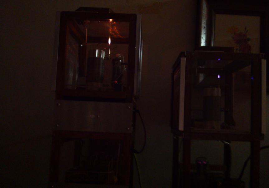

Mid Plasma 555 and Plasma Tweeter working together
Plasma Mid and Plasma Tweeter working together

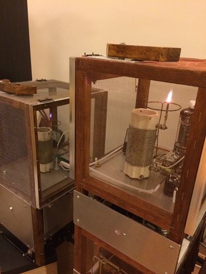

Hello.
Still anyone here ?
Want to build my own to.
Please have a look on my schematic :
They are two capacitors without value.
One for the power supply, one for the screen grid.
On many schematics they miss.
Are they a good option?
Frequency is 35 mhz
All the RF part will be schielded
Marc

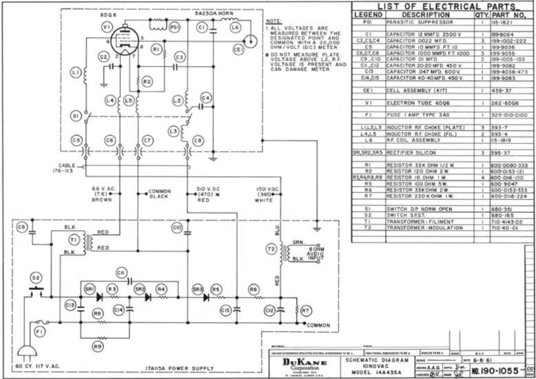

Thanks. Beautifully drawn. I can't say I know the theory. Is it amplitude modulation of a 35MHz carrier? Is there a modern variant like a Class D amp that is pulse modulated?
Drawing seems complex. Simpler today to have a clean IC RF oscillator, then a combiner/modulator, then driving a separate high-voltage driver? Each part could be adjusted separately.

Hello Bentoronto,
Thanks for reply.
You got diy plasma tweeter porn.
The IC solution seems to be too difficult for me.
And what i saw on the web is that IC speakers aren't good Hi-Fi quality.
Modulation and RF parts will work with tubes.
The schematic is the RF part.
Regards

Hello Lampie 519.Thanks for your reply and the schematic.
I see they are two coils who are In serie :L2 and L3.
Are they différent ?
Regards
Regards
No, these are the same. You can see that in the parts list. They are rf chokes. I used 100uH chokes in mine at the time. I still have them somewhere but i am not using them. Now i am using direct driven full range ESL’s. I would like to try some full range plasmas in the future.
