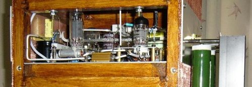

Please find a way to place a grounded SHIELD on the unit!!
nice lookin though...
WAIT! A close look at the pix - YOU DO have a GROUNDED SHIELD! Good work!!

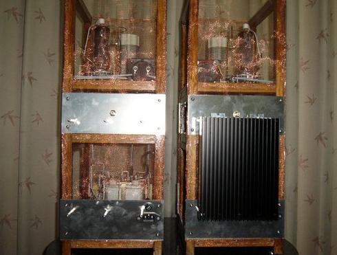

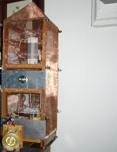

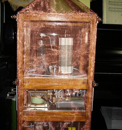

Hi Bear:
Yes,I shielding to Gnd already.
Separate to .... H-voltage power ,IF-modulation and RF-PA 3 parts.
If system don't shielding to gnd then L & R channel plasma tweeter will
interference ecah other cause system not work.

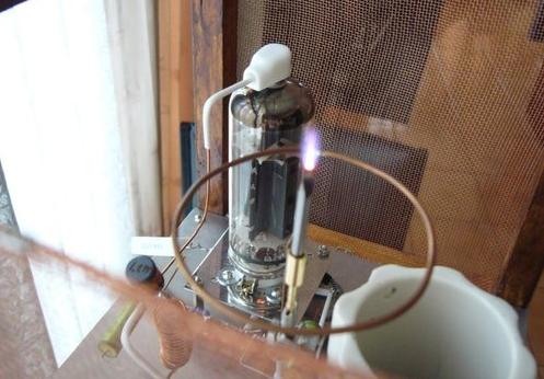

In my ionofone operating anode voltage of 600V is included after the heating filament lamps, but the plasma still does not light itself, which generating the lamp you are using and what the voltage on the second grid, if you do not complicate the scheme to send vogor@yandex.ru
Hi, Vogor:
My circut is standard without any improvment. The tube is PL519, most famours one. Ug2 70 - 80V will be enogh, otherwise may be distroy the tube.
The feedback loop is impotent, need to adjust finely.
Good luky.

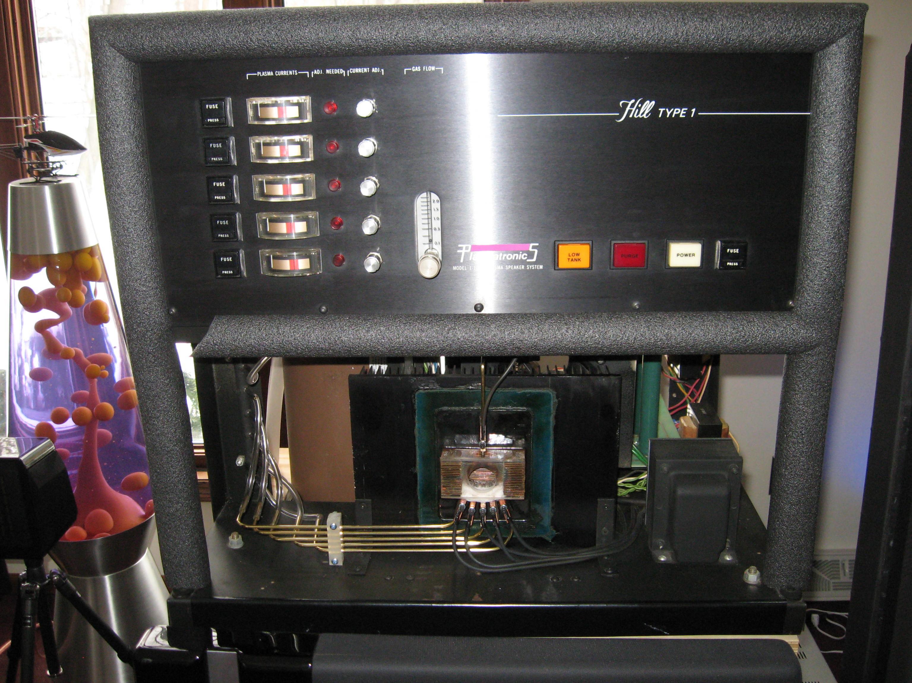

Hill Plasma
The Hill Plasma does make a very low hissing sound but not objectionable.

I've been with contact with an owner and he said it does not hiss (though his is modified). But not to take his word, in the prototype I built, there is no hiss either--and I'm even using much higher power levels.
Corona discharges are noisy. Arcs are noisy. Glow discharges are not. Maybe the version you heard had a noisy regulator on the helium tank or whatever, but if the discharge is making noise, that means something's wrong with the supply and/or amplifier.

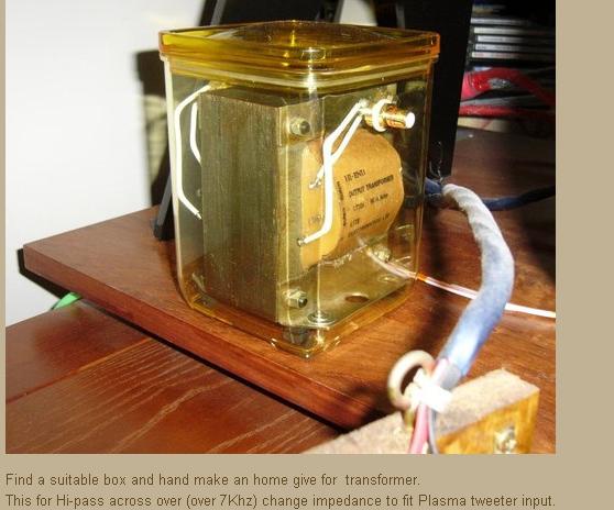

Hi:
In my DIY case the plasma tweeter is connect signal-in after tweeter out of crossover but need a transformer to change impedence.
This for Hi-pass across-over (over 7Khz) change impedance to fit Plasma tweeter input(High-Z).
Aster
Mr211's Blog - Yahoo!?????
