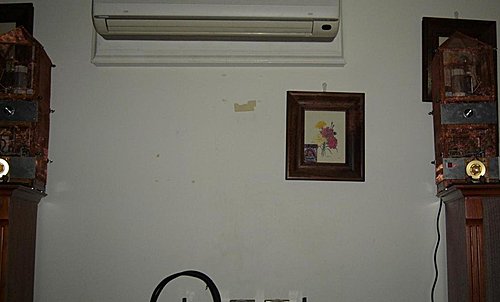

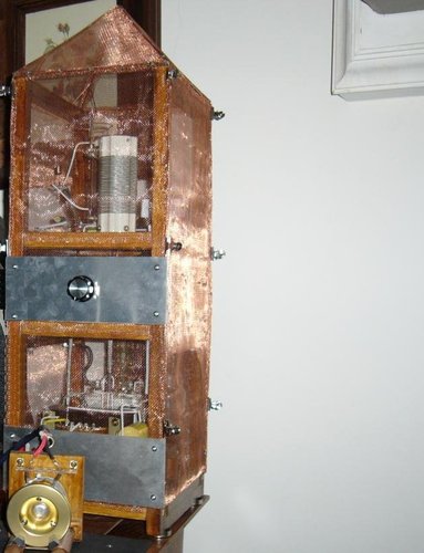

why do you take such high frequency?
Just follow my 3-way x-over frequency.
Woofer TAD1601 20~400Hz.
Mid Altec288B 400~7KHz.
Tweeter Jensen RP-302 over 7Khz.
Mr211's Blog - Yahoo!?????
Hello Okk:
Because my Jensen Rp-302 cross-over is 7Khz too and
I put a button could easy switching Jensen Rp-302 or plasma tweeter.
I see.

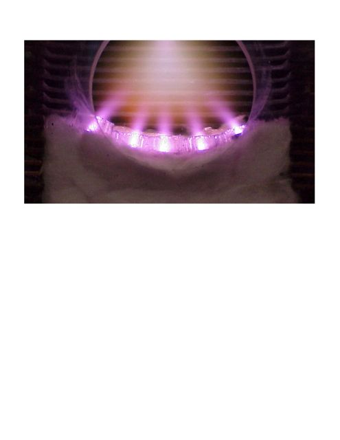

How much the single flame's sensitivity. Is it enough for match with Altec288B horn.
Altec288B L-pad to 97db for fit TAD 1601.
So Plasma tweeter close 97db too.(x-over impedance transfer have gain).
Plasma tweeter have a volume knob also could modify gain of over 7khz.
BTW My Diy analog EQ Linearizer could modify gain of over 7khz too.

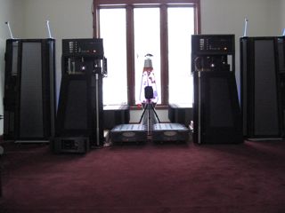

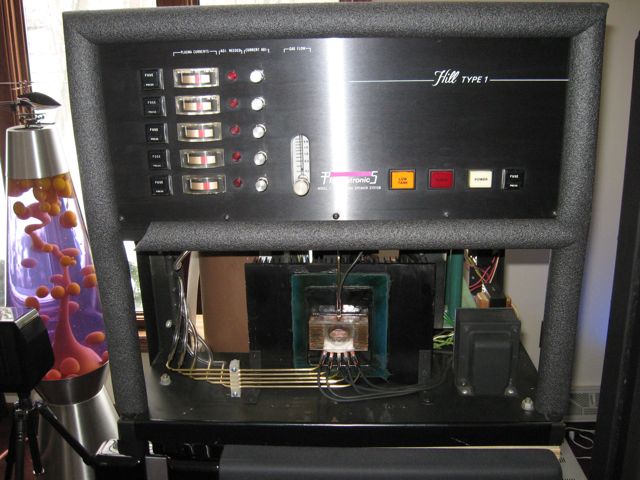

Plasma speakers are awesome!
Listening to a system with a plasma speaker is simply awesome.
My friends system utilizes a Hill Plasma that goes down to (700 hz)
in conjunction with Apogee ribbon speakers!
No ozone with this speaker as it utilizes helium which prevents ozone
from becoming an issue.

Hi Carlp:
You will see it happen asap.
After test Plasma midrange play sound @60 hz is ok.
