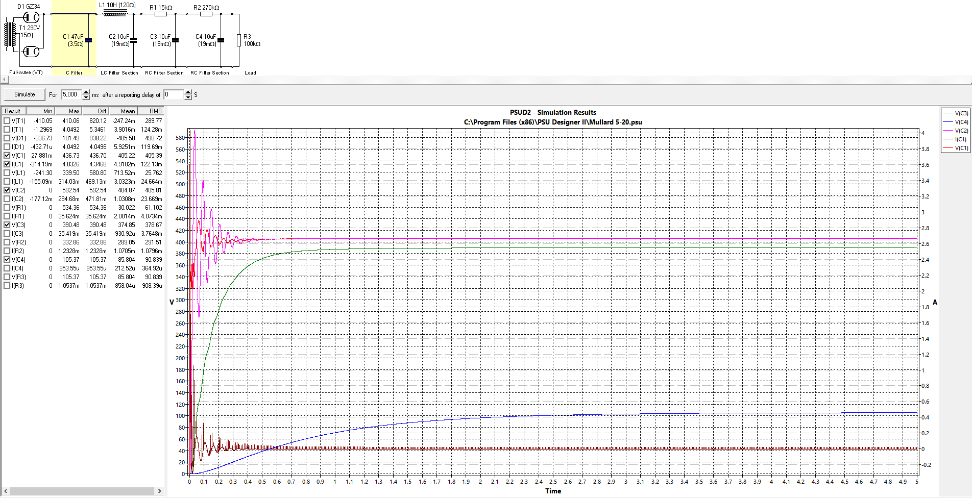

Having run some simulations for the power supply, I have some questions regarding the behaviour of a valve rectifier and inrush. The PSUD simulation shows a fairly hefty 4A spike right at switch on across the first capacitor. Does the valve essentially soften this due to it's slow starting nature?
Raising the Capacitance of the first capacitor has the effect of increasing the peak voltage seen on the second capacitor. 47uF in the C15 position (C1 in simulation) results in a spike of around 590V at the capacitor on C12. (C2 in simulation) Again, is this mitigated by the valve rectifier and not really a problem?
Lastly, is a 500V electrolytic capacitor at C15 adequately rated or should I aim for 600V? The simulation shows a peak of 436V.

A 500 V. rated part should be fine. Remember, the rating is for its working voltage. Provided it's not silly "tall", the part will withstand a brief, higher, turn on surge.
That suits me. I found an F&T 47uF 500V electrolytic which suits me perfectly as it's a decent size so I can utilise the mounting clips that I bought.A 500 V. rated part should be fine. Remember, the rating is for its working voltage. Provided it's not silly "tall", the part will withstand a brief, higher, turn on surge.
