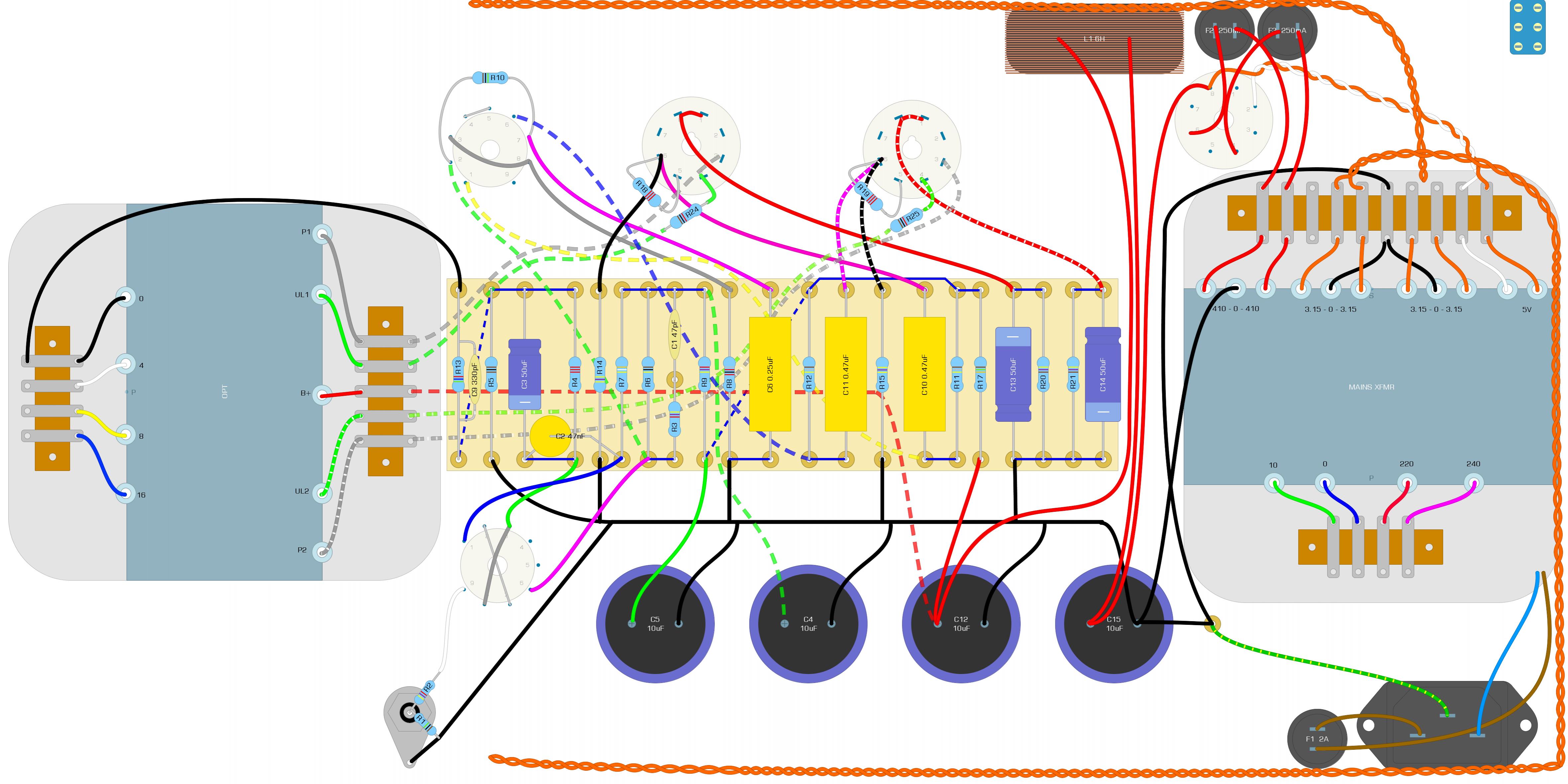

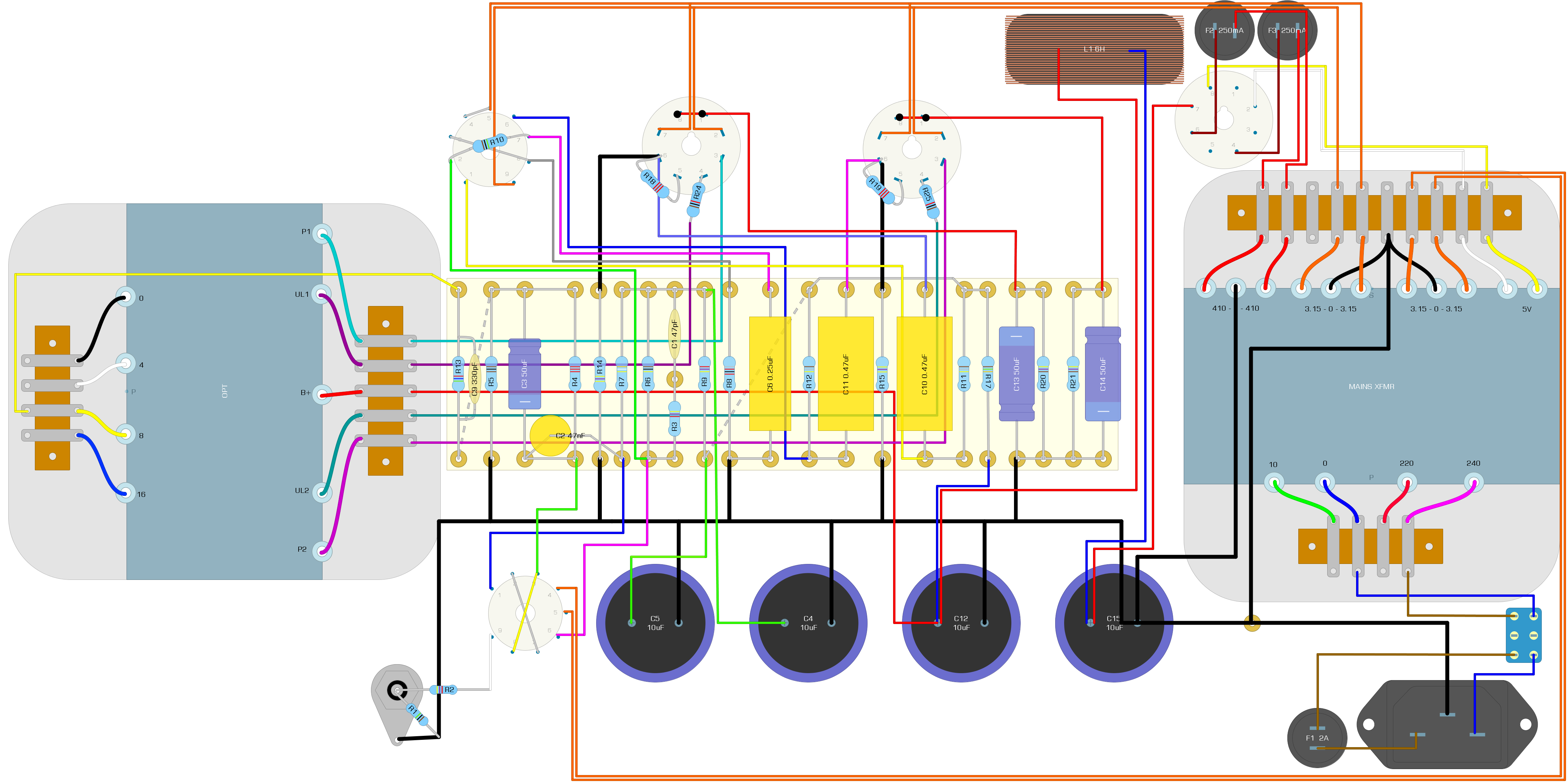

For now at least, I plan to stick with the original Mullard 5-20 design and only once I've got it working properly will I consider tweaking the design.
I've drawn up a diagram in DIYLC which hopefully is correct but errors may have slipped the net as I've had a few interruptions and have a cold on the way which never helps. Looks a bit like spaghetti but I'll try to wire it far neater than I can draw it on a pc.

First observation, R1 and R2 are not configured like that. R2 (4.7k) goes from input to pin 9. R1 (1M) goes from input to ground. Ground goes to input ground.
I would also redo the bus bar system to be more like 'star' ground. At least focus the HT centre tap to the negative of C15 and fan out from there...
And what is the grey thing top right, next to mains switch, with the heater pair going to it?

Good spot. I think I've also taken the feedback off the wrong secondary point on the OPT. The thing in the top right wired off the heater pair is supposed to be the "pilot light". I've tried to draw this following the original mullard design as best I can, which ironically, doesn't appear to use a star ground system.

...The thing in the top right wired off the heater pair is supposed to be the "pilot light". I've tried to draw this following the original mullard design as best I can, which ironically, doesn't appear to use a star ground system.
Yes, I should have realised... yes it will work fine as you/ Mullard have designed it, but the thing with the original design it was for a single mono amplifier. Then the safety standards of the time were not so stringent. Further the noise ratio was not so critical, you have to compare it to its contemporaries.
Again just my opinion, as you are building 2 mono-blocks for stereo, you should isolate the input sockets ground from the chassis. It is easy to get ground loop hum / noise with chassis based grounding using two amps the same.
The problem then is you loose the earth connection to the chassis. Not good.
The preferred way today to earth the chassis is to bolt the earth wire directly to the chassis close to the mains input - then take another connection from there to the bus bar / input socket connection. If you do get a ground loop then, you can 'ground lift' one of the wires, leaving both chassis earthed.
Its worth reading this by Valve Wizard http://www.valvewizard.co.uk/Grounding.pdf and have a look at Rod Elliott's site Elliott Sound Products - The Audio Pages (Main Index) .
Again in today's world, the HT ac centre tap goes to the first smoothing capacitor ground tag, then the second cap etc. to the bus. That keeps the charge pulses in the wire to a minimum. Likewise the two centre taps of the 6.3 volt windings should have individual wires to the point on the bus that the earth wire (above) goes to.
There are variations and other opinions, so best advice is build it as you see fit, but make sure you have plan 'Bs' and 'Cs' and leave the grounding options a little longer than you want. You can move them then / try other options to get the least noise. It is all part of the fun!

I've been redrawing some of the plans since yesterdays pointers. I've incorporated some of the grounding suggestions made above. I also rotated some of the sockets to better suit the wire entry points. Hopefully there are no errors on this one.
The R1 and R2 error persists.
You have left the bus bar floating. Take a wire from the earth point to the input connector ground tag.
Take the black wire from C15 straight to the 0 volt connection of the 410-0-410 tap. Give the two 0 volt 6.3 volt connections each their own wire either to the earth tag or to the bus bar where the black wire from C10 meets it.

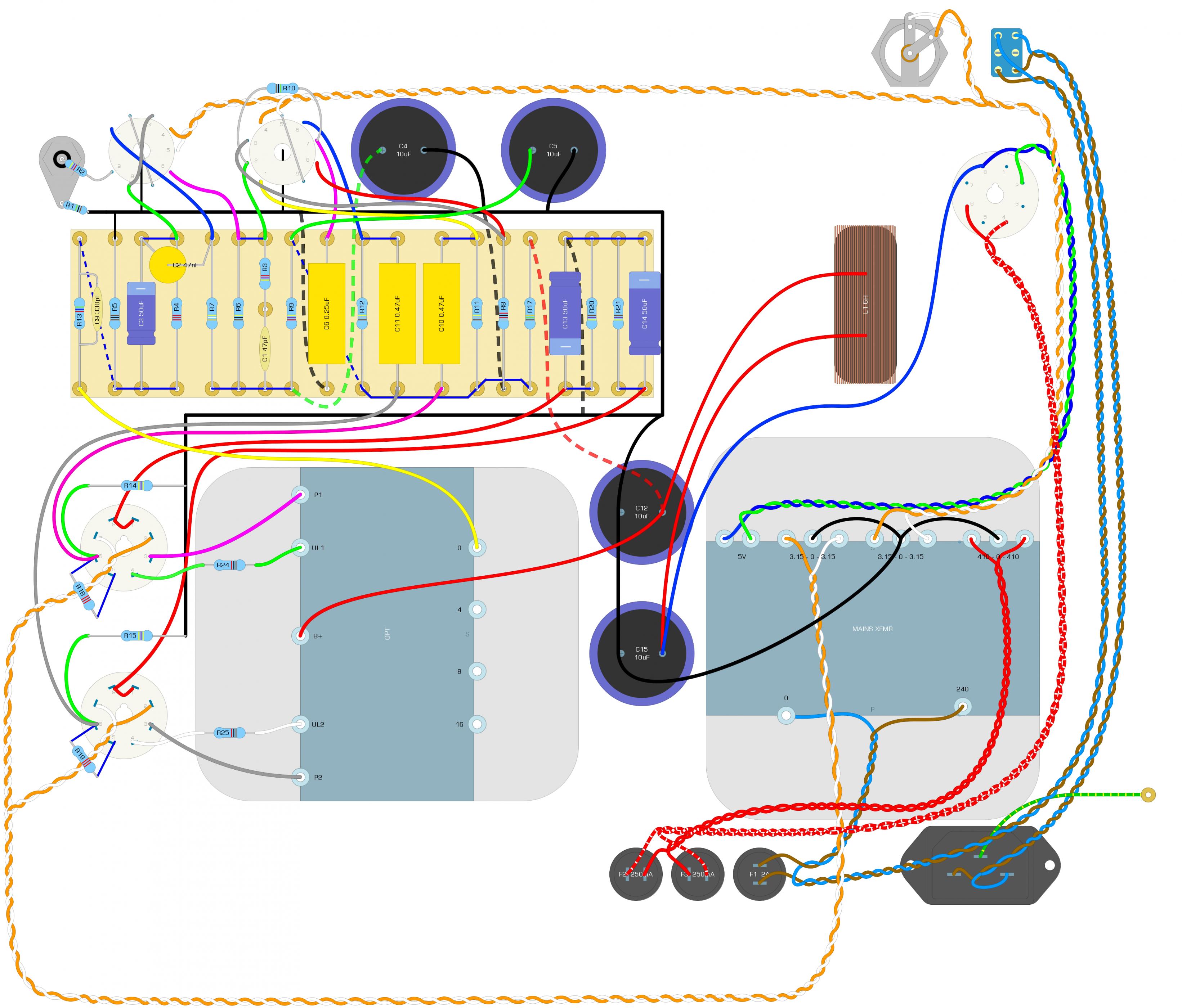

I’ve only just figured out my R1/R2 error. This cold has definitely taken its toll on me. I’ve completely redone the layout, basing it on the same fundamental design as the 5-10. A long, slim chassis with the transformers at opposite ends. IMO, it has allowed for simpler wiring routes. I’ve tried to implement your grounding in this new plan. I’ll post the new drawings up when I’m back on the pc and I’ve fixed that R1/R2 issue.

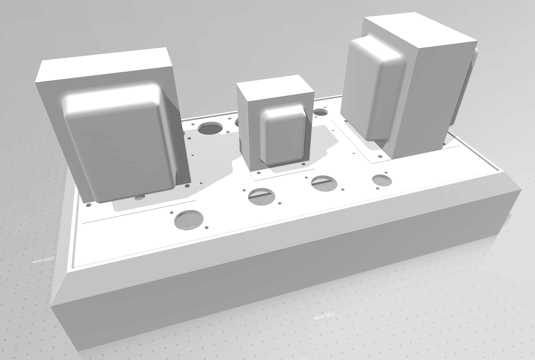

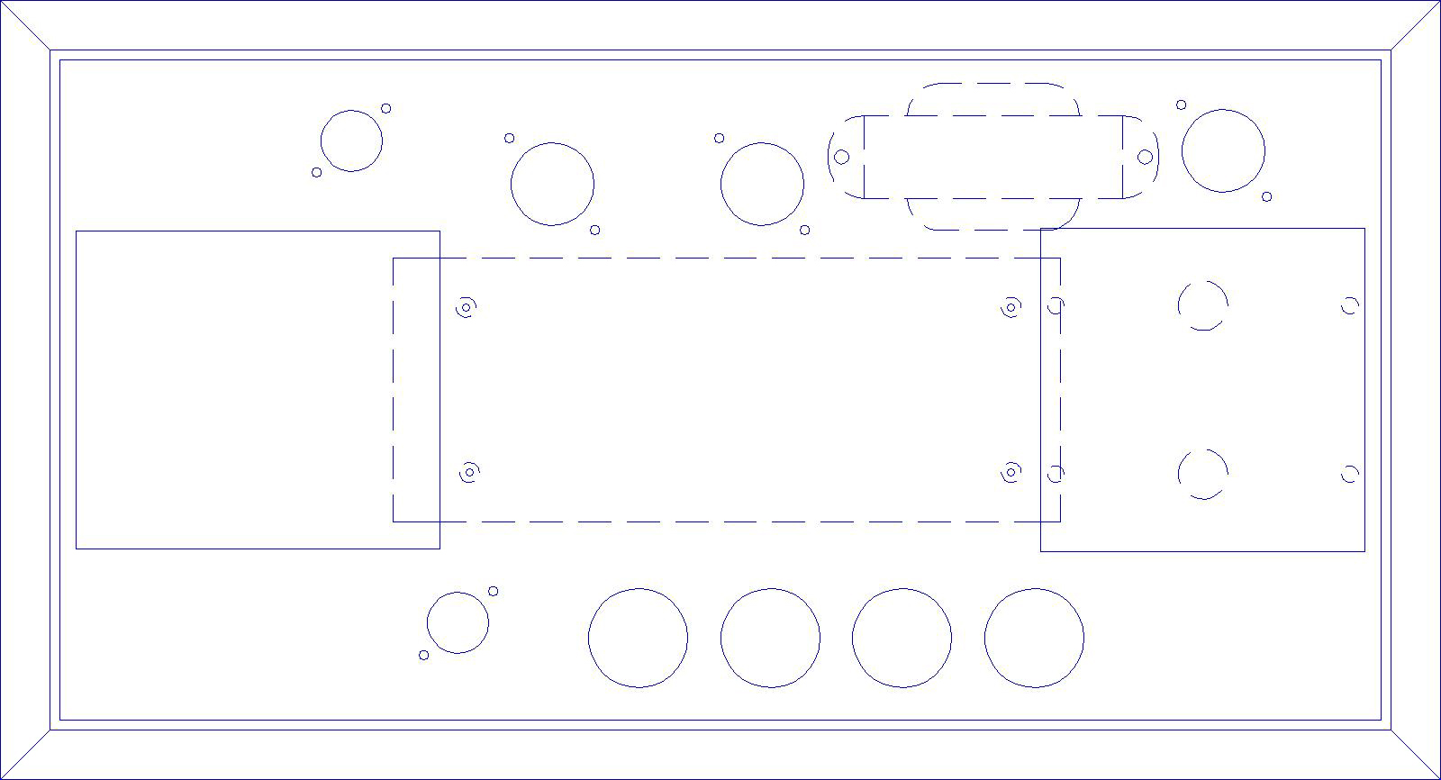

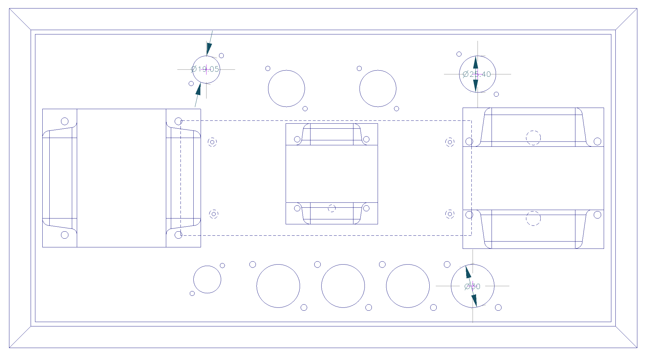

New drawing and the top plate design. I'm undecided whether to use the choke underneath as drawn or whether a shrouded version with feet like the other two transformers, situated in between the two transformers. The latter might be neater but the choke would be more expensive and sit directly above the turret board.
I've left the heater wiring and the mains wiring unfinished as working with wires in DIYLC once things get complex is tedious as it gets very slow. The wiring will run into the corners and directly to the valves. The wiring from the valves will run straight and parallel where possible, I just can't draw it like that in the software. I may try a hand drawn approach if the layout is considered sensible.

I've made my decision on the choke and gone with the stand mounted version that fits the specs perfectly. (10H 200mΩ 180mA) This will be mounted centrally between the HT and output transformers. The chassis is currently 400x200mm metal sheet with an 18mm thick wooden frame/base.

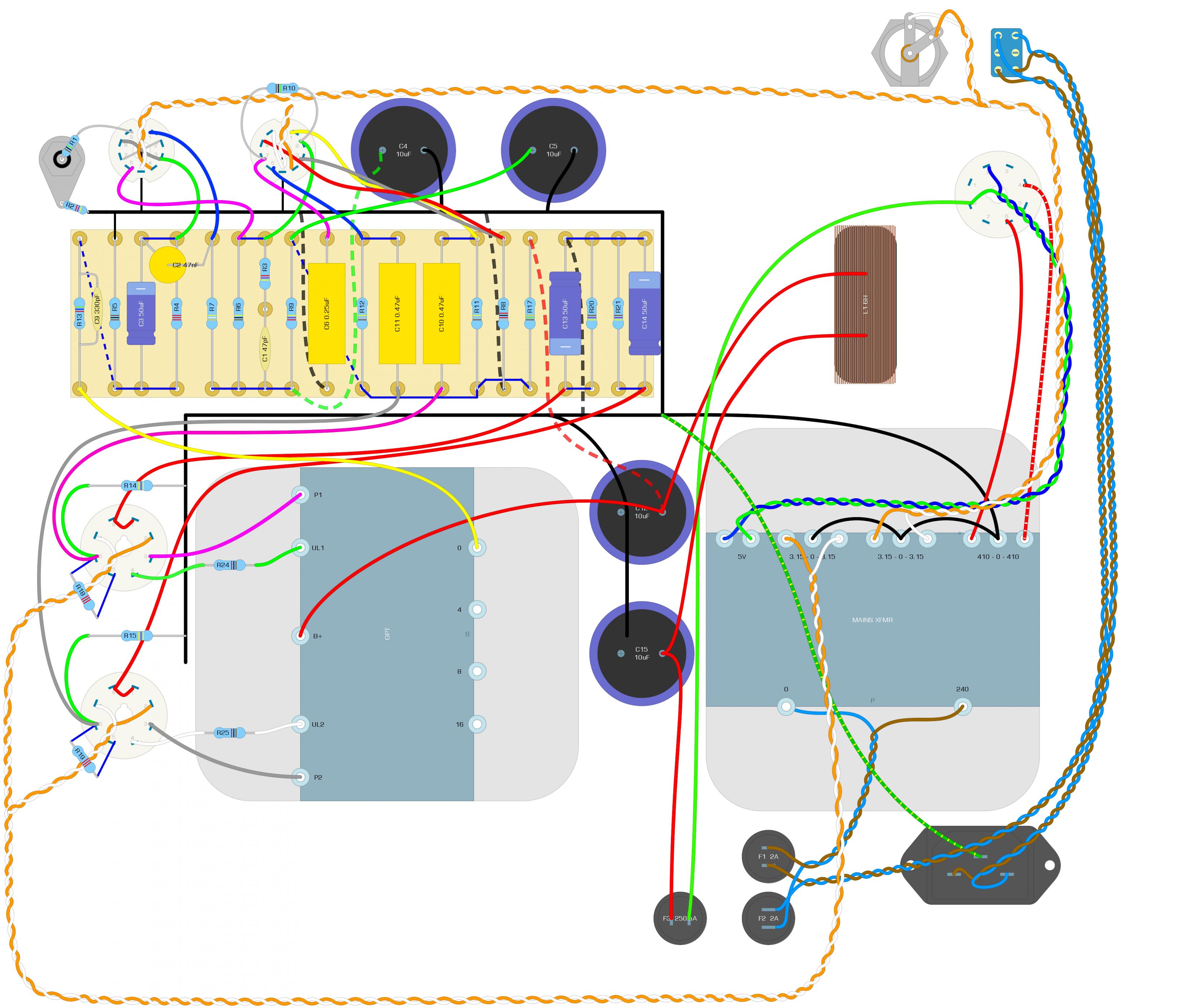

I've also redrawn the diagram using simple straight wiring to try and make it easier to read vs all the curly wires of the other diagrams I've done so far. It's still rather overwhelming but it's a bit easier to follow. The software is also much faster dealing with non curved wires which helps.

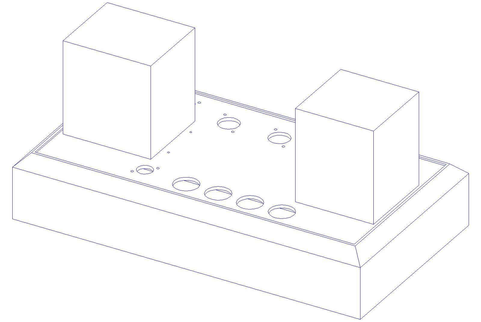

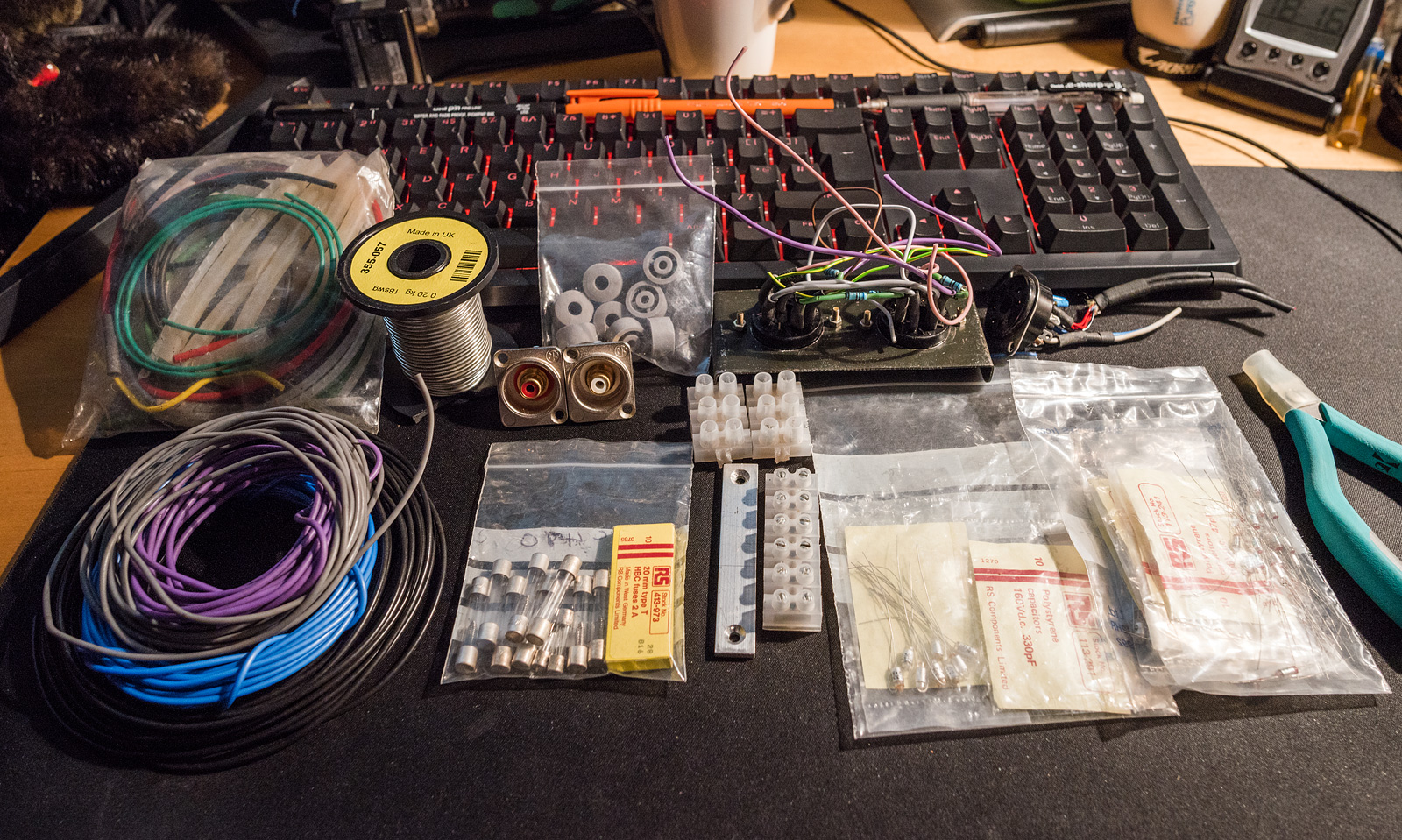

Further digging through my parts bin today found some more useful components for this project.
2 Neutrik phono sockets
4 more Octal sockets (also found 7 matching transformers with them)
Some TDC11 & TDC10 250mA 6.3x32mm fuses (depending on whether I need F or T type for the HT fuses)
Some 20mm 2A fuses in both T and F types.
Some 330pF 160V polystyrene capacitors for the feedback loop to use instead of the ceramics. I also found some 47pF parts but I believe 160V may not be sufficient
Some barrier strips
8 Rubber feet
A reel of 18 gauge tinned copper wire (pretty sure I have a reel of 16 gauge hidden elsewhere)
A selection of hookup wire
A selection of sleeving
