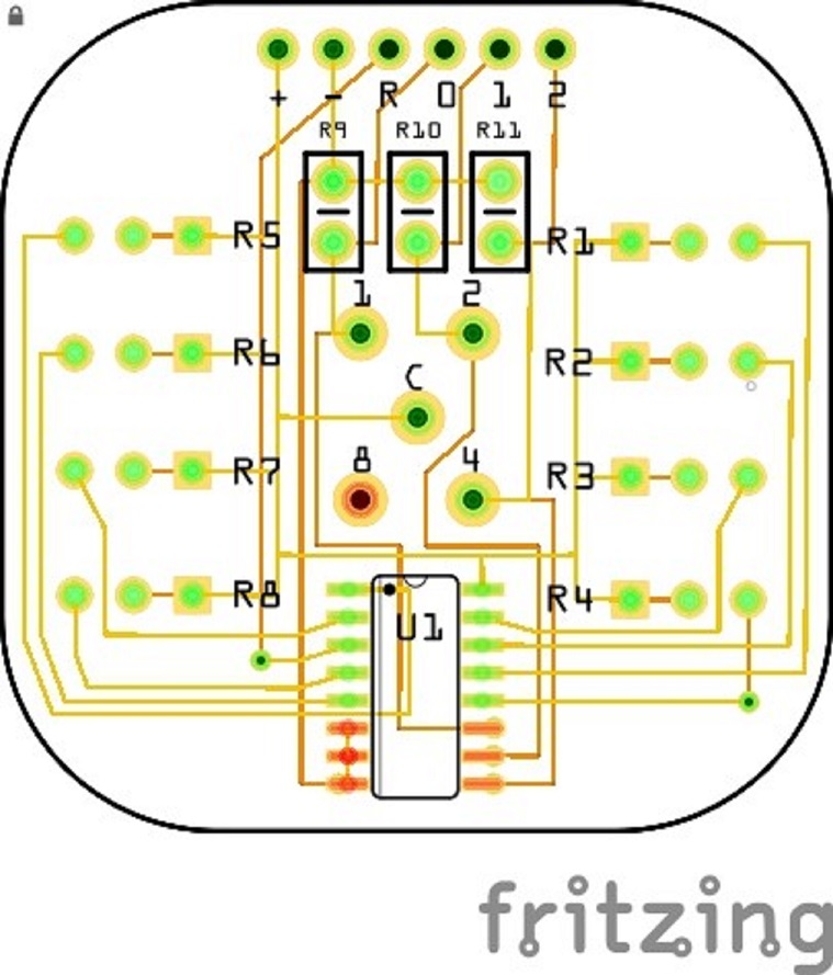

If your 'spaghetti' wiring becomes a headache, then consider a DIY circuit board. I've used Fritzing with success. It's free download entry level stuff, but fun to learn. Of particular importance is that Fritzing can export G codes- which, like dxf, are industry standard.
So you can export those to PC board house, there are some advertised here, that can produce your design. I've attached a screen shot of one of my Fritzing projects.
Jim

I'm avoiding PCB's in this thing deliberately if I can as it's far easier to modify down the road without them. I'll see how things are in a few weeks time when I review what top panel design I decide to go with if it all pans out properly. I've got a sneaking suspicion that I may be making more design tweaks as it does seem a tad snug, which probably won't bode well for noise performance.
Agreed,
Prototyping is experimental by nature. PC boards can clean things up after design is established- just an idea.
