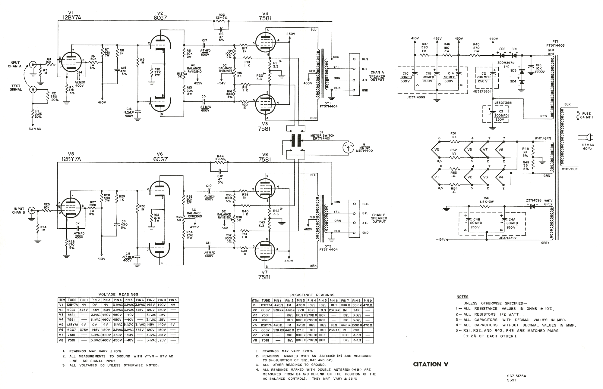

Given its "idiot resistant" nature, Mullard style circuitry is an excellent choice. However, keep in mind that Mullard intended the 5-20 to sell stuff they manufactured. The EF86 and ECC83/12AX7 are fine voltage amplifiers, but they exhibit low transconductance (gm), which can be problematic in circuits containing a GNFB loop. A superior implementation of Mullard style circuitry that employs high gm small signal types is the Harman/Kardon Citation V. You could "clone" the Cit. 5 and use inexpensive Russian 6Π3C-E (6p3s-e) [5881 equivalent] tubes to easily obtain the desired 30 WPC.
BTW, while the situation in Europe may be different, JJ's Octal production has been very inconsistent here in North America. I distrust JJ's Octals. To be fair, the situation with JJ's Noval (9 pin minature) stuff is definitely better.
P.S. You may find that line stage gain is unneeded, when a "standard" 2 VRMS CDP is the signal source.

Good shout on the Citation V. Having had a look on Hfe, there is a full assembly manual on there which is very helpful. Only thing that's not so easy to figure out are the transformers. I can see it appears to have what looks like a 400V secondary, a 6.3V heater secondary and a 60V secondary. There is no info I can find on the current ratings of the secondaries. For the output transformer, I have found references to using a primary resistance of 6600ohms but not much else. These niggles might require custom transformers to be made unless anyone knows of existing ones that fit the bill.

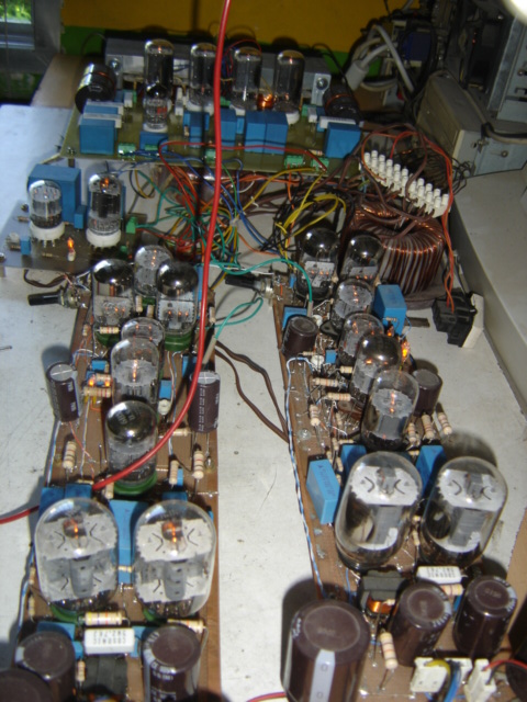

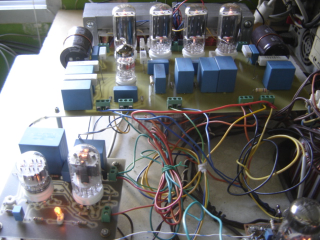

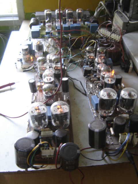

What about one like these? 22 Compactron DC coupled plus choke input filter and damper diode bridge? No one SS device at all? The final 6JN6's are in series and autotransformer coupled to the speaker(s). Aslo positive current feedback to reduce output impedance near zero ohms. Still unfinished.
The Cit. 5 B+ supply employs "full wave" voltage doubler topology. So, the RMS voltage of the B+ winding is much lower than 400 V.
6.6 Kohm primary O/P "iron" is easy to obtain. FWIW, the Cit. 5's OEM stuff uses a lower primary impedance to squeeze more power out of 7581s. However, your speakers will do just fine with the less powerful / less costly Russian 5881 equivalents. The 6L6 family of tubes has been in continuous production since RCA introduced the type in the 1930s. 80+ years and going strong.
Given their weight, magnetics are damned expensive to ship. Manufactured reasonably close to home makes sense. UK based Sowter makes a quality product. Their model U069 O/P trafo will be fine. Magnetic headroom is essential in a design that incorporates a GNFB loop. That headroom avoids core saturation caused by the deep bass error correction signal. A transformer with a saturating core sounds truly horrid.
The Cit. 5 employs full pentode mode "finals". Open loop linearity in full pentode mode is maximized, when screen grid (g2) B+ is regulated at a % of anode B+. Do something to stabilize g2 B+ beyond the simple RC decoupling employed by H/K. Jim McShane, a Citation "guru" and all around very nice guy, uses a choke.

The photofacts data says Pri = 117V 2.1A, Sec 1 = 200V 1.2A, Sec 2 = 6.3V 6.3A, Sec 3 = 60V 0.02A. Those figures would suit a transformer that would be used for the original stereo design. My plan is to build mono blocks so one transformer per unit so approximately half the current rating would make sense and obviously I'd need a primary that suits our local 240V 50Hz UK supply.
I guess the Citation V's PI stage's performance could even be improved by increasing the tail resistor to 39 kOhms and returning it to the -54Vdc rail instead of GND.

Or replace the tail resistor with a CCS, IXYS 10M45S.
But I agree the Cit 5 is a nice circuit.
Not 100% sure there couldn't be a better choice than the 12BY7 in front though
Changing the LTP tail load to a 10M45S is a good idea. It may be necessary to add a small negative rail, to ensure "compliance".
The high gm theme can be carried further by using an ECC99, instead of a 6CG7, as the LTP.

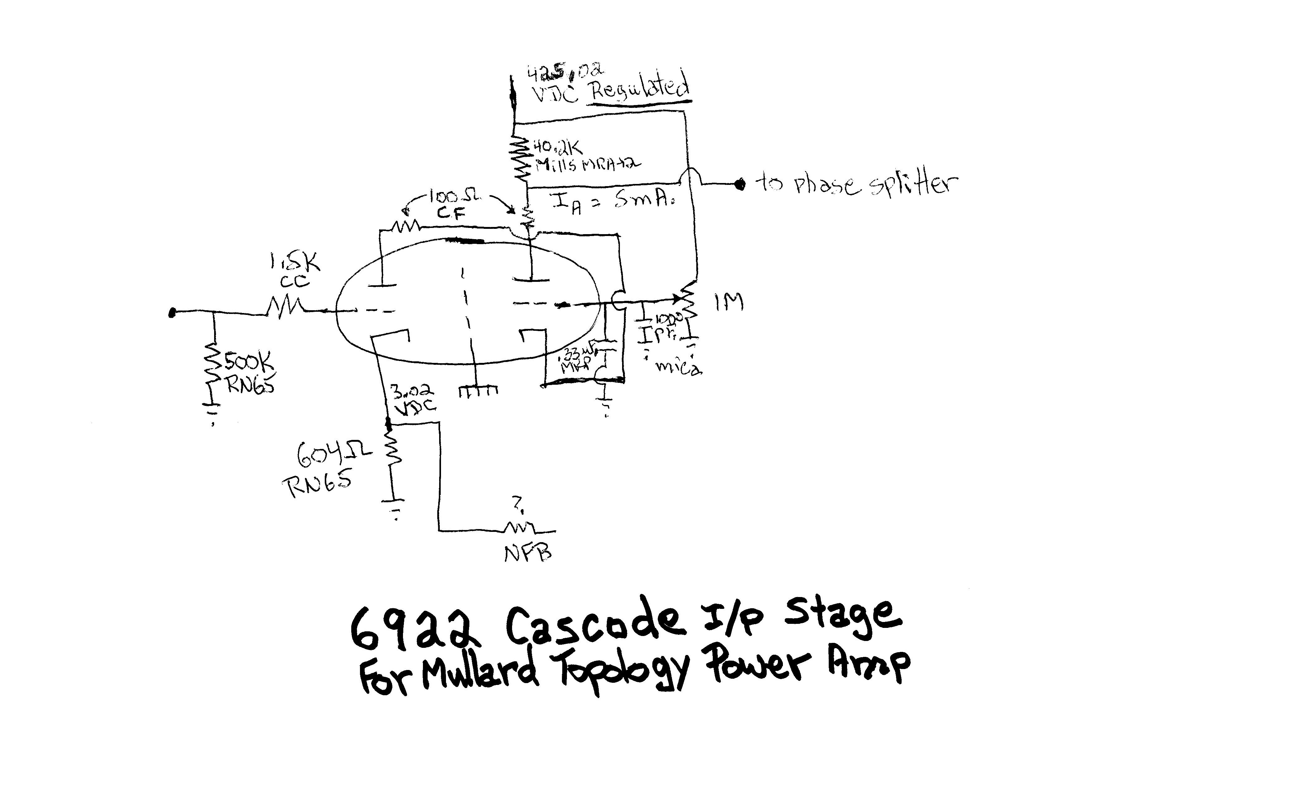

It's very hard to argue with anything Stu Hegeman did. The big issue (IMO) with the 12BY7 is ever increasing scarcity. I'm providing a cascode replacement for the 12BY7 pentode voltage amplifier, that employs the in production 6922.

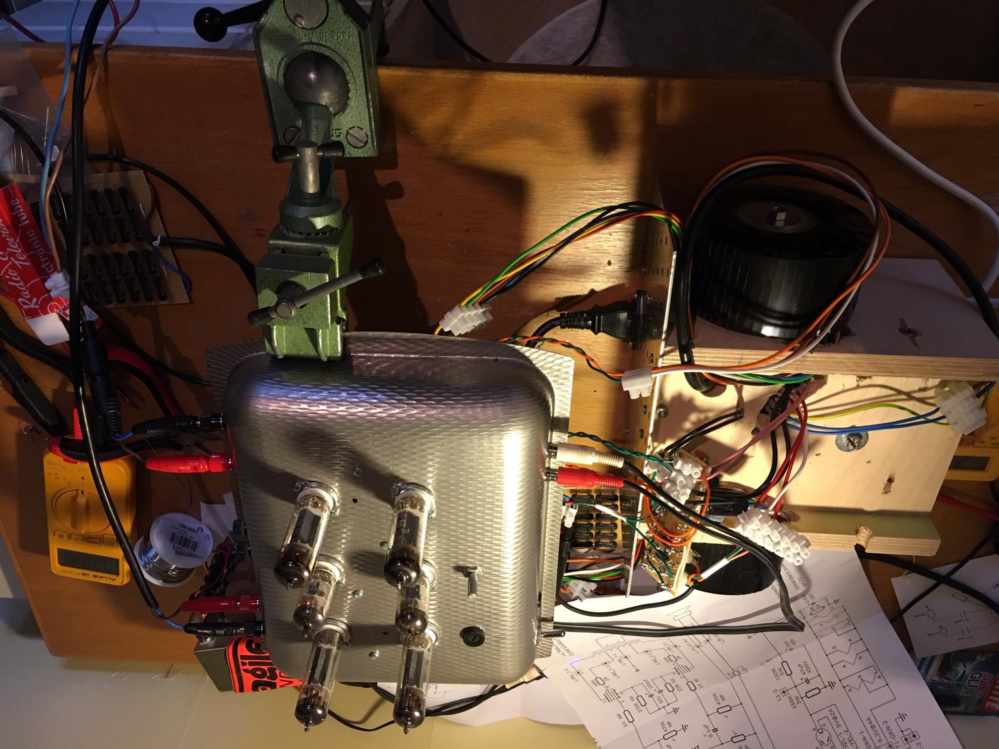

My approach was to start with a Tubelab SPP. Then I cloned that design so that I could make use of cheap PL84's (15v heater EL86's). I built the identical circuit P-P into a rather natty baking tray I found in recycling, so that I could use the working circuit as a reference, and so that I could think about the spatial parts of the build. (Note the clutter free and organised working environment).
Alternaively, there are builds based on turret board that can be cloned, or do it on a breadboard, so that the tube holes are not cut in your chassis, limiting your options, allowing re-work.
