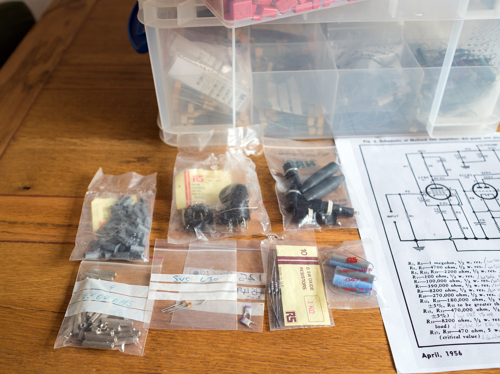

In other news, the hunt for components that I already own has been a bit poor. I've found some 47pF ceramic caps (orange coded), some 330pF ceramic caps (violet coded), some 470nF 600V MKP caps, some 1K 1/2W oxide resistors, 3 octal sockets, 2x fuse holders with fuses and some standoffs/spacers.

I've committed myself to the project and bought the sowter UA21 outputs as 16 ohms with 8 and 4 ohm taps. They take 6-8 weeks to build and ship so I'll save buying the other components until next month. I'll be sorting the mains transformers out today, as I expect they take a similar amount of time to manufacture.

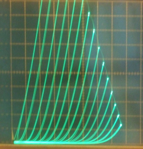

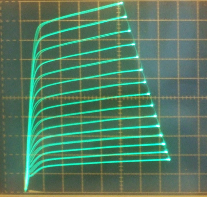

The 6197 tube is a good sub for the 12BY7. Plentiful and cheap, with excellent curves, pentode or triode mode ( Mu 22 like the 6CG7 or ECC99).
Or there is the 6HZ8 which gives you a 6197 pentode and a nice linear Mu 70 triode in one 9 pin bottle. Have been on the $1 list at ESRC.

Note:
6197 and 12BY7 have different base pinouts, so are not plug-in substitutes.
For design they are electrically near equivalents. 6HZ8 has two sections, pentode and a triode, definitely not pin plug-in compatible with either,
