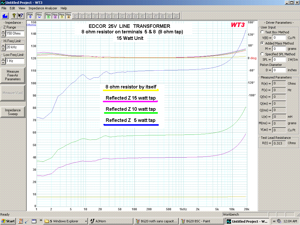

here's what I got with a 25 volt 15 watt rated Edcor transformer for reflected impedance with an 8 ohm resistor on its 8 ohm taps - it might be less expensive than some autoformers. I gave it a quick go with Beta 8cx - can't remember the CD but likely a Ti PRV 280

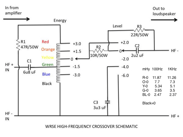

In this document L attenuator is used without typical R that bypassing highest tap to gnd?
I measured in my example With / without this R, and without R it was not good at all Impedance curve was disturbed
and sonically was not good too...

this is incompleate PDF file of the topic about the Shunt resistor.
This is a R1=47ohm shunt resistor in Tannoy crossover sch.
In my att I think I used 82ohm?

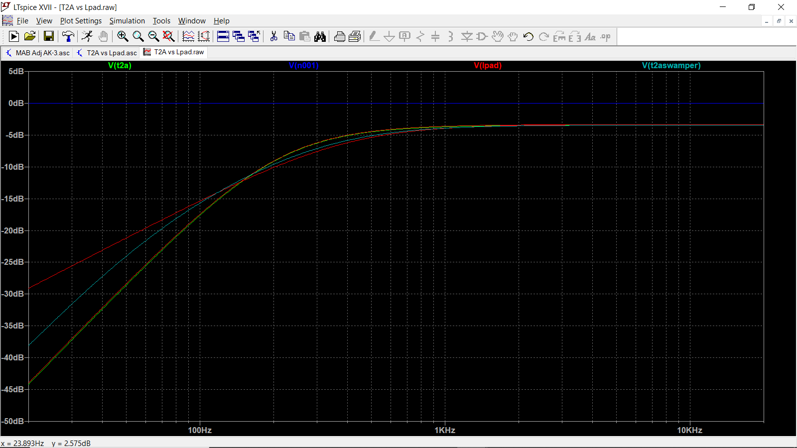

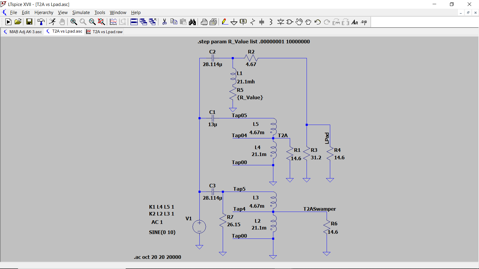

Perhaps this crude LTSpice model will help you understand the differences between an autoformer and an lpad as far as the resulting voltage transfer function. I'm using a model of a Klipsch T2A autoformer and using it's -3.35db tap.
The middle circuit is a typical Klipsch high pass circuit to the squawker. It's the green plot. It's a little hard to see, but it starts around -44db.
The top circuit is an lpad circuit set to -3.35db. Because the T2A increases the load on the 13uf capacitor (14.6*2.162, or 31.57), I need to use a 28.114uf capacitor in this circuit. It's the top red plot. However, the 21.1mh inductance between tap00 and tap04 is missing. In order to get the same plot (the lower red plot really close to the green plot), I needed to add a 21.1mh inductor across the driver.
The bottom circuit incorporates a swamping resistor. I chose a value that, in parallel with the reflected impedance of the autoformer (31.57 ohms), brings the load on C3 back to 14.6 ohms. Notice the blue plot, as it now appears as if a parallel 44.8mh inductor is across the driver. 44.8mh is the inductance between Tap00 and Tap05.
