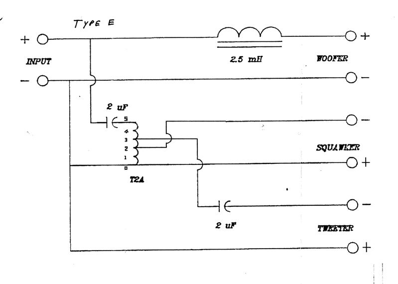

B. you are right, one cannot just put an autoformer in the place of an Lpad. I remodelled the whole mid and high path and use only R’s parallel to the drivers, so not in the “signal path” (whatever that means ). Now resonances caused by driver inductance and X-over C’s and L’s are damped in that way or by the amp.
I bought two really good new autoformers on eBay from Germany for about 220 US$ actually meant for Altec X-overs. I save some money on the smaller C’s and L’s in the paths. I’m not someone that believes that audio wires or different kind of polycaps make a big difference. I never really heard much improvent, mostly not at all by changing already good audio-caps. But the autoformer really made a difference. To me it was an improvement because I like clean and dynamic sound. The stereoimage seemed less wide but I hear more resolution. Like it is an active monitor now. I can also play louder. Voices never hurt my ears anymore at high levels. Would that be the control of the amp?
It seems like an autoformer is only going to have one or two possible taps of interest when designing a crossover. Am I wrong in thinking that one could just measure the driver impedance & response with the autoformer plus swamping resistor connected to it and use that as a new “lumped” driver to sim with? Since there’s only one or two taps of interest, one would only have to compare two “lumped” drivers.
Sounds like a perfectly logical way to approach the problem to meIt seems like an autoformer is only going to have one or two possible taps of interest when designing a crossover. Am I wrong in thinking that one could just measure the driver impedance & response with the autoformer plus swamping resistor connected to it and use that as a new “lumped” driver to sim with? Since there’s only one or two taps of interest, one would only have to compare two “lumped” drivers.
When simulating varying the outer capacitor, considering it is shorted across the Voltage source. For varying the inner capacitor you might either remeasure for each change, or find an equivalent circuit using transformers. This may call for a general purpose circuit simulator.It seems like an autoformer is only going to have one or two possible taps of interest when designing a crossover. Am I wrong in thinking that one could just measure the driver impedance & response with the autoformer plus swamping resistor connected to it and use that as a new “lumped” driver to sim with? Since there’s only one or two taps of interest, one would only have to compare two “lumped” drivers.

It seems that you have not understood autoformers or and maybe have never used a good one. Resistor or not perfect linear devices.
For the given example of a 2nd order filter the best way is to place the coil after the autoformer and the cap before. With the swamping resistor before the AF you can adjust the roll-off. The biggest difference is that an AF has a very small Zout to the CD compared to a Lpad.
Was brought here because I was curious about autotrans in crossover. I'm no expert in this area but ehre are some thoughts after reading this thread.
1. Saturation issue - I think the autotrans should be insert after the 1st cap so that the cap can cutoff the lower freq into the network.
2. Software modelling - if we reduce the autotrans to passive component with inductance and resistance, it is effectively a L-pad with LRseries and LRparallel instead of Rs & Rp.
So a autotrans of 1mH and 1R would be something like LRs = 0.1mH+0.1R and LRp = 0.9mH+0.9R at the 90% tap.
Probably not as straight forward as the above but I think it would be close.
3. Just like the L-pad isn't a potentiometer, the autotrans should have taps that are customised and the taps 'hard-coded' after proper design.

I have modeled autoformers in LTSpice with good success. An autoformer is one inductor with one or more taps. To simulate, you need to have two series inductors that are mutually coupled. Since the output voltage is based on turns ratio, your 1mh example should be .01mH and .81mH.
DCR is tricky since the first 10% of the windings are probably closer the the core, and each of the remaining 90% of the turns get longer.

The Crites 3636 autoformer can attenuate the voltage up to 12db, in 1db increments.
I made a pair not so long time ago. I remember that I used some old M85 035mm type laminations from Siemens choke. Gap was 1mm but with oposite stacking showed around 1/3. The laminations was from my findings from higher relative permeability. That is important because someone can use less windings and have more space for wider wire diameter, to decrease Rdc of the wire.
That is from importrance because of the small one digit load. The wire was 1.3mm dia, Rdc was 0,2 ohm or a bit less, and total inductance was about 25Hy
parallel resistor say 47ohm, from input end to gnd is a must (like in the traditional designs for this type of attenuation).
All in all the sound in general was totaly diferent and significantly better. And the impedance curve was better.

Hi Zoran. How to calculate the number of turns of wire for the first and second autoformer coils, e.g. if we are talking about a simple attenuator with one tap option?I made a pair not so long time ago.
The output voltage is directly proportional to the number of output windings divided by the number of input windings If there are 1000 input windings and 500 output windings, the output voltage will be half the input voltage, or -6db.
An important thing to remember is that this is an inductor in parallel with the driver, and the inductance of the output windings will create a 2nd order high pass filter when a capacitor is connected to the input taps. Using the 25mh example, the inductance of the -6db taps will be 6.25mh.

The number of total turns doesn't matter, just the ratio. You can use 100 turns input and 50 turns output and get -6db, but the inductance would be so low that the capacitor would be connected to almost a dead short at low frequencies.
Let's start with this calculator and see where it goes.
http://www.sengpielaudio.com/calculator-amplification.htm
Since windings equal attenuation, enter 1000 in the Input field and -4 in the Level change field. Click on Calculate value 2. You'll get 630.957 in the Output field. So, if you have 1000 turns on the input, and 631 turns on the output, you will get -4db.
