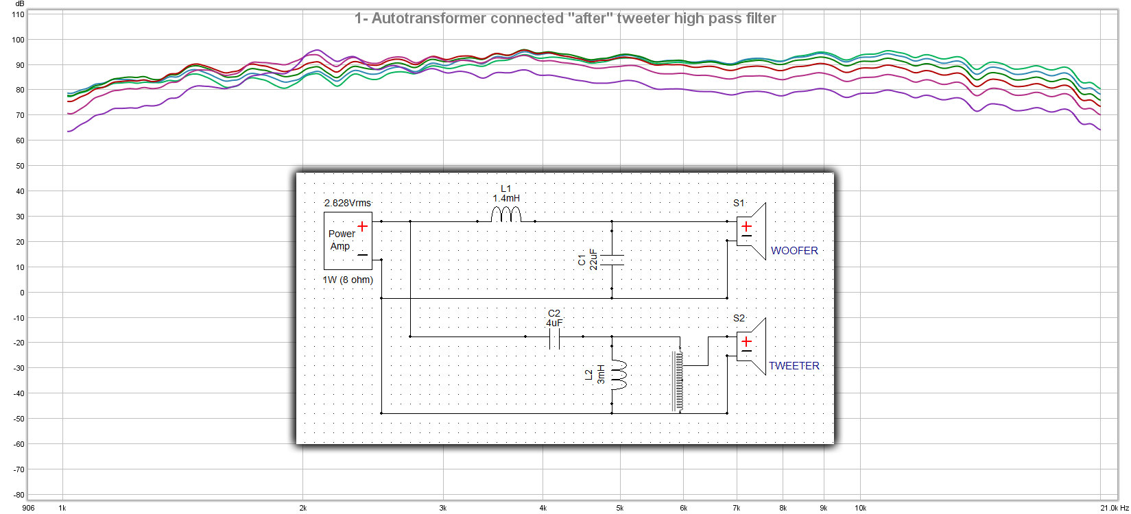

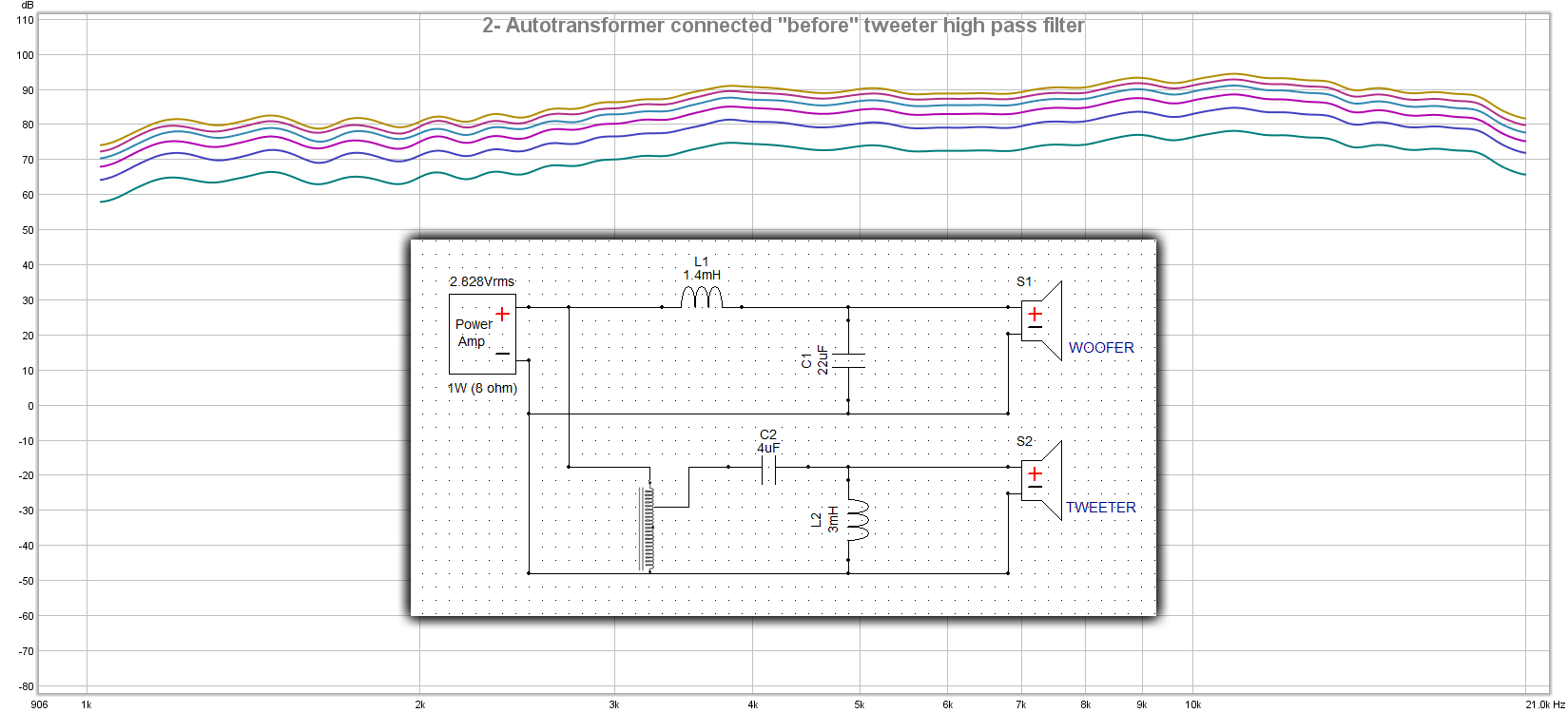

Placing autotransformer in crossover
Perhaps this crude LTSpice model will help you understand the differences between an autoformer and an lpad as far as the resulting voltage transfer function. I'm using a model of a Klipsch T2A autoformer and using it's -3.35db tap.
The middle circuit is a typical Klipsch high pass circuit to the squawker. It's the green plot. It's a little hard to see, but it starts around -44db.
The top circuit is an lpad circuit set to -3.35db. Because the T2A increases the load on the 13uf capacitor (14.6*2.162, or 31.57), I need to use a 28.114uf capacitor in this circuit. It's the top red plot. However, the 21.1mh inductance between tap00 and tap04 is missing. In order to get the same plot (the lower red plot really close to the green plot), I needed to add a 21.1mh inductor across the driver.

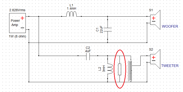

The bottom circuit incorporates a swamping resistor. I chose a value that, in parallel with the reflected impedance of the autoformer (31.57 ohms), brings the load on C3 back to 14.6 ohms. Notice the blue plot, as it now appears as if a parallel 44.8mh inductor is across the driver. 44.8mh is the inductance between Tap00 and Tap05.

This is OK
BUT try to put as the load more complex speaker spice model. Because that is the complex RLC condensed circuit. NOT only passive resistace like 4ohms or 8ohms...
Because of the more accurate graph AND phase...
with every inductive att. have to place bypass R of 47-120ohms in parallel with input (maximum) tap - GND.
Try to simulate W/WO.
And measure after that to confirm. I did, and more dramatic diff are in real world. As with SPL and phase as the sound outcome.
