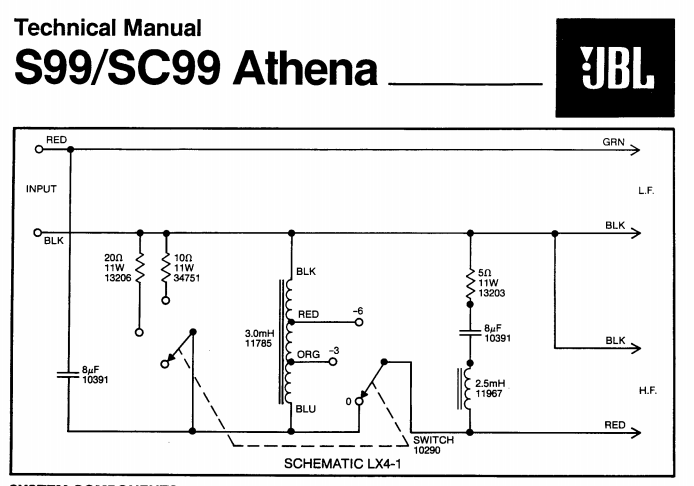

Here's a good example of how JBL used to use autoformers ( back in the day ).
The point is that an autoformer is also an inductor and some of the more clever designers will just build it into the overall network ( when they can ).
Notice the switched conjugate resistors ( source side of the autoformer ) working to present a consistent impedance to the preceeding capacitor.

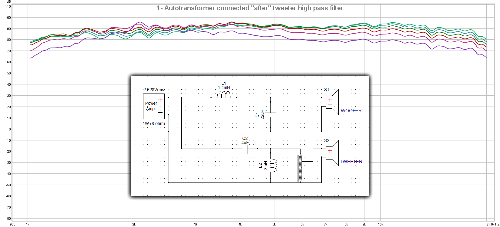

I'm a bit surprised the OP didn't see the "reflected" impedance issue crop-up since those pics seem to be snaps of XSim ( which has an excellent impedance window ).

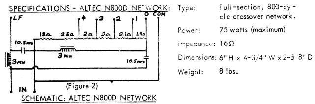

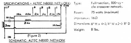

FWIW here's an ancient Altec two way autoformer schematic: http://digilander.libero.it/steveviso/audiogarage/N800schema.jpg
GM
GM
Must be a case of dimming eyes, but that's no autoformer, instead that's Altec's ( clever ) kludge-up in how-to-make a multiple-fixed attenuation LPad ( using resistors ).
Multiple taps on a single Ohmite variable 25W?? wirewound resistor are implemented.
Here's a thread ( over at AK ) that details the N800E ( using resistors )..
Worth noting is that the posted schematic is incomplete ( in the posted schematic the HF section wasn't referenced to ground ).
Still, it's good info if one uses it carefully.

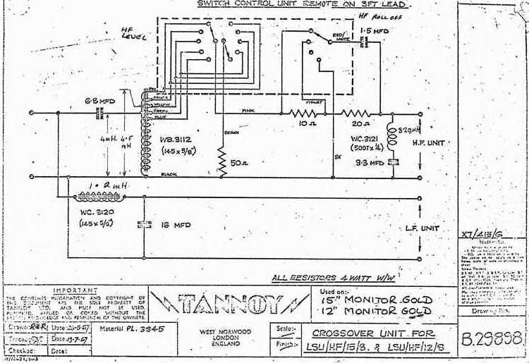

I have a pair of Tannoy Monitor Golds with autotransformers in the crossovers.
The Tannoys have 5 taps
The Tannoys have a single 50 ohm resistor connected to the autotransformer which is switched in the opposing direction to the tweeter.
When the HF is in the highest position the 50 R is disconnected.
I understand what the following parts of the HF circuit do but I am unclear on how the 50R effects the circuit
Copy of schematic attached, the only difference from what I have is the LF inductor is nearer to 3mH.
I understand what the following parts of the HF circuit do but I am unclear on how the 50R effects the circuit.
When HF "is in the highest position" the autoformer doesn't attenuate and then the impedance of the driver isn't stepped up towards the crossover and no parallel resistor is needed to get the impedance in a "useful" range.
That's right. The impedance has to stay relatively constant because otherwise the capacitor before the autoformer has to change values too according to the settings.

How does one get an autotransformer component into XSim. And, can the winding ratios per tap be customized?
Mike
Mike
I believe the displayed pic was done using an unreleased version of XSim ( iow; XSim 3d )
Mike
THERE IS NO autotransformer component in XSIM (I wish there was). I placed the transformer in the schematic using an image editing tool
