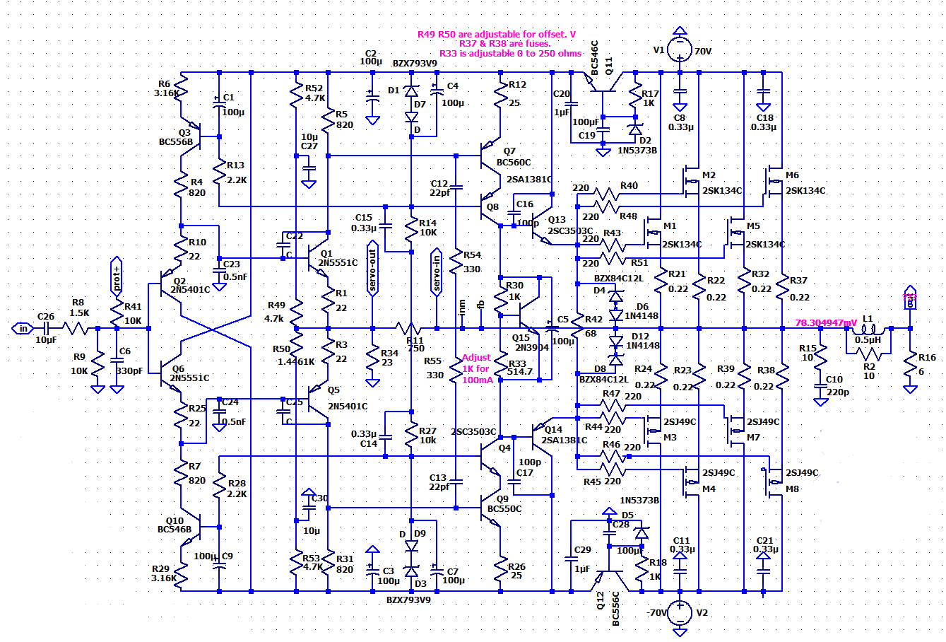

The schematic will be something like this, I still have to refine the current values and optimize feedback compensation network.
Schematic under, just to give an idea.

Very nice amp and results. I don't like compensation C16,17.

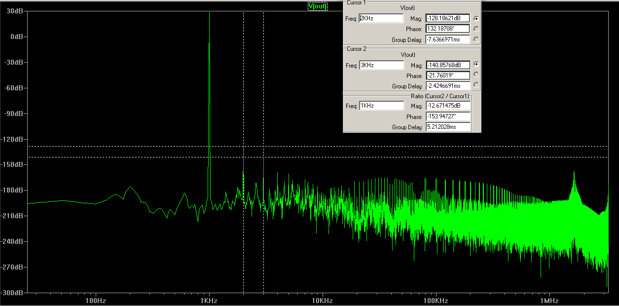

Btw, can you beat this ? 😀
200W/4R (VFA TMC+CHERRY+EC) less than 1dB under clipping

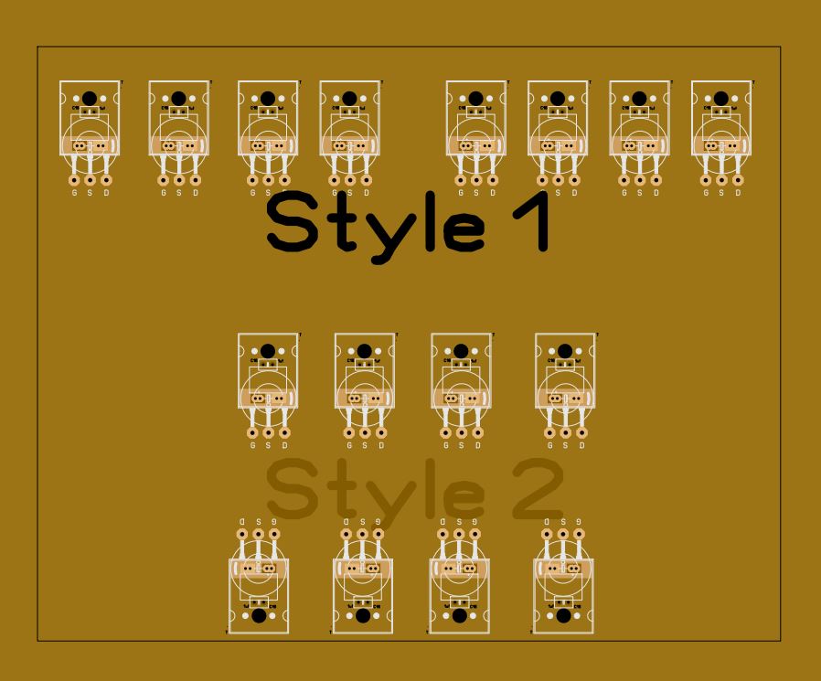

Please choose a layout style to use for the output area.
The style I is better for cooling and thermal balance. If placed at 1/3 -2/3 from the bottom of a passive cooler, it allow the best cooling efficiency.
But style 2 is, may be, easier for you, and allow shorter connexions to the Power devices ?
On my side, I tend to prefer the 1.
About the front end, I have a question.
If we stay with the non bootstrapped input stage version which seems more stable with temp variations (I have to ensure more deeply) What do-you (all) think about putting adjustable resistances R3, R4 to adjust the currents to 1.2mA in the second stage whatever the VBE mismatches ?
I will do style 1 and put in jumpers to allow for variations of certain schemes, such as one or two drivers and either smd or tth devices, as well as test points for easier development. This is going to be a development type board. All suggestions are welcome and desired. Should another thread be started for the layout of the board? I will do alternating n and p channels of the output devices.
You can forget the two drivers. No need, spladski and I we both agree.
About SMD or TTH, you have to chose, on my opinion: What should be the interest to go for SMD if the board is large enough to support TTH, what do you think ?

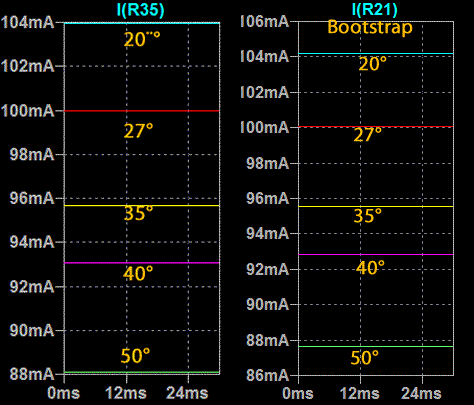

After further simulations, it appears that the bootstrapped version gives the same tempco than the original one. See attached. Quite secure. So we will finally keep on this one.
I tried simulations with 3 different input pairs. Nothing catastrophic. I let R3 & R4, in case the VBE will have too much differences.

After further simulations, it appears that the bootstrapped version gives the same tempco than the original one. See attached. Quite secure. So we will finally keep on this one. I tried simulations with 3 different input pairs. Nothing catastrophic. I let R3 & R4, in case the VBE will have too much differences. Time for a little rest for me.
Hi Tryphon, I haven't had much time to pop in and will try to catch up with what is happening next few days. WRT IP diamond pair, you can use either bootstrapped or non bootstrapped and jig them to have whatever tempco you like. I suggest you dump the sim and breadboard the front end up, just the diamond pair and do some real measurements. Use a hot air gun for heat source. Here are a few tricks: - You can use diodes in place of R10 and R25. R1 and R3 will have to go bigger to achieve same current. If diodes are coupled to IP BJT's, you will end up with negative tempco.
- Second trick is to play with resistor sizes. IOW if R1/3 are smaller than R10/25 and the BJT's are thermally coupled, it should have a negative tempco.
- One of the issues impacting thermal stability is you have current gain in the voltage stage because of ratio of R5/31 and R12/26 = 820/25. So any thermally induced current run away in IP stage gets magnified through 2nd stage.
- A solution to this is to make R5/31 and R12/26 more similar in size. This will lower your current gain. The downside is distortion will go up a bit. You can get around the distortion issue at high frequencies by bypassing R12/26 with a film cap (and usually a smaller series R). This will increase OLG at higher frequencies. Since the amp has such low distortion at 1kHz it's not too much of an issue to increase distortion at these frequencies.
- I'll run the sim when I get some time. I haven't got my head around the error correction yet, need to have a closer look. Doing sims with opamp based error correction is pretty unreliable.
The amp looks great so far.
T
Terry preempted. This version is more tolerant of device change and temp. Split the driver resistor so that a feedback point can be taken midway without output devices to establish DC conditions.
I believe that will go the opposite way, IOW, will make it *more sensitive to temperature rise. Diodes should go in input pair circuit in place of R4 and R7. You can also use schottkys for a smaller voltage drop.
I cannot stress enough the need to actually breadboard these circuits and measure them. You learn a lot on Ltspice but more building the circuit.
