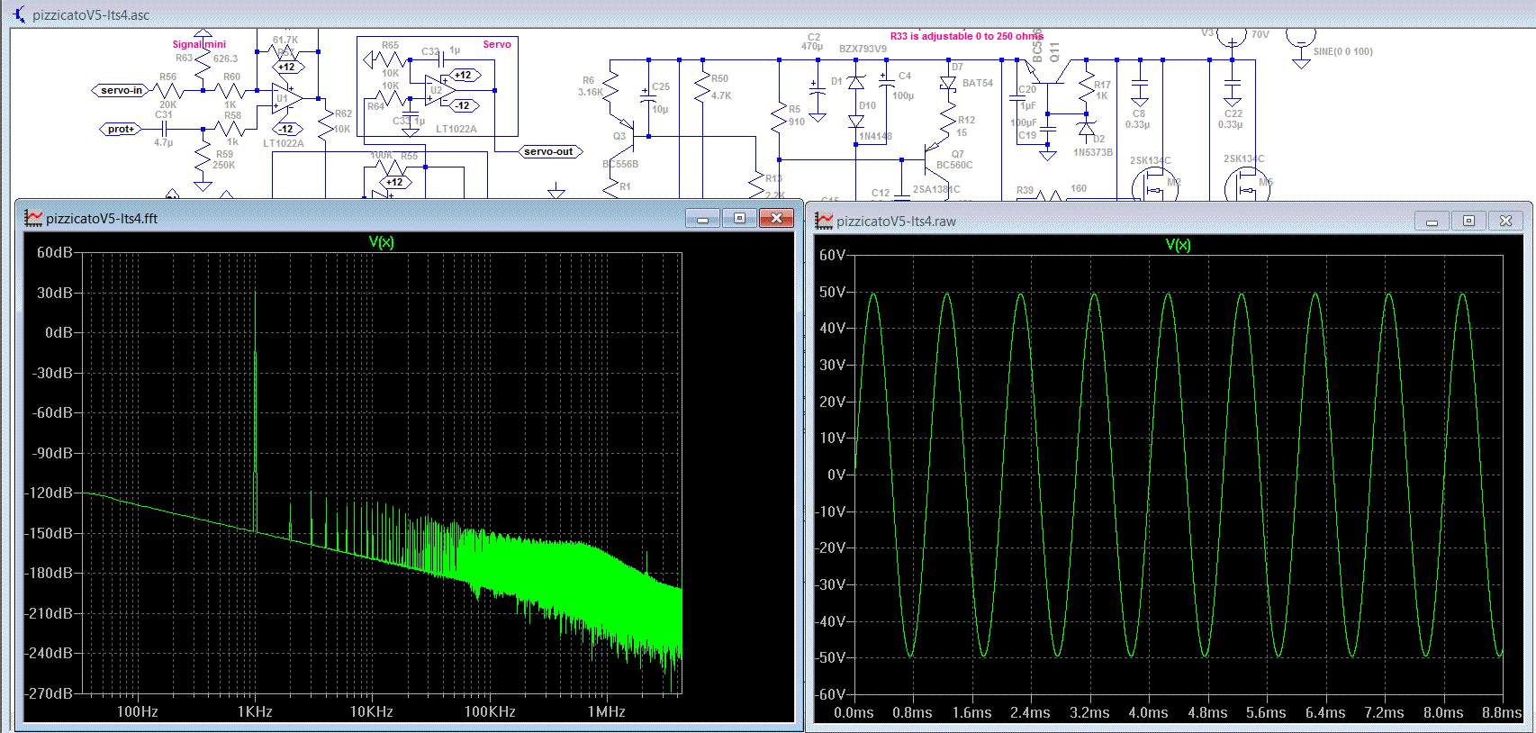

I use LTSpice VII. Working.Verifying temperature compensation. Models are suspect Wanted to make sure circuit was correct. Can't be connection. Downloaded both versions. My one opens, yours says syntax error and aborts.

There are many options for tempco. The proposed solution on the table should be bread-boarded as suggested by Terry, while other avenues are investigated.
Also using the gear option for simulation is not recommended. LTspice uses a modified version of trap innately which damps ringing. The gear option is for aligning with other simulators which produce erroneous results.

Very often a good strategy is 'divide and conquer'. It could be worthwhile to just concentrate on simulating the temp and matching effects in the input part, without dragging along the whole thing as a big distraction. Just a thought.

I don't understand what you mean. The problem is very simple. It works, and there is no more problem with temperature effects, as far as I can see.Very often a good strategy is 'divide and conquer'. It could be worthwhile to just concentrate on simulating the temp and matching effects in the input part, without dragging along the whole thing as a big distraction. Just a thought.
The problem is that I think it is too tricky for the moment to tune the input stage depending on the VBE differences between VBE of NPN and PNP devices.
Because any change of current affect both the Offset and the second stage currents in the same time. I have to try various solutions. And each part affect all the balance of the others.
It is not simple. If you tune the input stage alone, incorporating it in the whole circuit makes an offset that destroys its balance.

What I mean is, will all due respect, if your input stage 'works' or 'works not' due to different small signal transistors, there is a big oversight in the circuit. Changing between, say BCxxx types or 2N34xx types can make some small differences but should not upset the system. And I would think that can be solved in isolation.
Same thing with small Vbe differences. IRL differences may easily be 50mV or 100mV from one build to another. Your circuit should work with high and low values.
Make sure that the input stage does what you want it to do, before hanging a complete amp on it. Try it with a load that acts like the rest of the amp.
In a sim you can do things in analysis that are impossible to do IRL.

Jan, it is not that it doesn't work with various devices, even non paired. It is just, as I said that it is difficult & painful to adjust. At least in sims.What I mean is, will all due respect, if your input stage 'works' or 'works not' due to different small signal transistors, there is a big oversight in the circuit. Changing between, say BCxxx types or 2N34xx types can make some small differences but should not upset the system. And I would think that can be solved in isolation.

I'm thinking to the real world. And I have to find the limits to be safe whatever the transistors and nobody to be be obliged to change a resistance on the bench, because, in his situation, it will be, bad luck ?, out of range.
My remark was addressed to Krisfr: I don't want him losing his precious time on something that can be modified after he will have finished his board design. And I still have to experiment one or two ideas to see what is the best: I'm not fully satisfied for the moment.
Working on the input stage in isolation is what I do yet. Reason why I had to
replace back the offset adjustment. But I don't think it should be a good idea to have to tune the input stage with VAS & output stage non populated in real world.
