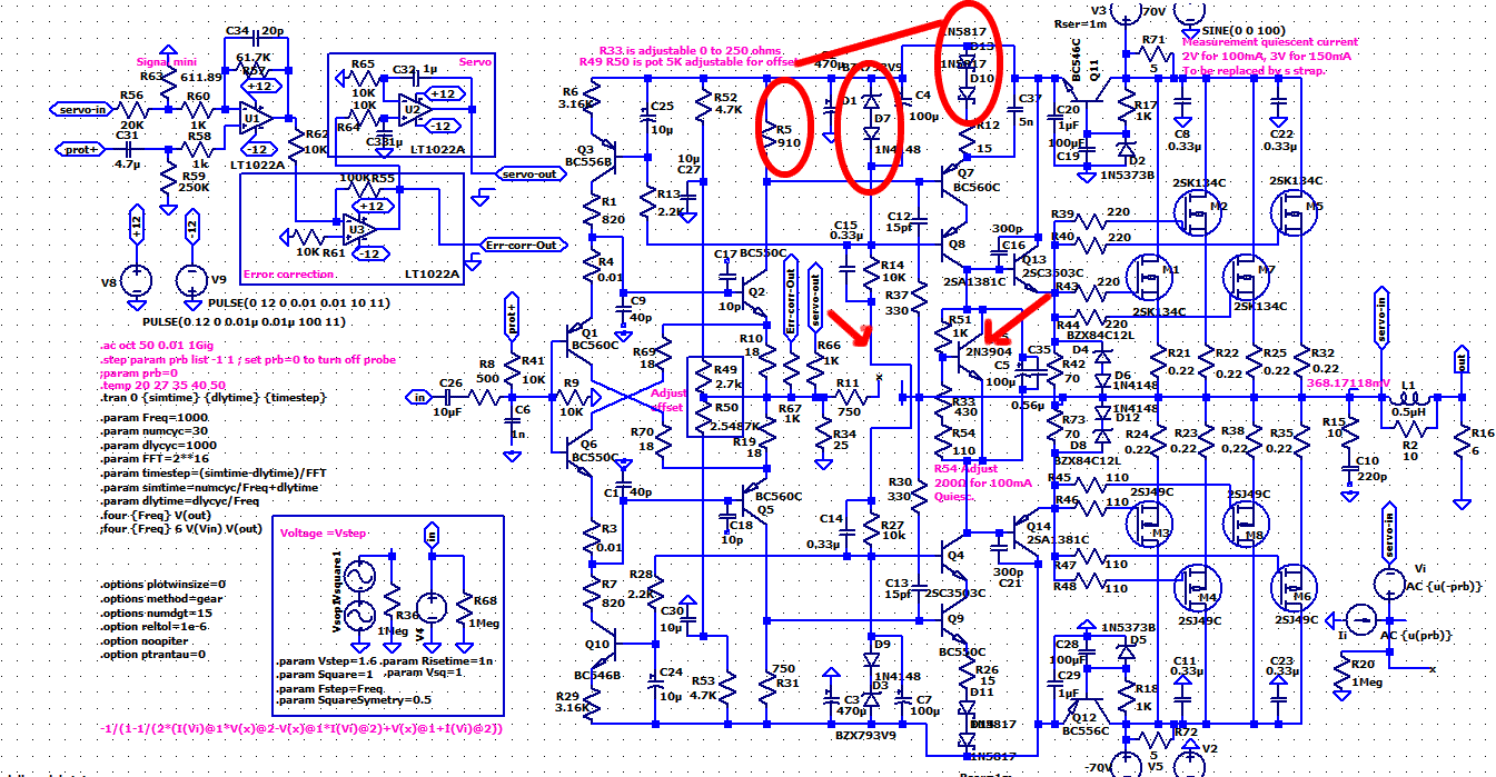

Terry, thanks for your help and interest. Greatly appreciated. As we still have a negative tempco, as you had seen in the last attachment, I'm concentrating on other things.Hi Tryphon, I haven't had much time to pop in and will try to catch up with what is happening next few days. WRT IP diamond pair, you can use either bootstrapped or non bootstrapped and jig them to have whatever tempco you like. I suggest you dump the sim and breadboard the front end up, just the diamond pair and do some real measurements. Use a hot air gun for heat source. Here are a few tricks: - You can use diodes in place of R10 and R25. R1 and R3 will have to go bigger to achieve same current. If diodes are coupled to IP BJT's, you will end up with negative tempco.
- Second trick is to play with resistor sizes. IOW if R1/3 are smaller than R10/25 and the BJT's are thermally coupled, it should have a negative tempco.
- One of the issues impacting thermal stability is you have current gain in the voltage stage because of ratio of R5/31 and R12/26 = 820/25. So any thermally induced current run away in IP stage gets magnified through 2nd stage.
- A solution to this is to make R5/31 and R12/26 more similar in size. This will lower your current gain. The downside is distortion will go up a bit. You can get around the distortion issue at high frequencies by bypassing R12/26 with a film cap (and usually a smaller series R). This will increase OLG at higher frequencies. Since the amp has such low distortion at 1kHz it's not too much of an issue to increase distortion at these frequencies.
- I'll run the sim when I get some time. I haven't got my head around the error correction yet, need to have a closer look. Doing sims with opamp based error correction is pretty unreliable.
The amp looks great so far.
The add of a simple diode in serial with the reference zener's of the current sources had solved one part of the problem. The current sources are now very flat with temp changes.
The add of a classical transistor to set the quiescent solved the issue. And add a security in case of bad contact of its adjustable resistor.
I cannot follow your various tips, because I don't know which file you are referring-to with resistances numbers ;-)
Please, see attached the last changes. The diode in the current source references to stabilize them in temp. The twoo schottkys in the VAS emitter to allow more gain margin (still works with 910 Ohms). And, this way, I can have max gain and keep the DC current low in the VAS/drivers (~6-8mA). And the transistor for the quiescent that bring negative tempco.Terry preempted. This version is more tolerant of device change and temp. Split the driver resistor so that a feedback point can be taken midway without output devices to establish DC conditions.
I agree with Terry about diodes in the input stage with the advantage we don't loose gain while fighting against VBE mismatches. The basic idea of this project was to use the input stage to add as much loop gain as possible, VFA like, while keeping the "expansive" CFA behavior (Current on demand). The asc attached show 0.000006% @1KHz.
About error correction, I use-it since decades. It is working with no problem, as long you use fast enough Opamps (minimize phase turns) and don't ask them too much (just a degree of magnitude). It is optional, depending of the way we like the sound with or without, as the amp itself is low enough distortion ;-).
The final amp could have a switch "on/off" for the err.corr. But using-it for DC servo, (that I never seen before) is really a plus. Minimize impact on the sound, faster and more efficient.
What about this, to can adapt input stage to any VBE mismatches and disparities ?
May-be a little tricky to tune, but only affect DC.
I like your use of the DZT5401 and the 20n/p20 for the outputs.
The subcircuit (R13 series I1) is an interesting object. Its Norton equivalent circuit is illuminating.
It appears again as (R8 series I2).

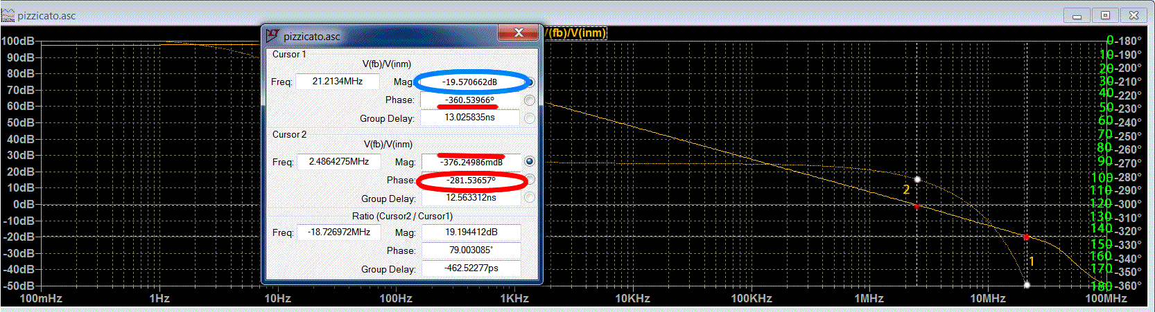

Thank you for your lovely design. It's always interesting and fun to see how a design slowly morhpes into maturity
I'm always trying to learn, and got curious when i saw your open loop bodeplot on the very first page. It shows that it reaches 0dB gain at around 287°. Is this amplifier stable ?
If I have not misunderstood the concept, it should reach 0dB open loop gain before it reaches 180°, preferably with a phase margin at around 60°. ( 0dB gain at ~ 120° )
I think that it might not be an issue, if the 180° are reached way beyond the audio spectrum, and the input has a r c filter. But what about other sources of hf, like cb/ham radio, microwave ovens, or whatever else might generate hf
Can someone please explain why it's (not) stable?

Probably saved in the middle of something ? There is too an error on the R31 that should be 910.V4 does not run. Syntax error.
Do-you need I repost a working one, or can-you figure-it out ?
Not really as you interpret the curve. It is one of the fantasies of LTSPICE with Middlebrook. It takes 0 and even sometimes 180° as reference at the low frequency starting point. But here, we have a servo that introduce 90° phase shift that you have to substract.Hi.

If you can make a Tian "V(fb)/V(Inm)". More simple to interpret. Lot of phase margin.

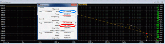

If you make a Tian "V(fb)-V(Inm)", you will see this: (attached). More simple to interpret. As you can see now, lot of phase margin.
Thank you. That actually makes good sense
Made a more talkative image to explain. Removing the DC servo, manual limiting the phase scale.Thank you. That actually makes good sense
Here the reference is -180° top of the frame. The point 2, at 0dB (Red dot, -376mdB) is at -281° (White dot). Makes 100° of phase shift. Margin is: 360-280= 80° (79°).
The point 1 is at -360°(white dot). Makes 19dB of gain margin (red dot).
All this is in the pop-up, resumed in the third square: "Ratio (Cursor2/cursor1)
The LTSPICE UI is a p. in the a.
In 5 minutes of work, they could code the scale to set the reference always at 0 instead of - or + 180° or 90° etc. Totally Stupid.
Onemangang, I think i have understood your problem: you were looking at the phases numbers horizontally aligned to the gain curve. You have to find the point on the phase curve vertically aligned to the gain point then look to the corresponding number on the right.
I don't know if I'm clear.
Hi Tournesol.
Thank you for your this. And you are clear. It's me who is mistaken, and also a little confused.
When I saw your openloop 'bodeplot' in post #2 I did not notice that it said 'V(fb)/V(Inm))'. I took it for a normal bodeplot V(Out) and just looked at the numbers that ltspice reported. Sorry about that. I do understand that you can just subtract the phase reference.

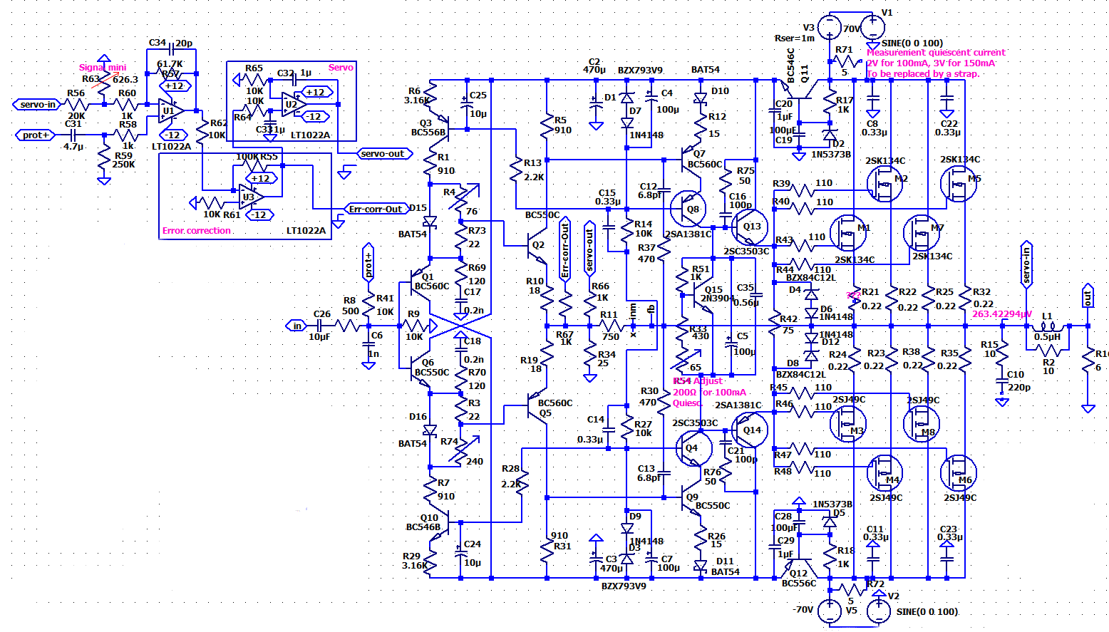

But while trying to plot V(fb)/V(Inm) myself, i noticed in your schematic, (both post #2 and #145), that 'fb' and 'Inm' are both connected to the amplifiers output. I assume 'fb' means feeback, and 'fb' should be on the other side of R11? But 'Inm'?
When i play with ltspice and open loop gain, i usually short (in this case) R34 with a huge cap, wich in turn would make 'V(fb)' unusable. Hence my confusion.
Maybe I am going about this all wrong. Is it too much to ask for a schematic/simfile that shows how you sim V(fb)/V(Inm)?
Your explanation about wrong phase reference also clears up why ltspice can show positive phase shift.

Here we are: The idea to offer the ability to tune the current of the second stage of the diamond seems to be fine. As those currents set all the DC balance of the amp, no need of the offset adjustment network any more, and all the trouble that comes with (noise from ripple of the power supplies).
The way to adjust is simple: First adjust R4 to get 1.2V of current across Q2 (1,092V between the two sides of R5). Then, adjust R74 to suppress the offset voltage at the amp output as much as possible. Done.
See attached PizzicatoV4-d.asc
I tried various input devices balanced and unbalanced. Seems to work fine.
I tried some temperature measurements. Here what I got in the wonderful world of LTSPICE ;-):
Between 20 and 50° (27°)
- Current sources (First stage) 1.2051 to 1.2021 mA (1.2mA)
- Second stage: 1.20929 to 1.16339 mA (1.2 mA)
- VAS: 6.6 to 8.85 mA (7.31mA)
- Driver: 10.07 to 9.5 mA (10.45mA)
- Power FETs: 104 to 90.34 mA (100mA)
- Offset: 70 to 140nV.
HD at 1kHz: 0.000005%
Phase margin: ~63°, Gain margin: 12.6dB.
Bandwidth (-3dB) :
Without input filter: 1.5Hz to 10MHz.
With input filter: 1.5Hz to 325kHz.
