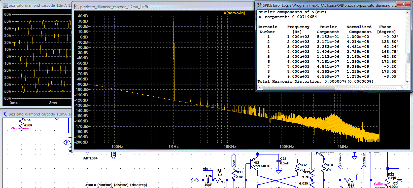

See attached:
At 10KHz, got 0.000052% of HD
Of course it is totally unrealistic. A LTSPICE hallucination.
No problem! You got many ideas to try...
Anyway I don't like THAT, because of the low Hfe. I use BC550C/560C, cascoded with 2N5551/5401, or fully KSC1845/KSA992 in my amplifier. Matching is necessary, but not hurt so much.
0.000052% is just a dream. But You can get some 0.001% in real life.

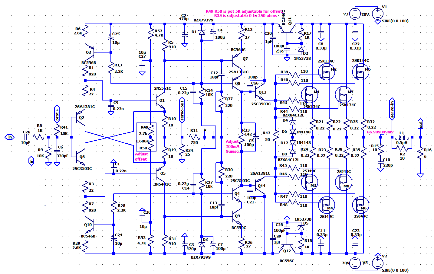

Tryphon, very nice work.
I am dabbling with a bridged CFA design after having tried many different amplifier topologies and not being totally happy with the sound.
WRT the input pair, you may have to use emitter degenerating R's to Q1 and Q5 but it may also be happy without them, it's just something to keep an eye on.
WRT the input pair Q2 and Q6 bootstrapped collectors - some people like it, some don't. It's all part of your own recipe 🙂
Having said this, you have to be careful with bootstrapped BJT's WRT oscillation. It's relatively easy to prevent with some resistance in the collector circuit to decouple them and sometimes also a small C to ground.
One big advantage of the bootstrapped input pair is it will enable much higher source impedance drive without a significant distortion penalty. This is a good thing if you are driving the amp from a passive pot, for example.
If you run the amp 10 or 20kHz sims with a source Z of 10k, the distortion results will show this up.
I like the fast BJT's, Q13 and Q14 BJT's driving OP MOSFets. This is one reason the distortion is low, especially at high frequencies. It isolates MOS capacitances from VAS.
Should be a great amp.

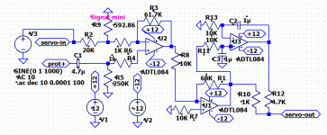

Right now, I'm exploring this idea: Error correction (optional) and protection. Using the differential signal that contain only errors due to the amp, including DC ones to improve the DC servo. (Faster and less impact of residual audio signals).
Apologies for my poor English.
The new servo-error correction seems to work. But Ltspice seems to turn crazy with the AC analysis.
The signal from input of the amp (after the input cap if any) enter in "Prot+"
The Power amp output signal (before the coil) enter in "Servo-in". And is carefully reduced in level with the R9 resistance to equal the input level one.
The OPA (fet) U2 makes the difference between the two signals. This contain only the errors produced by the amp (distortions+offset) + a very little residual from the in and output signal due the phase turns (90°).
From this point, the error signal is amplified by U1 before to return (attenuated by the R10 resistance), to the virtual - input of the amplifier (the middle point between the 2 emitters ). It adds a feedback gain without touching to the closed gain one. It is attenuated by the bridge between R10 and R34(23 Ohms) of the power amp.
To get an idea of the discrimination, once amplified by the two OPAs, the residual signal for a 1V input is 0.5mV, with the DC offset error signal of the same order.
To get an idea of the efficiency, it decreases the distortion by something like 10dB.
From the output of U1, the same error signal is filtered to get the DC (~12dB/oct above 1Hz)) and amplified to compensate the offset (DC servo).
It return to the same point.
The difference with a classical servo is that the offset is kept the same, while the signal was near totally canceled by the first differential OPA.
Attached the sim file of this part, for those who are better than me (and patient). To be added to the amp ASC itself.
Edit: The voltage source V3 was added for measurements and need to be removed)
Here the last version of the Amp itself.
Comments and critics are welcome at this step (I took previous remarks into account).
And one question. I always used Power FETs with gate stoppers. But, here it seems to act the contrary than expected. The gain loop is better without the Pick they brings. Is the Colpitts oscillator that those stoppers are supposed to dump is not simulated by LTSPICE ? If we manage to put the driver emitter very close to the gates, is-it possible to get rid of them ?

The 1MHz version
The 'out' label is shorted to 'servo-in'. Insert 1R into 'out' to separate.
The goal for the 1Mhz version was to achieve less than 1% distortion at 1MHz before the inductor. The load side reduces harmonics.
Using thick ceramic spacers for the power devices reduces parasitic coupling with the heatsink.

Several questions about your last version.
- Are-you not afraid of the dissipation of the VAS devices and drivers ?
- Why the use of two caps multipliers ?
- Do-you think two drivers are really necessary ? Yes, it is easier to deal with those f... gates capacitances at very HF, but... in the audio range ?
Yes those ceramic spacers are a must. Very low thermal resistances, very good isolation and no risk of short circuit.
I tried with only one, i got around 1% as well. I think there is no need to add more transistors. What do-you think ?
I haven't had oscillation issues using Exicon laterals and 2SK/2SJ types.
The extra cap multiplier was a drawing convenience.
LTspice is optimistic so the extra predriver was to ensure proper drive of the power FET capacitance. It is your discretion.
The 1K input resistor introduces too much noise. The value should be as low as possible.
The Zobel is historic. It is not needed in a good design and can worsen PM. The current thinking is to use it on the load side of the inductor for cable termination with a similar one at the speaker.
There is further optimization. The dissipation can be reduced in the predriver.
