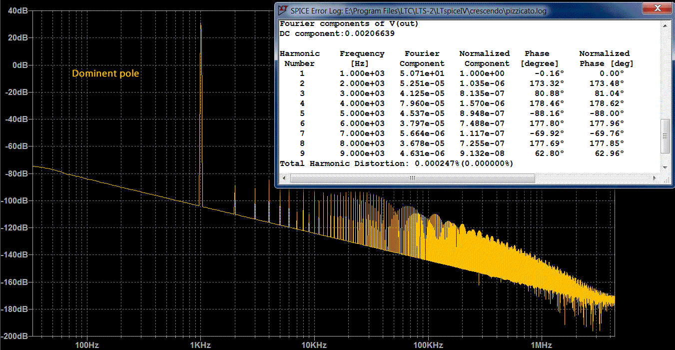

inclusive comp 1k
dominant pole comp 10k ?
Based on close stability margins, as I said.inclusive comp 1k
ok, but why do you compare 1k and 10k thd ?

My mistake. Wrong image. I apologise. (see attached)ok, but why do you compare 1k and 10k thd ?

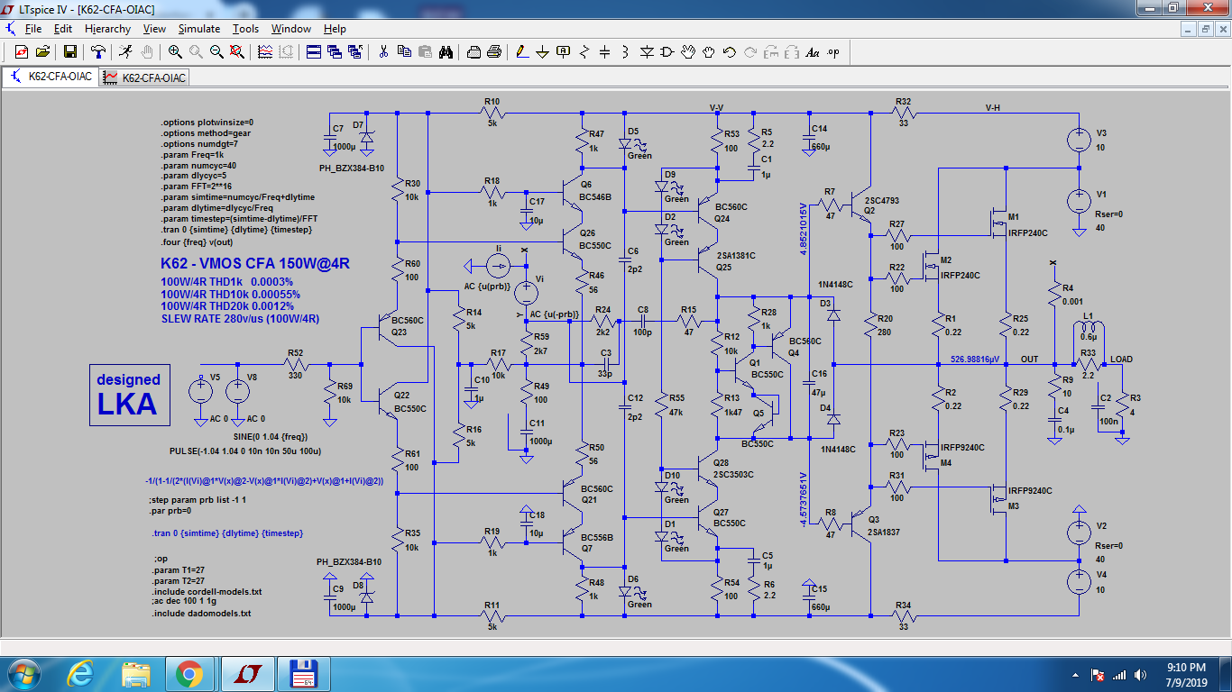

He he ;-) Congratulation.check out my output inclusive compensated CFA : simple, cheap, linear, fast and working(measured)
true CFA, wide OL BW 20kHz, LG20k 63dB
higher impedance feedback network than usual, DC blocking cap
In confidence, I want to explore various aspects of closed loop CFAs to try to figure out theirs various impacts on listenings impressions.
Ultra low distortions VS normal ones, flat open loop in listening range with reduced gain at LF VS constantly descending ones with high gain, ultra high slew rates VS good enough ones. ETC. See what I mean ?
Comparing your nice amp with the 200W Dadod one, with a similar OLG curve and similar SR should be interesting to figure out, everything else quite the same, if there is any advantage to gain 10 DB of HD beyond your pretty good one.
Easy to increase the distortion of mine to the same amount than your to compare the OLG curve influence (if any).
All those questions about thresholds of audibility and impacts on the listenings impression need to be answered: Then we could stop hunting against ghosts and killing dead horses, to concentrate on what really matters the most between the members of this trio.
Searching to know better about thresholds of audibility.
(Apologize for my poor English)
PS: Is your sim file available somewhere ?

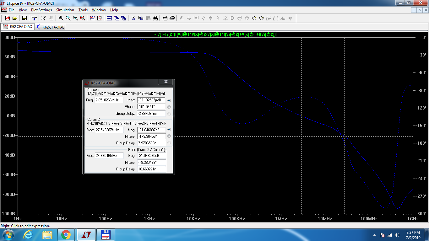

Clarification of goals is needed. A a slow input stage is not compatible with faster slew rates which you indicated was desirable. Note the difference in performance at 20KHz.
The 1.5K input resistor causes peaking and noise. Both versions have PM 83 degrees.
My personal curiosity is not to be confused with improving this project for the community ;-)Clarification of goals is needed. A a slow input stage is not compatible with faster slew rates which you indicated was desirable. Note the difference in performance at 20KHz.
Thanks a lot, *a lot*, spladski, for this contribution.
Nice one on the bandwidth. Probably lot better on slew rate, but I got a problem running square waves. Did-it work on your computer ?
I Know for the input transistor. But how to filter the input without adding an awful charge to the preamp ?
There is a design anomaly. The second stage transistors vbe is dependent on the first stage transistors vbe. So unless the vbe is tightly matched between the N and P devices, production build will be problematic.
The simple solution is to create some vbe headroom for the second stage. Distortion is not as good but at least it is now deterministic. There may be a better way of doing this.
