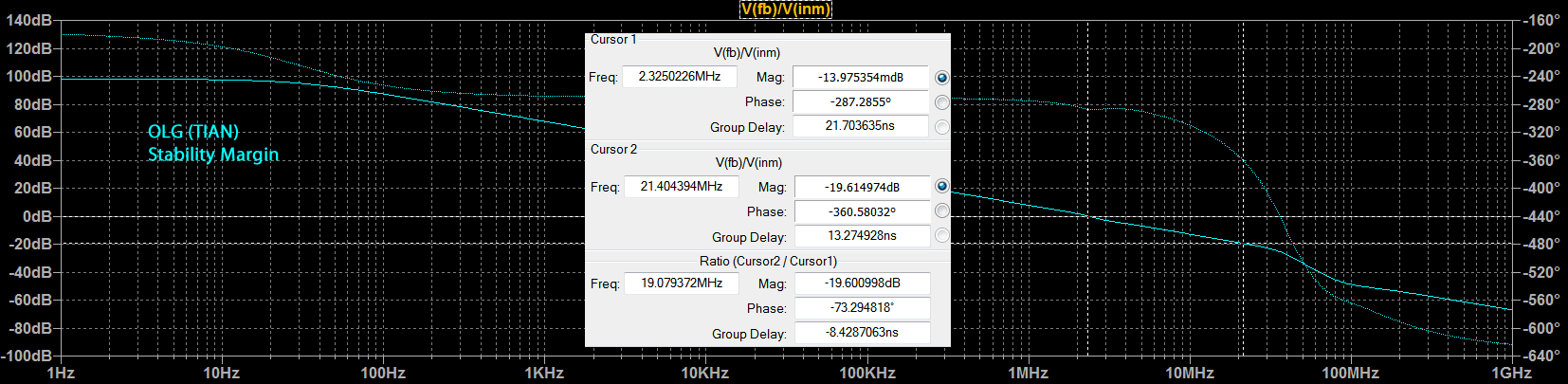

You are very affirmative, man.For better power supply rejection blocking caps C14/15 should not be tied to gnd, but to the corresponding supply rails.
Miller caps should not end at power out, but at the collector of the VAS. This avoids stability issues caused by the output devices.
Considering stability in the critical range of 10~30MHz there must be some room for improvement - for instance driving the gate with an emitter follower without gate resistor is sub optimal.
Limiting gate voltage at the emitter outputs may destroy these BJTs and the zener when overdriven.
For PSSR, as I said, it is on the way. Will try this, but I'm unsure; C1 is here for the current source and input stage.
For compensation, you are TOTALY wrong. Yes it is a little tricky, but reduce distortion by a 10 or more factor. Just try-it. I do-it since 1980. And there is two reasons for this. First, it add feedback at very HF to reduce the OPS crossover distortion, second, it do not add a load to the VAS.
About stability, Don't you think margins are good enough ?
Gate resistor ? I removed them on purpose. The feedback loop is pretty complex, considering poles and phase turns. And this added both margins and
diminished distortions.

Man about this compensation scheme, It seems I'm not the only one to use-it now., it is no more esoteric. Make a quick search for the various "inclusive output compensation".Reminds me that at this time I designed 5kW LatFETamps for the German Navy that worked successfully over the years. 😀
Anyway, you have the SIM file available for now: easy to see the difference and discover something.
What was exactly the purpose of your input ? Stability margins are not good enough on your point of view ? Can-you provide a way to reduce further so low distortions? If yes, please, provide your solution with better simulated results.
I think, for the benefit of all, that we shall progress in a practical way: Every suggested change to come with simulation results that will prove a real improvement.
A collaborative WORK, not useless discussions on the angel's sex.

My friend Nyquist and me were very surprised by you care about phases behaviors at less than -10dB under and after the 0dB open loop gain.
I thank-you for your "flaw". Now, you just have to come back with proof of your strange assertions with better results. (stability margins+distortion numbers, good luck)
Sorry to say this, but if somebody between us don't want "to know", it is you, not me. The traditional compensation between base and collector of the VAS is known and experienced since 60 years by everybody, me included. An elementary basis.
