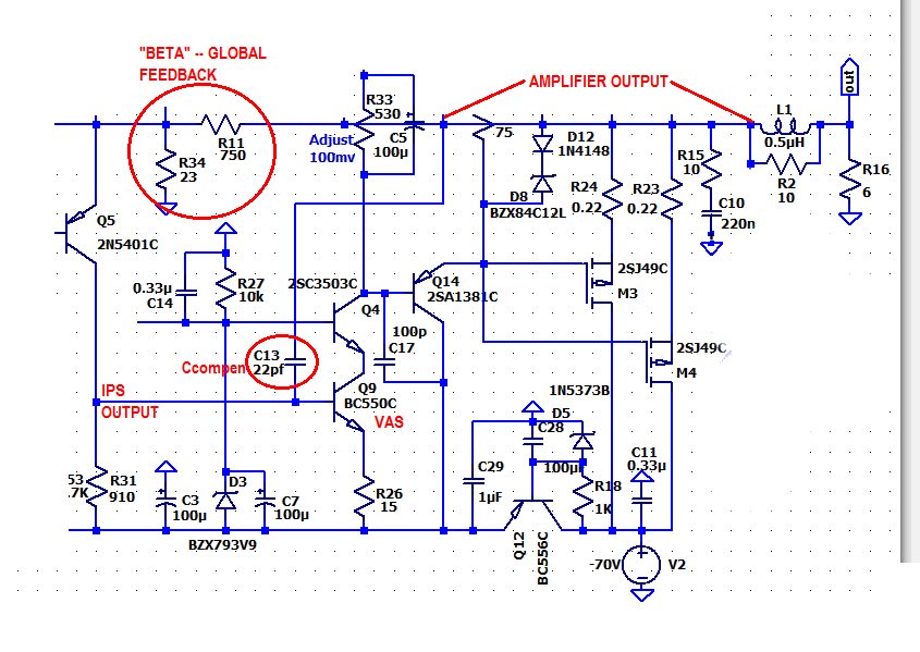

1) No need for series resistors in front of the gates?
2) Possible to move the gate clamp zeners to the bases of Q13,14, add reverse bias as Bob Cordell has shown to do in DH-220C to reduce their capacitance.

Do-you think the diodes capacitances are of a huge importance in front of the huge ones of the power fets ? And what about their load added to the VAS ?

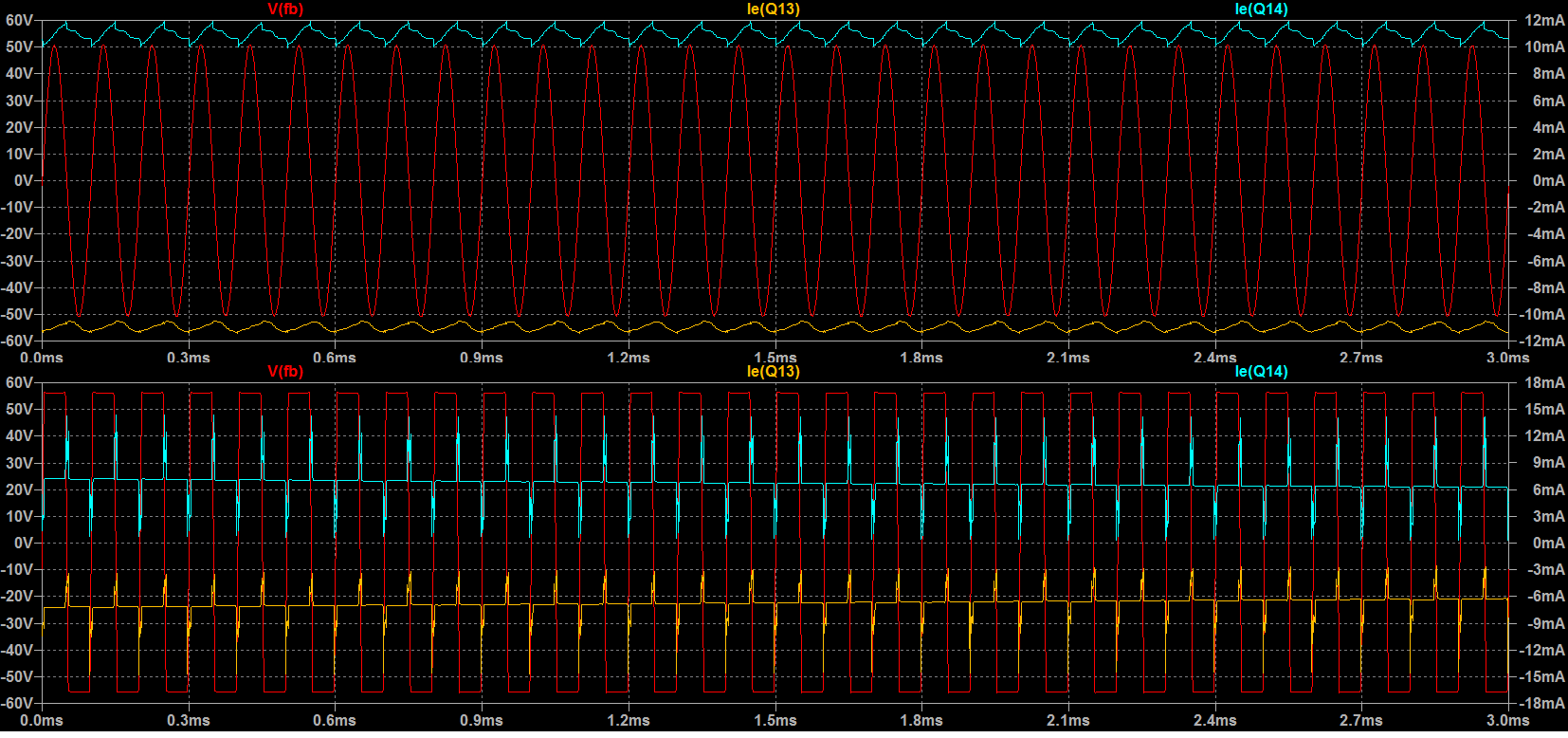

Point 2 is one of the flaws you would not hear from me. I will try to explain:
The clamps are to prevent the gates from too high voltages.
To simulate clamping, a high gate voltage must be reached.
Normally, this will be not the case.
You have to reduce output impedance to 3 Ohms and overdrive the input of the amp.
Output current is getting high and gate drive rises above 10V.
When the clamp zener begin to conduct, nearly unlimited current can take in and will release all the magic smoke of the zener and the bjt that drives it.
This scenario can be seen on the screenshot of the simulation.
Just an option, or a trade off, everyone has there ideas of how to do it and for what reasons.Do-you think the diodes capacitances are of a huge importance in front of the huge ones of the power fets ? And what about their load added to the VAS ?
I think voltwide makes a good point when the zeners conduct, what happens, with a current source driving them it is not destruction but the drivers can source way more current, so if/when the zeners turn-on and conduct, will they survive the condition?
Rsavas, I tried both solutions (crossed Cordell like and not crossed). HD @ 10kHz increase (as expected) from 0.000512% to 0.000913 in both cases. Near 5dB.Just an option, or a trade off, everyone has there ideas of how to do it and for what reasons.
Do you see any advantage to reduce performances in normal conditions for a non real danger ?

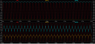

See attached: Top -> normal condition -> 1.7V input, bottom ->10V input.
Signal+ emitter currents of the drivers.

Well the small difference in performance (in sim) vs the unlikely chance that the zener diodes do conduct, in your case the diodes may blow vs in Bob's case they do not, I think I would take the performance hit vs a failure. For the customers case where he grossly over drives the amp.? 🙂Rsavas, I tried both solutions (crossed Cordell like and not crossed). HD @ 10kHz increase (as expected) from 0.000512% to 0.000913 in both cases. Near 5dB.

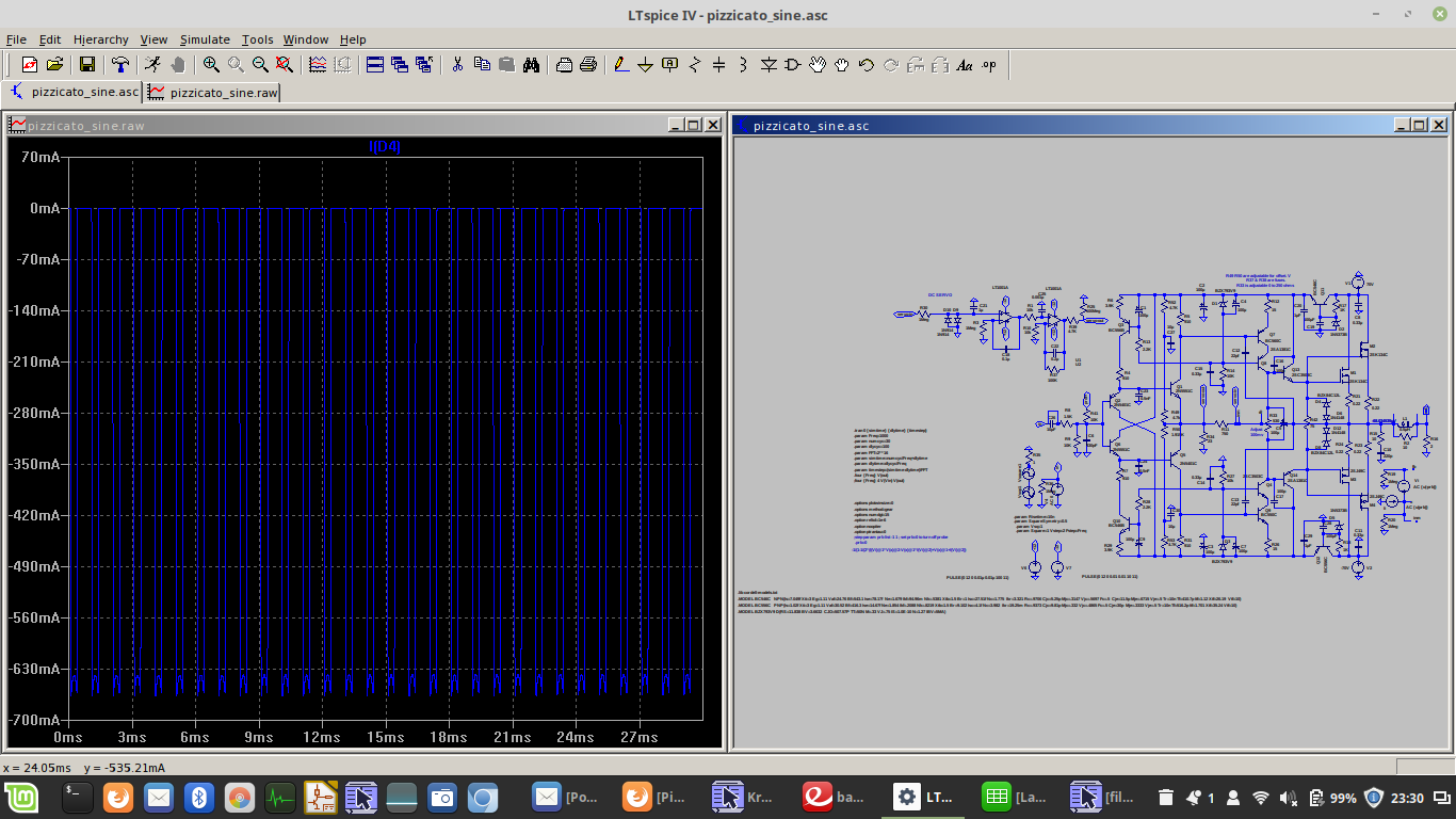

The design on paper seems very good. I did check a few things to see if the circuit could tolerate changes. This is for coping with production spread. An issue was encountered with the input transistors. When these were changed, the results were not good. I don't know if it is just me and my version of LTspice, still at IV.

The DC balance seems very sensitive to change of input transistors. So it needs to be re-balanced, then different transistors work. Also increasing input current to 2mA helps. Running beyond 150KHz indicated some kind of current starvation.

Absolutely. (Thanks for your interest)The DC balance seems very sensitive to change of input transistors. So it needs to be re-balanced, then different transistors work. Also increasing input current to 2mA helps. Running beyond 150KHz indicated some kind of current starvation.
A delicate balance between distortion and stability margin. The reason I chose such a small current (800µA) for the input stages is that I like that an amp reduce its bandwidth when the volume increases for its listening character. This, as you noticed, is paid on the slew rate.

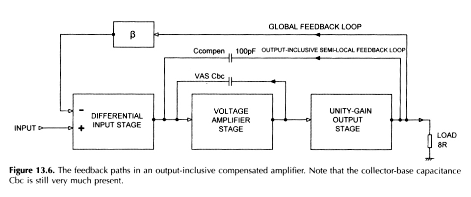

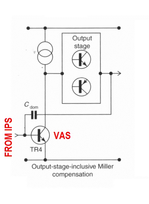

The compensation arrangement reminds me of "Output Inclusive Compensation" as discussed by Scott Wurcer in his 2013 talk at Burning Amp, on the topic of the history of Discrete Opamps link.
Douglas Self's book discusses Output Inclusive Compensation in the 5th edition (attachment 1 below), and at greater length in the 6th edition (attachment 2). Compare those figures to the LTSPICE schematic of the present design (attachment 3).
At least to my eye, the resemblance is striking.
