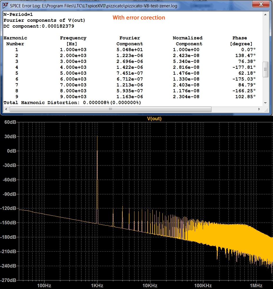

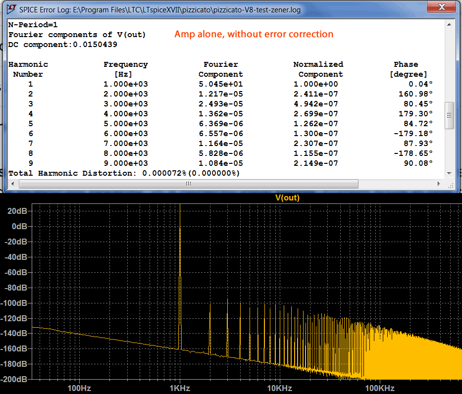

HD 1000 Hz, without error correction: 0.000072%
HD 1000 Hz, with error correction: 0.000008%

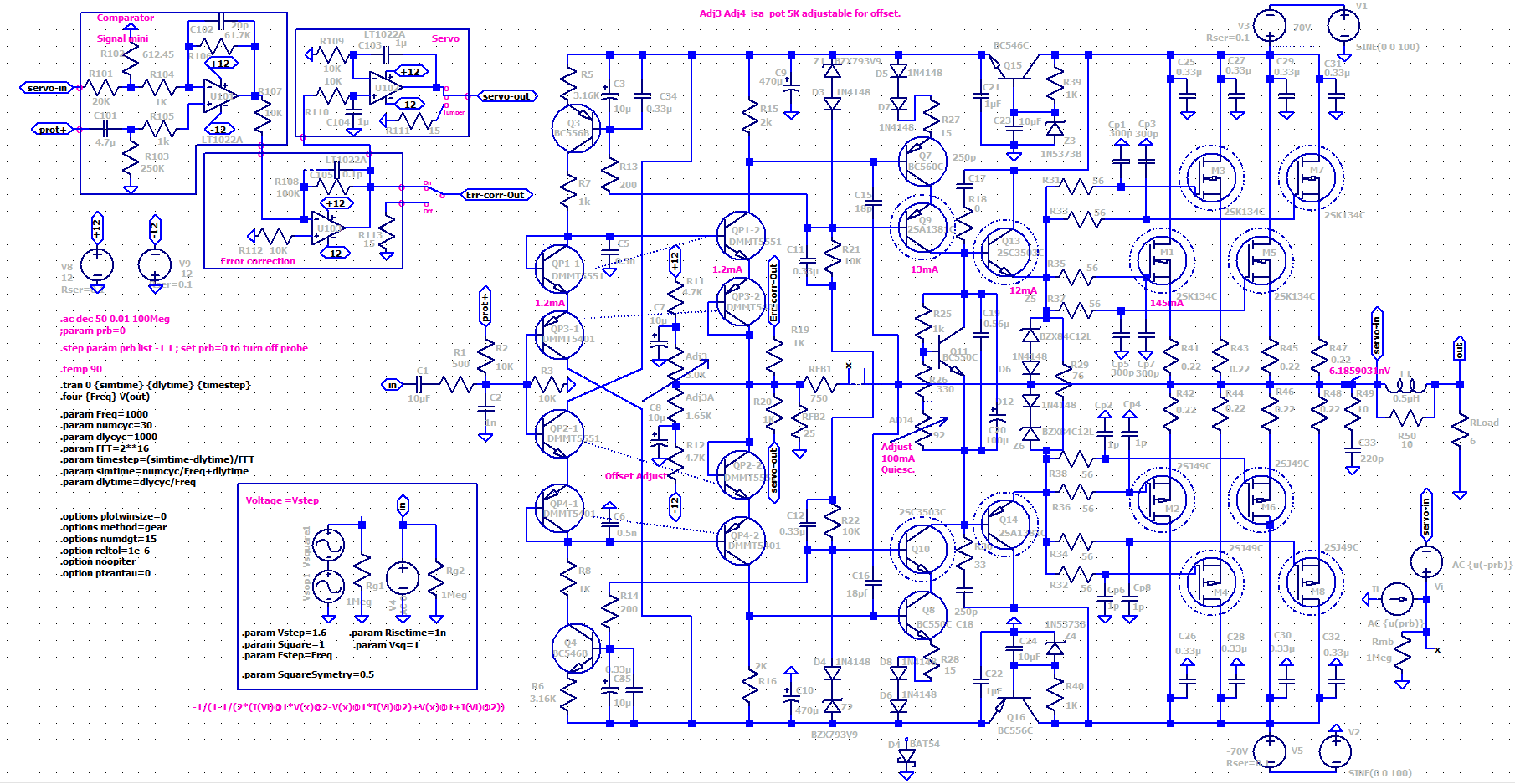

Thanks to Spladski, and its idea to use matched transistor pairs both as transistors and diode, because they are matched at <2mV VBE, thermally coupled in the same chip, and with my idea to balance the two stages with them, we have succeeded to get rid of all the possible problems that many members had underlined.
The same PNP and NPN pair is now used half in the first stage of the input stage, and the other half in the second stage, both NPN and PNP in each half stage, the two stages are now totally locked together, with the same current provided by a current source. No more tuning or adjustments requested apart quiescent current, offset voltage and error correction max rejection.
Theory of operation.
The input signal is filtered by R1 & C2 to ensure that it will never exceed the slew rate of the amp and to remove unwanted HF parasitics, before to enter in the QP1-1 & QP2-1 transistors working as emitter followers. At their output, it crosses one transistor QP3-1 & QP4-1 mounted as a simple diode (base-emitter). The DC of the signal is, now, the sum of the VBE of QP1-1+QP3-1 & QP2-2+QP4-1.
The current of this stage is fixed by the current sources constituted by Q3-Q4. The base voltage reference is fixed by a Zener Z1 & Z2 in serial to one diode (D3 & D4) for temperature compensation.
This stage is out of the feedback loop.
The second stage of the input stage use the same pair transistors to compensate in reverse order the initial VBE. AS they are matched with the first stage and thermally coupled, the compensate exactly this VBE: VBE (QP1-1+QP3-1) = VBE (QP1-2+QP3-2). And same thing for the symmetrical bottom part.
The collectors of QP1-2 &QP2-2 will be at ground DC: No need for a cap in the feedback path.
Now, as the feedback is applied at the emitter of the second stage transistor, this one is not used as an emitter follower, like a pure diamond, but amplify the input signal: their collector output use the resistance R15 & R16 to achieve this. The current across them (the same as the one o of the current sources fixes a voltage applied to the base of the Cascoded VAS : the current of the cascode is fixed by this voltage. Hence, the use of two diodes DA5 & DA7 to fix-it around 10mA. They are part of the thermal compensation as well. The gain of the VAS is fixed by R27 & R28 resistor.
All what follow is classical: A transistor used to fix the quiescent current in the power devices, witch is part of the thermal compensation, a classical driver (his current is fixed by R29) and the power devices.
The Lateral power FETs do have a mismatch of their gate parasitic capacitance (900pf VS 600pF). The CP1-> CP7 are here to approach them.
The resistances R31 toR 38 are gates stoppers. On the schematic, they are 56 Ohms, it can be increased to 110 or 220 Ohms with no major changes.
The quiescent current of the power FETs is fixed around 150mA. That the approximate point where they are thermally neutral, after what they have a thermally negative curve: this tend to stabilize this quiescent a little more and gives a good margin in class the class A operation of this Class AB amplifier.
Theory of operation: Error correction and servo.
The principle is to subtract the original signal from the output signal of the amplifier. This is done by the U101 where R102 is used to adjust their levels in order to get the best levels /match before this subtraction. This is done first minimizing the output signal, then trying to get the original frequency at 90° of phase.
In an perfect world, the output of this subtraction contain only the distortion and the offset error.
This little remaining signal (~3mV) is amplified by U103 before to be applied to the negative input of the CFA power amplifier. This add 10dB of gain to the feedback, without adding loop gain.
The same "error only" signal is integrated in U102 by the C103 capacitance that reject all remaining frequencies of the audio signal and only out the DC error that is applied again in the - input of the power amp.
That's a new kind of servo. With the obvious advantage that the musical signal being near suppressed, both by the subtraction and the integrator, no sonic character of the Op Amps will be heard, and that the margin of the servo is increased: faster and more powerful. The resulting offset is in the nano-volts.

Indicate test points and jumpers Big diode on output, MURS3230 type Wattage of all transistors and resistors Indicate the type of capacitor, i.e. polyester or otherwise Op amps on ips or not, think so but want to be sure.
Draw a line to designate what goes on small board Source of + - 12 volts and topology I wanted to create a more or less output board that could accommodate a standardized ips board to be able to do comparisons of different approaches to design typologies.

Krisfr, If you have LTSpice, most of your questions will be answered in it about components, with a right click on them from the .as file. I will be there to answer your questions.Indicate test points and jumpers Big diode on output, MURS3230 type Wattage of all transistors and resistors Indicate the type of capacitor, i.e. polyester or otherwise Op amps on ips or not, think so but want to be sure.
Jumpers and test points will be indicated as well.
Middlebrook is implanted on the AS file. Don't hesitate to ask me by PM if you need more precision on how to use-it as well as Tian.
I do not understand "Big diode on output and MURS3230" as they don't exist on the schematic. Please, could-you explain ?
Nothing special about +&- 12V. The same regulated PSU will be used for the OP amps. I think it should be better to have them on a separate board. This board could contain the logic for the protection... or not...as you feel.
I don't think it is possible to use the input stage on other VAS, not specially designed for-it, as the voltage at R15/R16 fix the VAS current Even a small change of their values can drive-it out of limits. Only the Output stage is classical... as long as they use MOSFETS. On my opinion, it is a bad idea to build this amp in several boards. Better to try to optimize the all amp circuit.
We can discuss all this more deeply and look at the pro and cons.

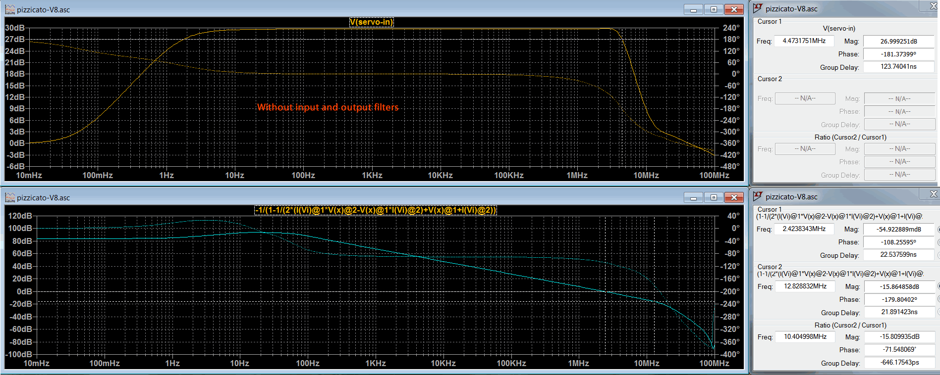

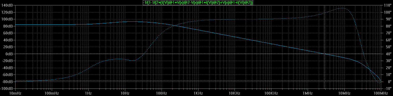

Working on compensations, I had this beautiful result with Midlebrook method. (See attached) BUT, when I run the trans, it takes hours like if something was not correct (oscillations?) I have my CPU hot before the end, don't know how it will end. I need help from the LTSPICE experts.
Can't we lie on the Midlebrook sims, or sir Niquist was wrong and I have to prepare a paper for the academy before to fire my moon rocket? Or is-it just that LTSPICE has too much work on phases at trans. simulation and it will end nicely, as expected?
Thanks in advance for your answers.

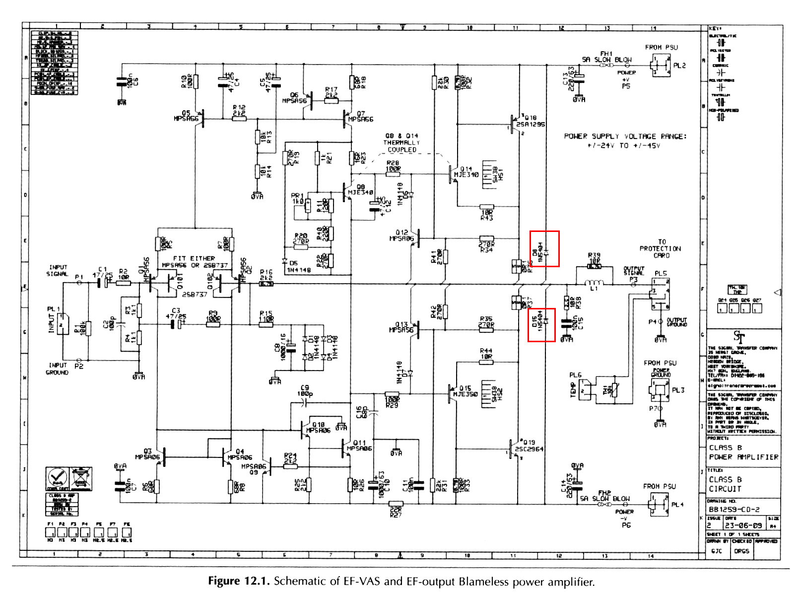

Run a quick simulation of the amplifier driving the worst case reactive load model of a two way loudspeaker with crossover. Apply the worst case input waveform. Monitor the "OMG Something Is Wrong" current flowing in these simulated catch diodes. Finally, apply a conservative safety factor when spec'ing a real diode. Done.
Self 6th edition Figures 14.28 & 14.37 offers advice.
So does Cordell 2nd edition Figure 22.3.

It should be nice from you to post your "worst case reactive load model of a two way loudspeaker with crossover" schematic.Run a quick simulation of the amplifier driving the worst case reactive load model of a two way loudspeaker with crossover. Apply the worst case input waveform. Monitor the "OMG Something Is Wrong" current flowing in these simulated catch diodes. Finally, apply a conservative safety factor when spec'ing a real diode. Done.
It's not my schematic. It belongs to Douglas Self and Bob Cordell and can be found in their book(s) on the pages I indicated. Perhaps 30 minutes of internet search engine work might find the same or similar schematics online, in case your book collection is housed in another building.
