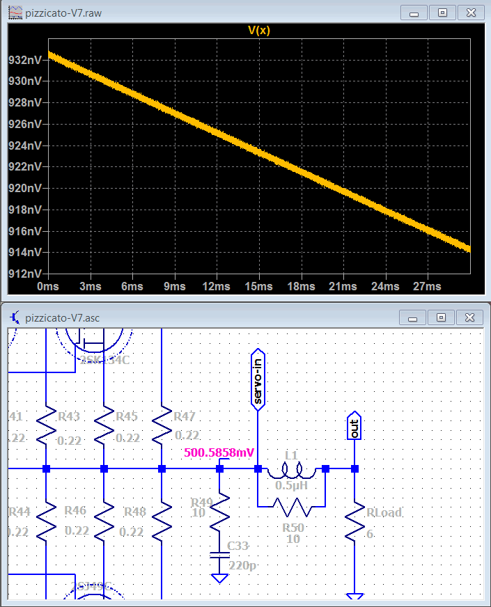

LTSPice has some strange behaviors. Looking at the offset at various temperature, I was unhappy with the offset variations seen in AC simulations. Attached, the result of .trans with the servo on at 50°. Generator set to 0V, both windows looking, in the same time to the same output of the same simulation. Ouf ! The servo is working damn well and we don't have to worry.
And, as, in this situation, the servo output is at some 667mV, and the opamp allows some +/- 11V, we still have A LOT of margin.
I was probably very tired the first time I tested, or I tried with other devices. The spladski version as it validate perfectly too the tempco: -10° 130mA 0 ° 109.7mA 50° 51mA 70° 44mA 75° 43mA No problem neither with the VAS from 13mA to 5.6mAit had seem to me your version was increasing the power device current with the increase of temperature ?

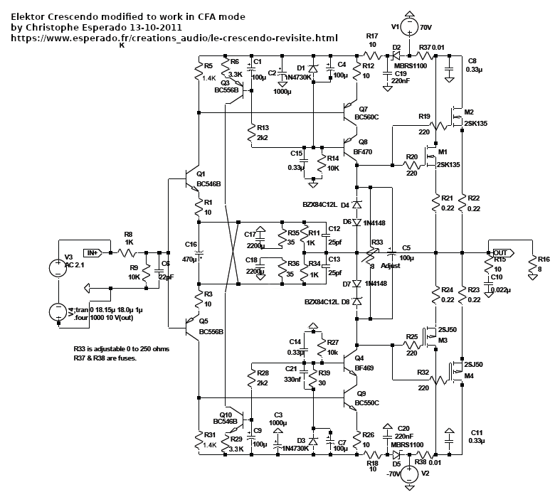

No surprise. I simulated, two years ago, this crescendo, and, when I had this idea to explore a CFA with high loop gain the cascode was a requisite, so I started from its asc file to get rid of the VAS/ power stage re-design, saving time. It is a very classical implementation.perhaps your former life/alter ego?![]()
But, again, the subject is the amp, not my person: I'm the real Professor Tournesol.
Usually, CFAs have low loop gain, and extended bandwidth while VFAs are the contrary. My question was to see what will happen if we try to mix the two, in order to figure out if the difference in listening impression between CFAs and VFAs depends on the slew rate/ extended low loop gain or just the current on demand.

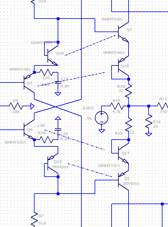

One little explanation about this. As we use a diamond like topology to get rid of the VBE voltage difference between input and feedback (and the electrolytic big cap that usually comes with) but with max gain, all VBE mismatches are amplified by the gain. And, as the current in the second stage is set by the emitter voltage of the first one, it will vary with the VBEs of both. In other words, the current of the first input stage is set by the current sources, but any missmatches between this stage and the second will impact the current in the second one and the VAS. We need some margin because, if the VBE of the transistors second stage is higher than the one of the first transistors, the second one will not conduct. And, if it is the contrary, the second will over conduct.
The add of a diode in the second stage ensure that the VBE+diode will always be higher than the first stage. IE, that it will never over conduct. And the adj1 & adj2 resistance to add the necessary voltage in his base to make the second transistor +diode conducting as we want whatever it happens.
The clever idea of spladski is to use a matched pair, supposed to have similar VBEs to reduce the mismatches. The second transistor, replacing the diode in serial with the second transistor emitter reduce the differences, as the two VBEs are now in serial in the second stage. IE any VBE variation in the first stage is reflected by the second transistor of the pair in the second stage The inconvenience is the variation of the second stage current, while reduced, still exists. Hence its change of the cascode to allow-it to accept this variation.
My solution is to simply tune the VBE differences with adjustable resistance to set the second stage current to 1.2mV whatever it happens.
VBE problem is solved, NO temperature issue. As I said, problems solved and "we end-up" with NO ISSUES. At all, because both phase and gain margins are good enough to make a very stable amplifier.
This gave-me an idea, expanding the spladski one. In the original schematic, the inconvenience we the need of closely matching the VBEs of the first and second stage NPN/PNP or PNP/NPN transistors. Working, but not user friendly. Supposing that the DMMT5401 pairs are closely matched on VBEs between their two transistors, why not using those pairs to compensate each others both sides ?The clever idea of spladski is to use a matched pair, supposed to have similar VBEs to reduce the mismatches. The second transistor, replacing the diode in serial with the second transistor emitter reduce the differences, as the two VBEs are now in serial in the second stage. IE any VBE variation in the first stage is reflected by the second transistor of the pair in the second stage The inconvenience is the variation of the second stage current, while reduced, still exists.
Attached a modified spladski schematic, not tested, just to explain. If VBE Q18 = VBE Q1 =X (one pair), and VBE Q2 = VBE Q16 = Y (second pair), we get VBE first stage = Y+X and VBE second stage = X+Y. And, as the current in first stage is fixed by the current sources, the second will be the same whatever X and Y mismatches. The best of the two worlds: Precise result and no tuning requested.

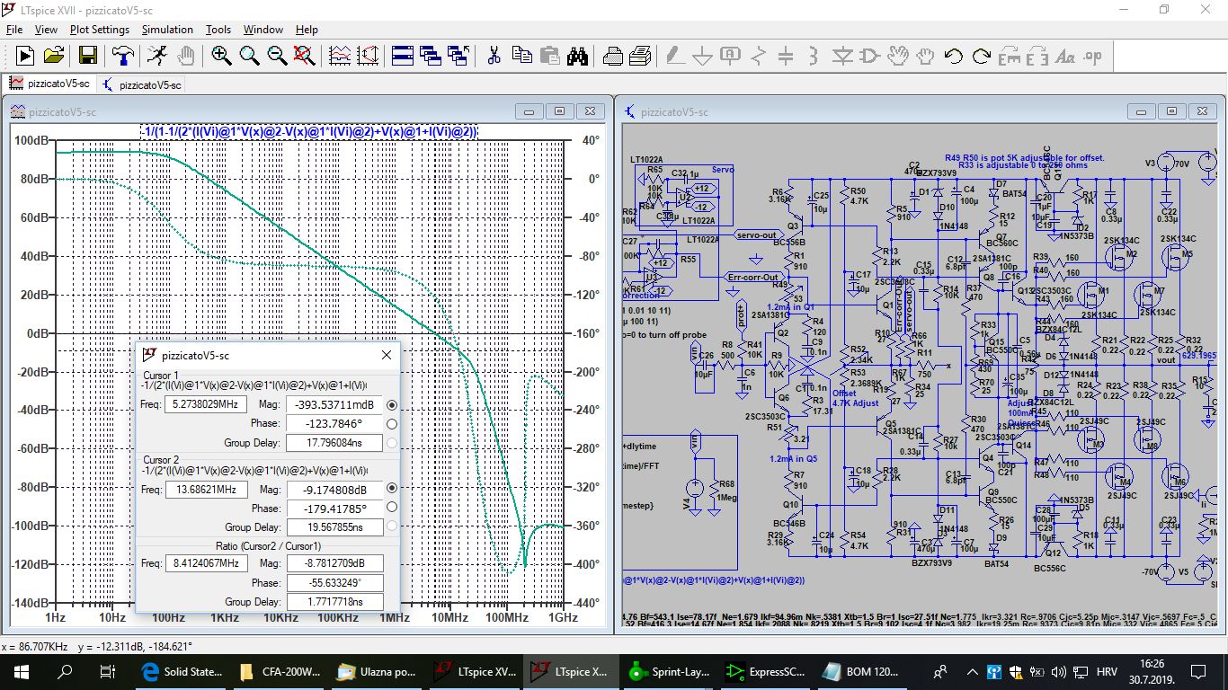

Just LG plot I've got and think PM and GM should be increased, bandwidth too.
daodad, I'm uncertain how to interpret your AC analysis plot. Does it indicate that the amplifier's open loop gain bandwidth product is (5.27E6 * ClosedLoopGain)? And therefore the closed loop bandwidth is 5.3 MHz? That's quite a bit higher than the closed loop bandwidths in, for example, Bob Cordell's book. Those mostly have OLGBWP of approx 10 MHz and a closed loop bandwidth of approx 0.5 MHz.
