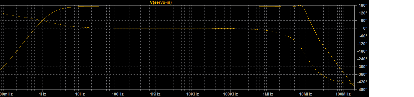

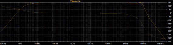

daodad, I'm uncertain how to interpret your AC analysis plot. Does it indicate that the amplifier's open loop gain bandwidth product is (5.27E6 * ClosedLoopGain)? And therefore the closed loop bandwidth is 5.3 MHz? That's quite a bit higher than the closed loop bandwidths in, for example, Bob Cordell's book. Those mostly have OLGBWP of approx 10 MHz and a closed loop bandwidth of approx 0.5 MHz.
This is Loop Gain plot (Open Loop minus Close Loop), and 5.27 MHz is ULGF.

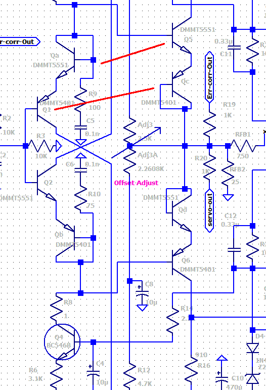

On the VAS side, may-be I was unclear.
My idea is to use, as an unique cooler a little metal vertical plate, crossing the board, on witch the four transistors could be fixed. So, you could just take care to align them. Q9, Q10 & Q13, Q14(on the V7 schematic).
Too Q11 ? but I'm not sure, this have to be verified in real world and an enclosure. I fear the amp could be over compensated. Q13 and Q14 do not need to be tied together, just cooled.
What do-you think ?
If you can tie together Q7 & Q8, why not ? But don't worry too much about this. We yet have a lot of gain in the front end plus a servo.

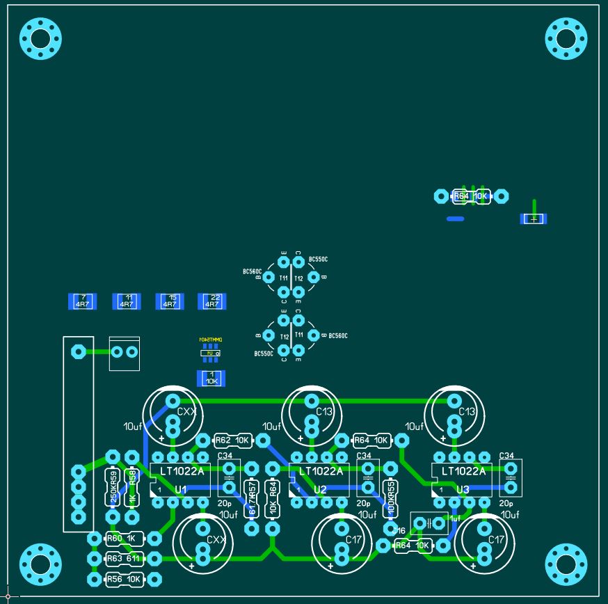

Here is my view of the first input stage PCB aimed at SMD although the parts can just as easily be through-hole.
The transistors are the MMBT5401 and MMBT5551 from Diodes Inc. These are not clones of the 2N5401/2N5551 as with other manufacturers. They did a good job of creating well matched complementary behavior. The design was consolidated to use just these parts since there was marginal difference using BC846/BC847 as current sources.
The temperature compensation has had further tuning. We will see in practice if it works. If this version validates then it will be of benefit to the wider community who may not like SMD or wish to use parts from their parts bin.
The PCB can be switched from the original config to the cascode version with jumper links. A BOM suggestion will follow. There will be a second input PCB that uses the matched pairs. I don't know about the connector scheme Rsavas refers to. Maybe he can provide info.

Thanks Spladski, I will be looking for the BOM. I am gong to keep the op amps on the IPS if there is room. Your asc is excellent for preparation of the PCB. I may draw it up in SPlan as it gives a BOM as I go. Yes there should be some more input on the connectors. I have to investigate more to be sure. Thanks
Please show were the adjustments, resistors, jumpers and test points are needed on the op amps. Will it be the same for both designs? Also the power sources for them. Thanks
The only test point (will be indicated as TP on the schematic): Output of the first op amp.
I think we could use a dual OPA for U01 & UO3 and a single for U02. If there are several versions (but I don't see any interest anymore), yes, they gonna be the same.
The R103 will be an 1K adjustable, preferably multi turns.
The 2 positions switch (on/off) indicated on the schematic , I don't know if it should be a good idea to offer-it as an external switch for the user can chose error correction or not as a feature for he could chose what he prefers in listening ?
The return line from the servo to the amp need to be disconnected and its 1k free connection on the amp to be grounded, just the time for the user to adjust the offset, then reconnected. Jumpers here could be a good option ? From the 1K (Servo out in the amp) to ground or to the servo out (of the servo op amp.
