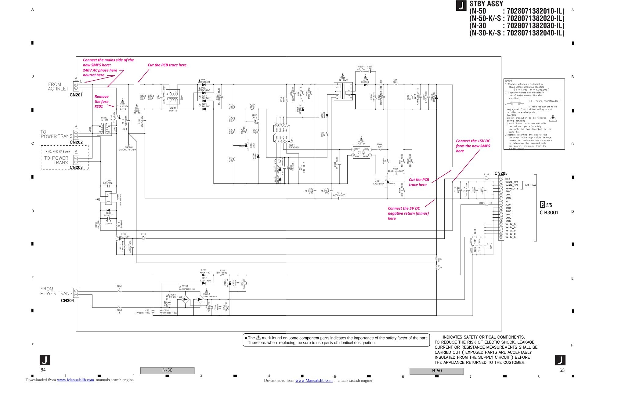

If you will mount a new PSU: please connect the new 5V SMPS after LF201. Also leave fuse F201. Remove D202 ...205 and use the pads of D202...205 for the 230V AC connection of the new PSU. Use a jumper for TH201.
If you remove R235, C230 and D208 you can use the cathode pad for the new +5V and you'll have extra filtering plus overvoltage protection. Remove now superfluous parts.
At least that's how it looks optimal on paper as the new PSU will have a filter working both ways and it will be fused separately. I haven't touched any N-50.
I think I will not mount any new PSU. If the NTC does not do the trick I will use the following workaround:
Power off AC completely via an external switch. Power on AC and directly push the main switch on the device. Most oft the time it fixed the starting problem at least what I experienced the last days. Where I used the device it was permanently connected to AC and for sure this leads to permanent power on TH201 and the switching IC201.

There's a mains filter and a fuse on a new SMPS - no need to double up by using 2 fuses and 2 filters... that's just silly.
If you ever decide to get an SMPS - just do it as per the photo I attached.

Just another thought.... you could also use an external wall wart 5V power supply and then just feed a twisted pair through a hole somewhere on that N-50... to provide an external 5V _STB to CN205. That will also work. The unit will power up okay.

Sigh, basic schematic reading... Near the optocoupler.
1. It is important to know if you always have 5V at the pins otherwise you are looking in the wrong direction. Do you have 5V?
2. If so what happens with the relay?
3. Are you sure pin 1 of CN205 gets a voltage?

I just checked again the voltages:
  • 5V available
  • relais always switches
  • pin 1 3V
But device does not power on (now in the living room at 25°). If I go back downstars to 20° it boots up. It is really strange. No clue :unsure:
