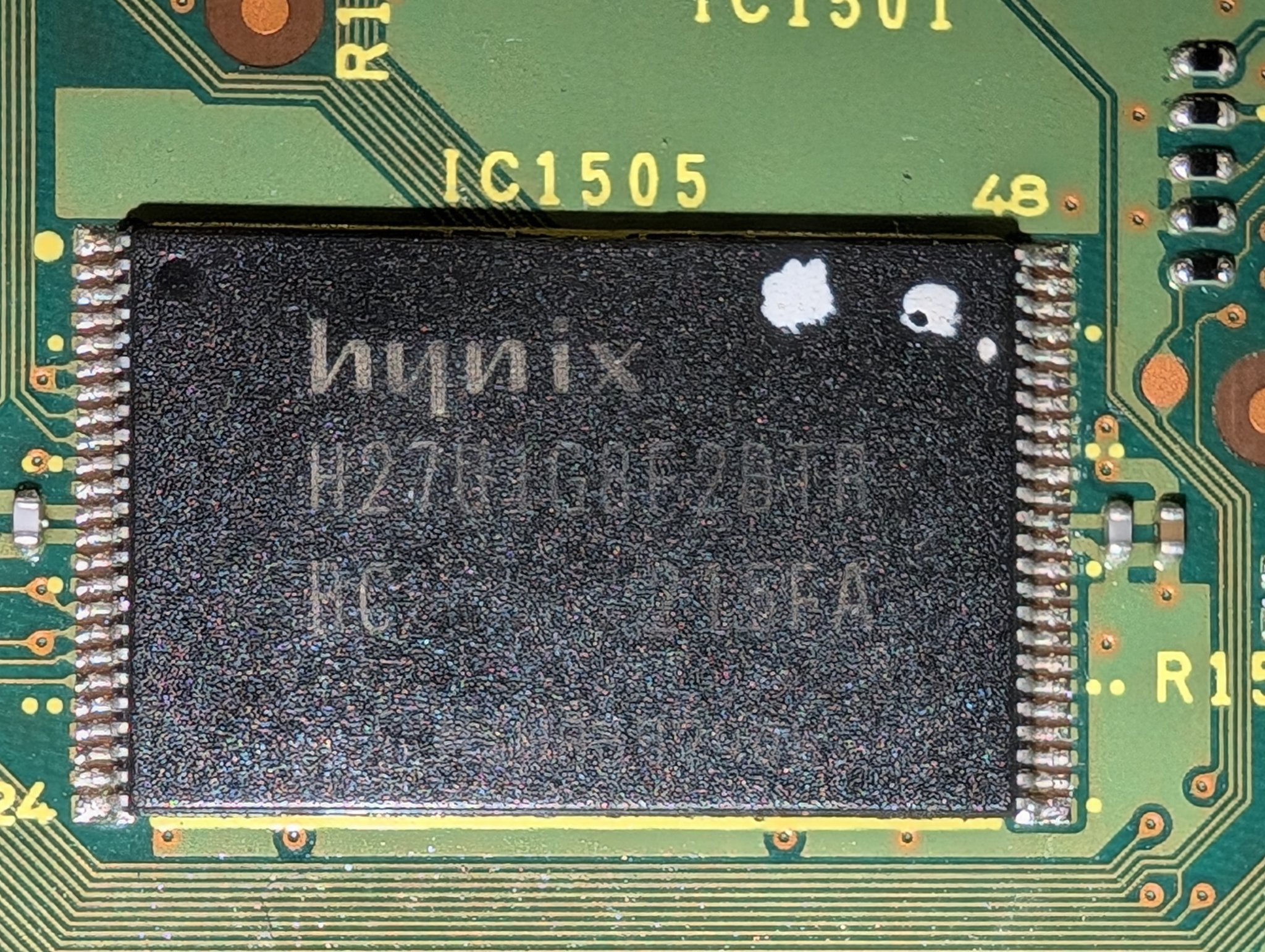

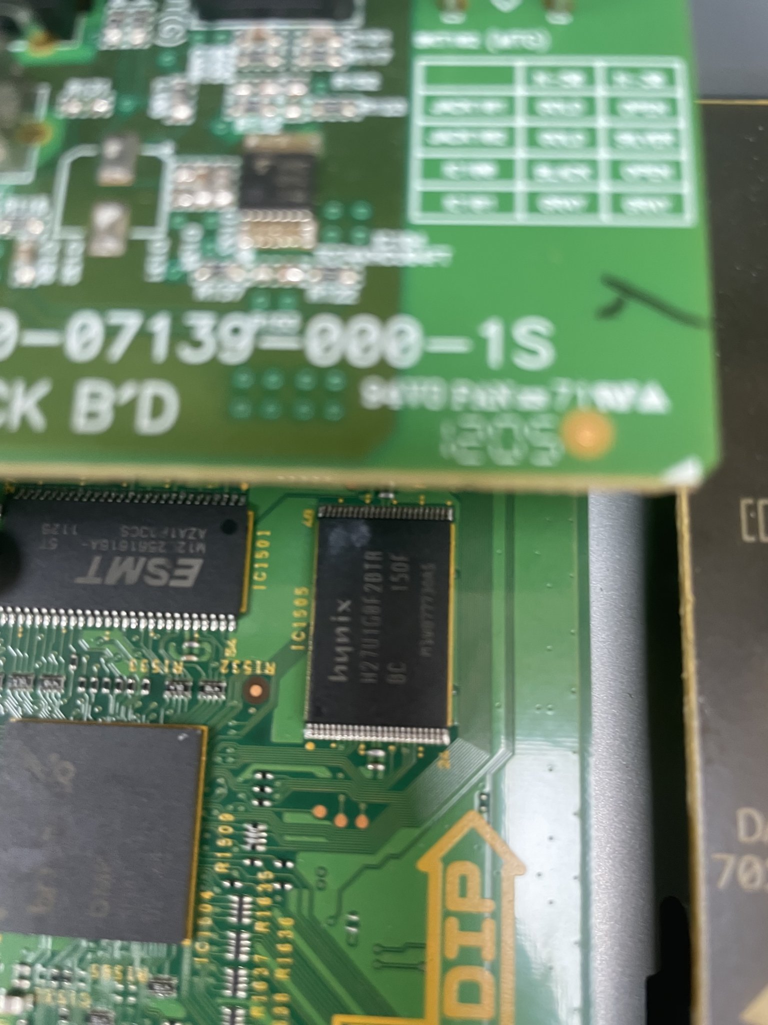

I have the same problem with my N30 where the Blue light keeps blinking slowly. I tried putting it in the fridge for a while and it booted up. I saw the post from herfrost and tried freeze spray on IC 1505(see Pic). I was able to get it to boot up consistently by cooling IC1505 down. I tried soldering The leads but that didn't work. The chip is available on eBay but my understanding is that this is flash memory and the firmware resides on this chip so I would not be able replace it without it being programmed first.

This is a thing to remember when it concerns defective Pioneer N-30 and N-50. Nasty error. Probably the main fault mode for these devices and obviously a hard one to fully diagnose as not many expect flash memory to die.
as a nice watercooker.
Actually flash cell charges fade in time. Some vendors even specify minimum data retention period for unpowered devices. But SSDs are designed to continually refresh their data when powered on. I do not know if simple flash storages do that. If not, it may be possible the charges drop below noise level at normal temperature, and cooling the chip down makes the data become readable again (for a while).as not many expect flash memory to die
OK but this audio player is one of the few where this happens like that and such in a relatively short time. Tried a few dozen and never had any of them failing. Apparently bad sectors in these Pioneers. From what I see when looking at secondhand websites is that they all seem to die. Maybe because of a programming imperfection or specific issues like high internal temperature or too high supply voltage!? Who knows. I have videoplayers that write updates on a two day or sometimes every day interval to emmc and they don’t have issues in years. In fact I have never seen this since a long time (except with SSDs and of course USB flash sticks).
And I suppose this device reads way more than it writes to flash. Strange issue.
