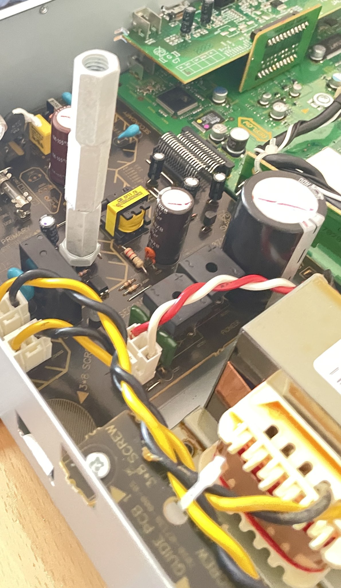

It is a temperature problem. I put the device in the fridge 🙂 and at 8° it works reproducible fine 5 times power on/off (I tried). Any ideas where to continue searching?
How curious. Perhaps there is a dry/bad joint somewhere around the area you suspected the original fault, which contracts and makes electrical contact at low (eg 8c) temperature, and at higher normal room temperature it expands and breaks the electrical contact?
Yes, it is strange. Now I'm cooling the IC FM260N with a piece of ice. After that I will put the hole power board back in the fridge, to see if the problem is really on this board. At the moment I'm focussing at the power switching IC. at least as this area was heated again after the fridge the problem occured again. So let's see🙂 What I also did: soldered all the parts on the power board again. Did not help so far.

I could not believe in another board so I gave it another try. Focused again on Fm260n. As the unit was on room temperature it didn't come up.
Cooling the Fm260n with a screw (over night in the fridge/see attachment) the device booted normally. So I really think that it has to do with the power switching IC. As it is really difficult to find Fm260n I was looking for a replacement part and found via a Portuguese forum (https://eletronica2002.forumeiros.com/t178443-resolvidoci-fm260n-alguem-sabe-o-substituto) that Fm260n = dh321. So I bought 5 pieces on Ebay für about 3,50€. So keep the fingers crossed. I will update here 🙂
Good detective work and perseverance, and ingenious use of that metal bolt for fault-finding 🙂
Fingers crossed the dh321 chip does the trick
Thank you. I just replaced the IC with a socket to be prepared for next week when the replacement part arrives. Inserted the Fm260n in the socket and gave it a try at room temperature. Unit did not start. Tried to cool it down with the screw for about 5 minutes and the device came up. So looks good so far 🙂
