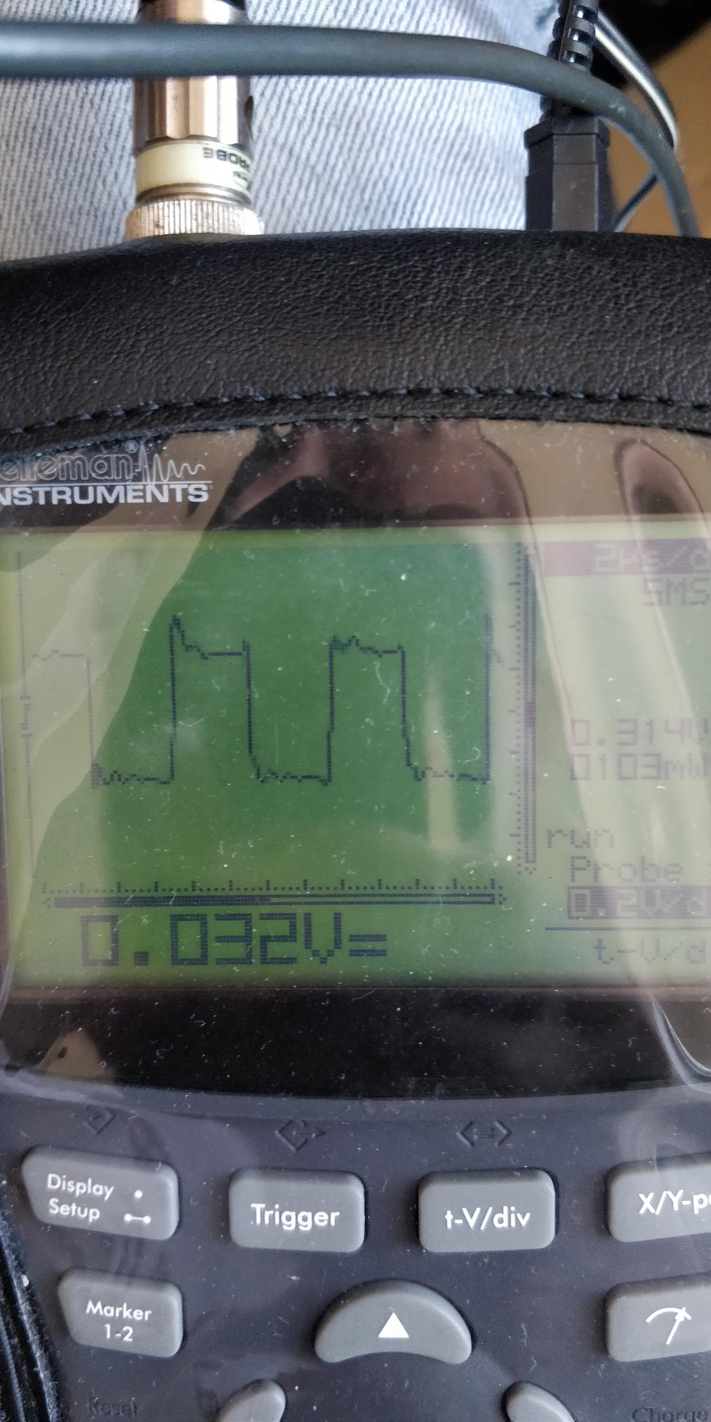

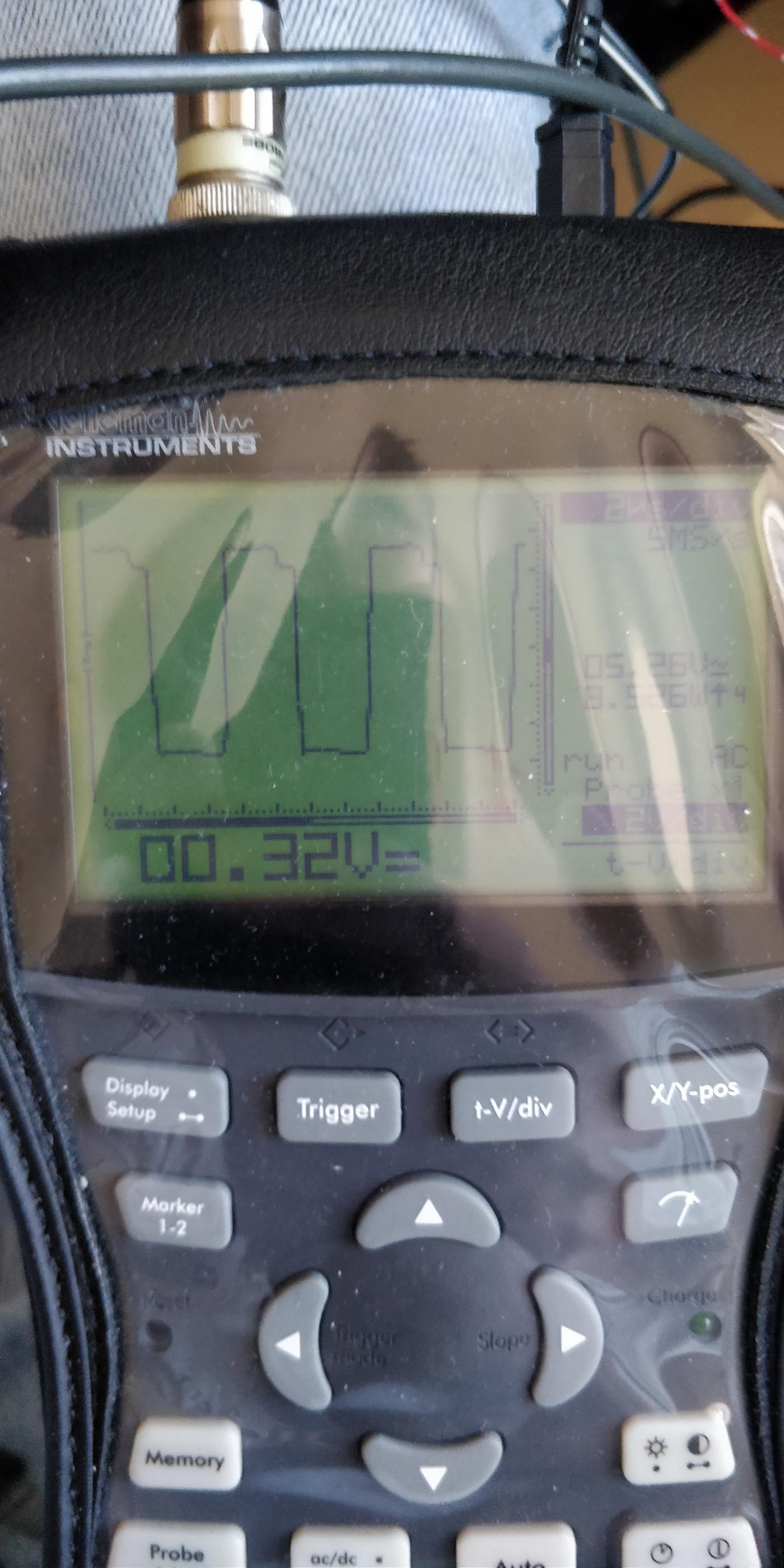

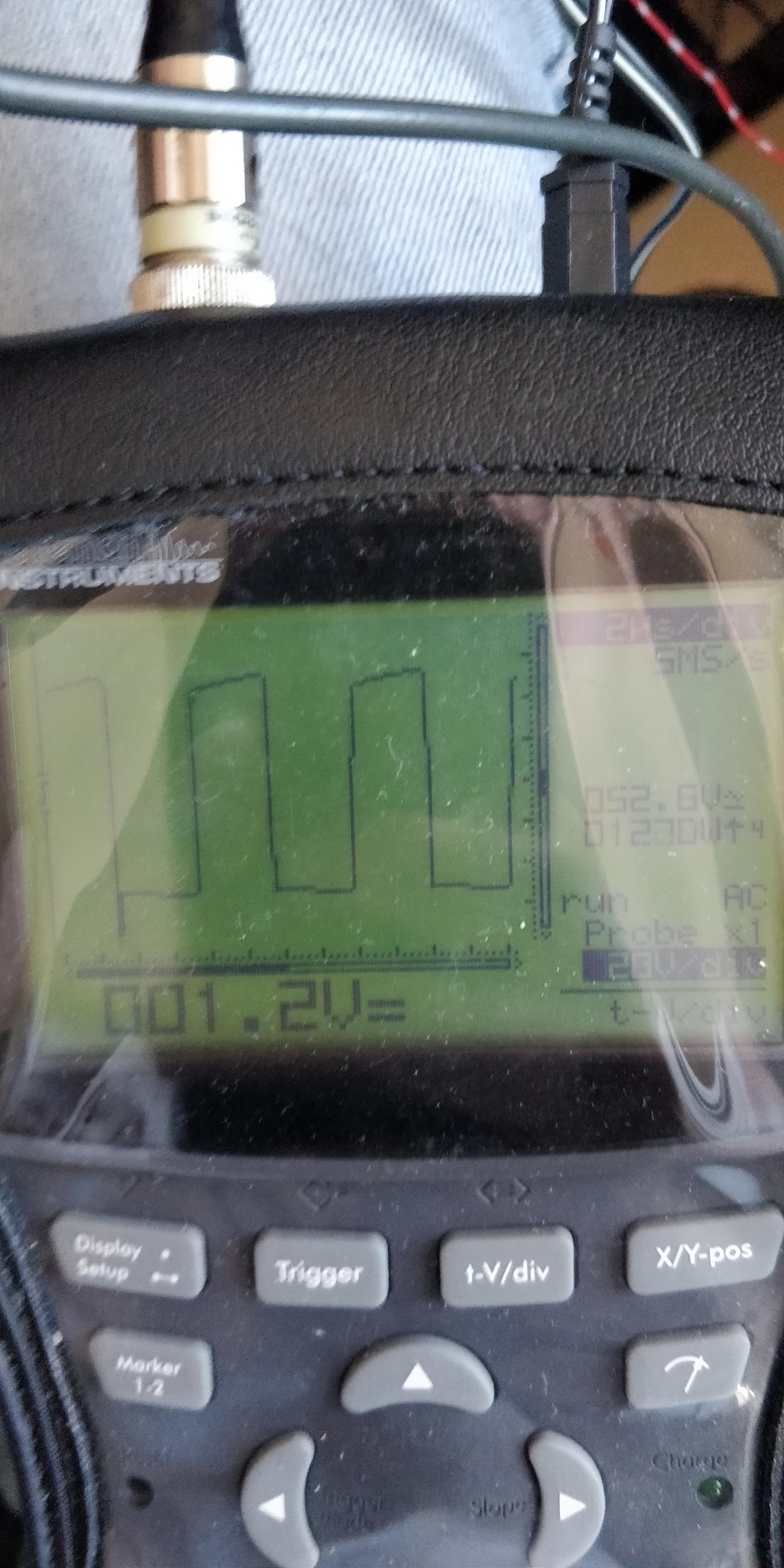

Post a photo of the drive signal that you said wan't quite right.
1 is from positive drain
2 from positive side gate
3 from negative side gate
Negative side source is changing it's shape. Going from normal to smaller then normal again.
Transformer has a high pitch sound when going to idle, that wasn't there before. It's changing frequency when probing FETs.
Is this scope fully isolated from the mains?
When you post photos, take them from an angle that doesn't have a bad reflection like these. This applies to scope and board photos.
I tried but at the moment I was trying to hold the scope and probe as well, trying to take the picture in the meantime.
It runs on it's own power supply from the mains, can run on battery as well. But I do have to use the ground from the probe to be able to have proper readings, so I assume it is.
I want to see the drive waveforms on the outputs. I would prefer if you were running from batteries.
Solder a resistor leg to the gate leg and the source leg of the outputs (one FET per bank). Clip the probe to the gate and the ground clip to the source. This will free your hands.
Set the scope so that the waveform (3-4 cycles) covers the entire width of the screen. There is no need for the information on the right.
