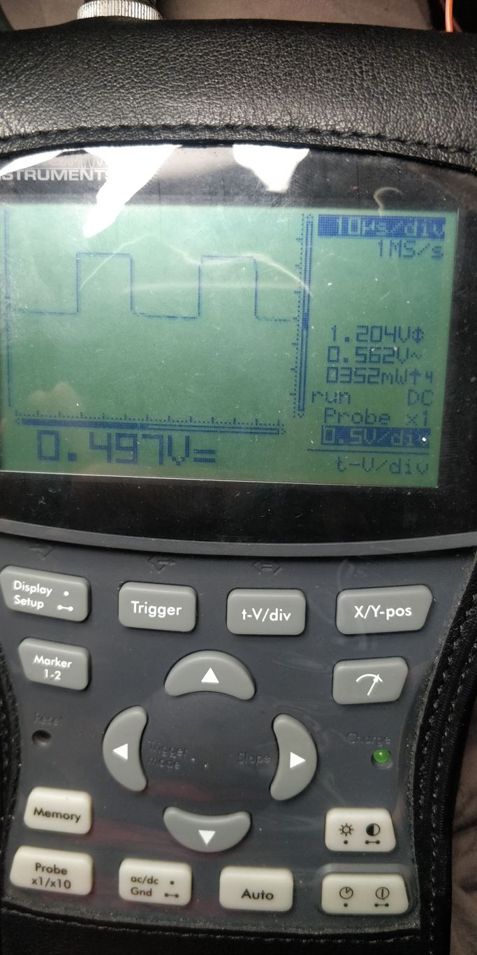

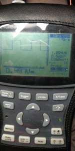

So, replace the faulty transistor and the chip is back to life. I have the rectifiers and power supply fets removed and I have like this: voltages on the chip pins, I'm going to put them in order starting with number 1... 3.71v 5.01v 0.11v 0.15v 1.59v 3.46v 0v 11.55v 4.48v 4.47v 11.56v 11.56v 5.01v 5.01v 6.94v 5.01v. I'm using a small 12v adapter with about 2A for powering it up. Now, some of the things I'm not sure about. The D702 which is before the the chip, lowers the voltage down from 12.20 to 11.59v seems weird to me. Drain on the FET's is 12V but the gate is 0.5v on one bank and 4.38v on the other. Pretty sure something else blew up when I shorted the pins as the one with 0.5v used to have about 2.38v or something like that. Some guidance would be much appreciated from this point. Pin 5 has the sabertooth oscilation. Thank you

'Channels' are generally used to refer to the audio channels, not power supply. The power supply has 2 'banks' per transformer for push-pull power supplies.
Output of the transistor?
When you post a waveform, you need to post where the two probes were, precisely. This means giving the terminal name and the circuit board designation. When there is no diagram available, you should post a photo of the area of the board involved.
