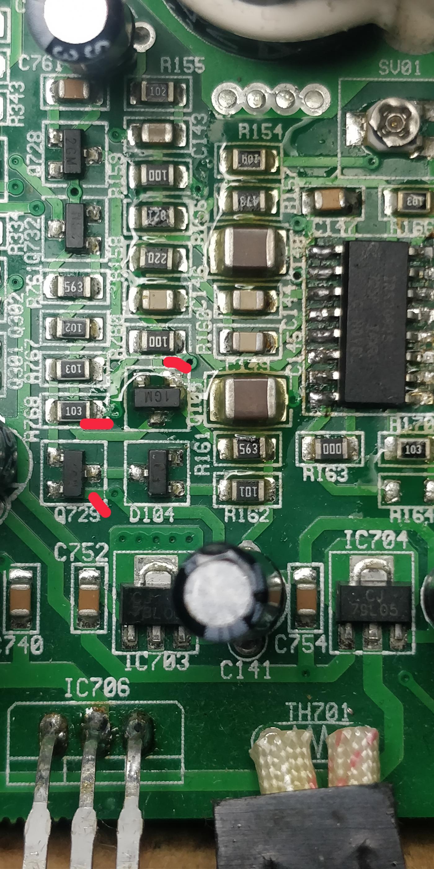

Because I would get a zero reading with both probes on the same point as per your directions to the OP. I can take 13's reading any way you would like.
Yes this amplifier is complete.
I can double check the HO and LO if you would like.
Pin 14 is 5.56v
I must have not been on the pad fully. It is a tight area to get readings with a DMM.
Bare with me, as my black probe is connected to the other via a crocodile clip... Don't know if you use the same name for it back there 😀 measuring now.

If I'm following the trace I end up to the 1GM transistors that read 5v on the other side.
'IF'? Only you can tell us what we need to know.
I don't have the 9601 diagram. I'm working off of the 9605. In this amp, the -5 comes from a 7905 regulator.
When? Sorry for my english 😀 not that perfect
On mine, that pin goes up to that KIA7812A regulator that I've now replaced with a NTE1970 which was the recommended equivalent. It has 18.63v on one side and 12.20v on the other side
Unfortunately no. Best thing I've had was the 9605 that you posted in another thread, and that helped me a lot with the power supply. Audio stage is different though.
Trace goes to that 10 ohm resistor, continues to the 10k resistor and then to the 1GM transistor. Also, underneath, before the 10k resistor it also goes on the other side of the transistor. Then continues to the voltage regulator. It also goes into a CJ79L05 which is a negative voltage regulator. I assume my problem could be over there somewhere, with one of the capacitors maybe.
