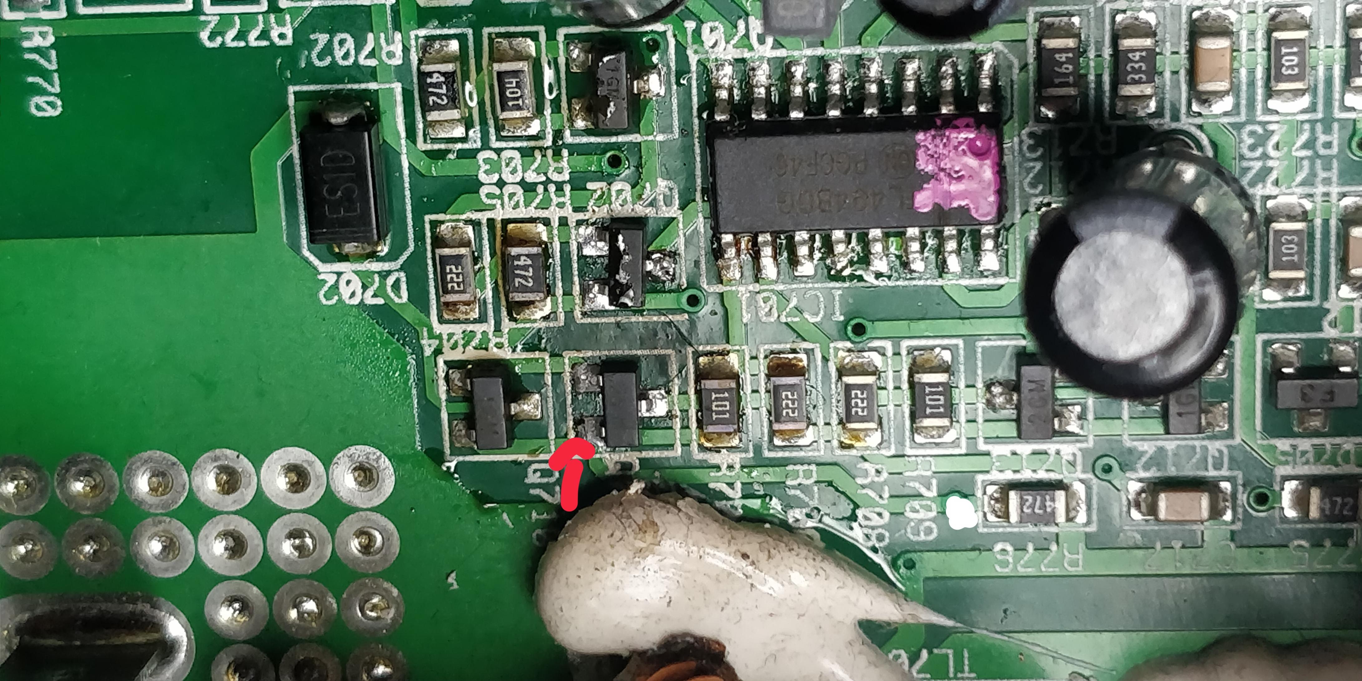

Yes, that was the output of the transistor. Q711 in this case. Ground probe I'm leaving it on the main ground and measured on the emitter of the Q711. But I've just remembered that I didn't replaced it's counter part, the Q710. Will do that now.
From the transistor, trace goes under the board straight to the fets, so I'm assuming that the other transistor is all that could be at this point.

A transistor doesn't have an input or output. The output can be taken from either the emitter or collector.
Why do you think there is a problem with the wavewform? Was your probe switch set to 10x?

No, probe is set to 1x.
I'm thinking there is a problem with the voltage as it will probably won't drive the FET. The other bank has 4.38V, as far as I know should be the same.

Do you have about 10v on the collector of the NPN driver transistor?
Do you have the same signals on the base of all 4 driver transistors?
Yes, there are 12v on the collector of the NPN
Yes, signals are the same on all 4 of them.
I've just replaced the Q710 and it was indeed faulty. I have 4v going to the FET's on that bank as well now.
There is still a difference of 0.2v between banks but I assume that could be because of the different revisions of the transistors maybe. Old one, from the other bank, is outputting 4.2v on the emitter. I guess this part should be done now and I need to start on the FETs, probably need to order some new ones as they are gone.

The other drivers show signs of overheating by the discoloration in the center of the face. I'd replace them.

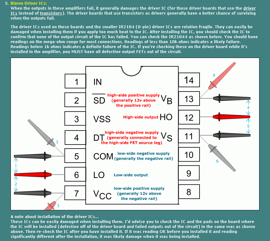

When checking voltage regulators like the 7812, place the black probe on the regulator's ground terminal.
These ICs are difficult/impossible to check without the outputs in the circuit. They shut down because they measure the Drain-source voltage when the IC is driving the low-side FET and without the FET, it appears that there is an over-current situation. If someone knows how to prevent this from happening, please post it.

Is the 2092 getting hot?
Did you check the outputs (high and low) to see if either had leakage to its respective power supply terminals?
