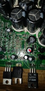

Well, it seems that the 2092 was dead allright. Removed it and most of the readings are open line. Now the amp builds the rail and goes to idle only with the small 2A power supply.
The capacitor marked in the picture was getting hot. I presume it will be out of value but I've ordered myself a ESR meter that measures capacitance, diodes and some more. It was needed anyway.
Pins 7 and 8 are connected to a 0 ohm resistor? That seems pretty odd for me. It does say 000 on it. I don't really see a point but then continues to a missing resistor. I've seen that recently. That resistor was missing since before me having the amp so I'm not certain if it's not needed or somebody else removed it prior in me buying the amp.
The drain on the fets still has about 1.8v with them removed and should be 0 as far as I know. I'm guessing something still leaking to ground maybe.

That was the only thing I thought myself. Thank you for confirming the missing resistor. I was unsure about that.
Well, I have changed the 2092 and added one FET to each bank. Still nothing. The 2092 is good now. No wave though.
Another problem, all the op amps are supplied with 30V instead of their normal supply voltage which I guess should be around 15-18v. Can't find anything wrong in the circuit though. I I'm not sure the input signal goes were it should in this case.

So, the supply voltage of the 2092 is about -42 or something like thay. One of the reasons I have nothing. I'm guessing it's a diode probably between other things...
The picture you last posted is the area of the voltage regulators. Make sure the regulators have the proper output voltages present. Keep in mind that you have positive AND negative voltages. This is where scopes come in handy to see the positive and negative voltages in reference to the grounding point.

Voltage regulators have already been checked, the one that was bad has already been replaced.
Not sure what kind of voltage should the 2092 have in this application but I'm pretty sure it shouldn't be what I've seen. I have negative voltage on the VCC pin. That's why I'm thinking something is bad over that area as well.

The IRS2092 will have several voltages present (even rail voltage) as you can see from the application diagram that is provided by IR.
You may see that negative voltage on pins 7, 8, 9 and 10 based on the application diagram keeping in mind voltage drop across any resistors.
