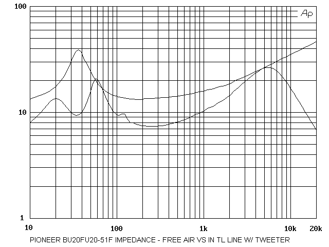

Please correct me if I am wrong here, but from what I can discern , adding a 1uf cap in series, to an 8 ohm driver like this one, will make the crossover frequency (6db rolloff) 20khz, which to me seems to be a bit too high.
Why not go with something like a l.47uf, or 2uf to bring it down a little bit more to within the 10khz to 13500khz range?
Well, a 1uf cap is first order so only rolls off 6dB an octave so even though it starts high, it isn't affecting much right away.
Also , it's a 6 ohm tweeter I believe, which I think means it actually crosses even higher..
However, with the new tweeters that I 'm using, which are a bit more efficient, I find 2uF is just right.

Paper cone with poly foam surround. Incorporates a center whizzer cone. Recommended for sound reinforcement or single component cabinets where a wider frequency coverage pattern is required. * Power handling: 60 watts RMS/85 watts max * Voice coil diameter: 1-1/2" * Impedance: 8 ohms * Frequency response: 36-17,000 Hz * Magnet weight: 20 oz. * Fs: 43 Hz * SPL: 90 dB1W/1m * Vas: 1.75 cu. ft. * Xmax: 3.0mm * Qms: 3.02 * Qes: .62 * Qts: .51 * Net weight: 5 lbs. * Manufacturer model number: B20FU20-51FW * Dimensions: Overall Diameter: 8-1/8", Cutout Diameter: 7-1/4", Mounting Depth: 4-1/8", Magnet Diameter: 4-1/4", Magnet Height: 1-1/4".

FWIW, I use the little neo tweet and like it with anywhere from 1uF to 2uF. Just depends on how and where you use them. But if you get too much energy down low, they can make rude noises - so be careful.

We did as recommended. Get a pile of caps, two of each:
2, 1, 0.5, 0.25 uF
It was very clear when we hit the right point., .25 uF each way wasn't as good as 2.0 for us with the BOFU in a BIB
