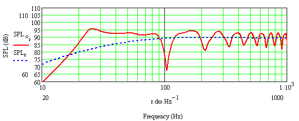

I dunno Greg. I've just run a set of sims on a generic pipe with a CSS 12in driver, just varying the Zdriver location. I did two for each cabinet, one un-damped, the other with 0.25lbs ft^3 in the 1st half of the line. Positions were 0.416, 0.5, 0.6, 0.65, 0.7, 0.75, 0.8, 0.85 & 0.9 total line length. There wasn't much difference between the 1st two, more than that, it gradually worsened.
This is the pipe with the driver at 0.416 line length (damped)

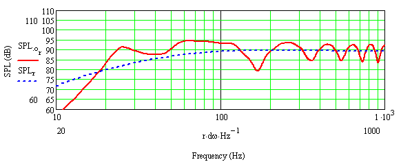

And for sake of example (I just pulled it from the variations I did), this is at 0.65 line length with the same damping.
I don't doubt you -you've got more experience in this than I ever have, but this is what I'm getting. Maybe it's me that's doing something wrong (certainly wouldn't be the first time, or the last 😉).
