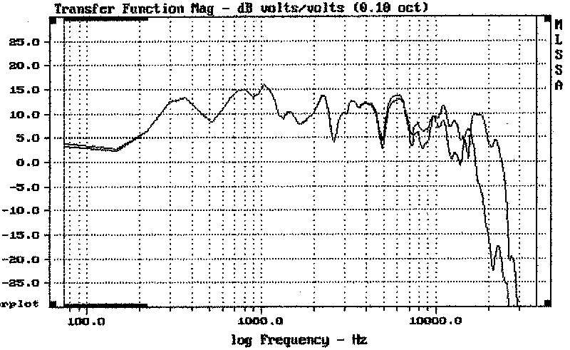

IIRC, the ledges TC put in were primarily to support a grill based on a frame of 3/4in particleboard, to stop the cabinet becoming a rubbish bin, though they undoubtedly had the effect you describe Greg. I know that he lined the final part of his original 1354 box, just as Fostex suggested for the design:
'...I notice that by lining the output of the top end of the speaker with an inch thick layer and down about 8" seems to help dampen the ripple effect a little. TC.'

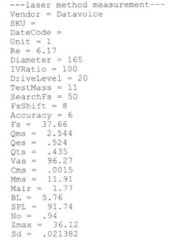

Greetings,
Here are the t/s parameters for a B20FU driver as measured by Jack from NHT. There are no units associated with the parameters which introduces some confusion. I've included the standard metric units below in parenthesis with a question mark to indicate a final determination has not yet been made.
Please give these an eyeball and help to confirm my assumed units are correct.
Re = 6.17 ohm
Diameter = 165 mm
DriveLevel = 20 mV
Fs = 37.66 Hz
Qms = 2.544
Qes = .524
Qts = .435
Vas = 96.27 (L?)
Cms = .0015 (m/N?)
Mms = 11.91 (g?)
Mair = 1.77 (g?)
BL = 5.76 (Tm?)
SPL = 91.74 (1w or 2.83v?)
No = .94 (%/100?)
Zmax = 36.12 ohm
Sd = .021382 (m^2?)
- Matt
