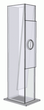

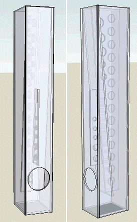

Just a note: i was working thru Variacs plans prepping for a SketchUp of the BOFU BIB. There are a couple dimensional errors. 1 panel too short (by my figuring diagonal should be 66 1/4" long), and 1 too wide (baffle should be the same width as the cabinet)
I've contacted Mark so as to get updated plans posted.
dave.

Is the baffle required because of the limited depth of the cabinet at the driver's location?
Has anyone tried a sliding baffle? It looks to me the BIB is a tapped horn. Reflections from the closed end would create peaks and dips in the response (???) which could be tuned to taste by sliding the "tappped" position. I'm just guessing here...
This maybe a question answered in the BIB thread that I overlooked.
It's a pipe horn with the driver 'tapped' in at a specific distance along the flare path -the phrase recently seems to have been hijacked to refer to the Tom Danley style of cabinet with the driver mounted through the internal baffle but according to GM (and it makes sense, when you think about it) applies to any horn with the driver positioned some distance from the throat.
Yes, harmonic resonances can be supressed by tailoring the Zdriver position (distance from the throat at which the driver is tapped into the horn). Typically for an open-ended BIB run full-range, the best compromise is 0.2 - 0.217 line length. The ~optimal is around the 0.416 line length Martin King found for a 1:10 taper line, but that's only useful for high Fs drivers, with a relatively short path-length (& therefore work best as inverted types coupled to the floor), or bass-horns (see attached).
If they're positioned properly in-room (as corner horns they require the room boundaries to complete the horn flare & provide the correct acoustic-impedance match at the terminus) and with a good damping strategy, they don't exhibit much more ripple than other cabinets & kill most stone-dead in the LF.

By "baffle" we will mean the small "extra" baffle on the front , doublling the thickness near the driver..
-Mounting the baffle so that there are slots for adjustments in height or various holes to try is a good idea and one that I considered, but haven't investigated. The hole in the front of the box would need to be elongated vertically but I see no problem as long as it doesn't get exposed when the baffle is moved all the way up or down.. We're probably talking about 3 inches at most here.
-I don't know if the baffle is required to give clearance for the back of the driver, as I found that there was enough wood to make the baffle and felt that a little extra clearance behind the driver could only be good.
-We made the baffle attached with only 4 screws (6 screws if it is longer) so that it was easy to remove for work on the crossover cap or adjusting the stuffing.. That is a good idea, as removing the driver often is just asking for a screwdriver through the cone. Possibly there should be some sort of gasket material behind the baffle then, and glueing it eventually would be the most rigid.
-The baffle could also be wider than the cabinet if one wants to experiment with various sizes as a suprabaffle to adjust response. Careful trials might well pay off. May be room dependent also.
As it is, I felt that there was no problem requiring correction, but its possible that it can be improved. In order to have material for more different baffle widths, one could use a half as tall baffle. Also maybe use the base material. I showed the base, as it is important here in earthquake country! For supra baffles, taped on cardboard is always my first try..
-Mounting the tweeter on a tube in the center of the BOFU after removing the dustcap is an option that I find appealing to try. I doubt that two strands of twisted magnet wire to the tweeter in front of the large driver will have an effect on the sound, and the coherence of a coax might be an improvement. OR, the resonances might make it worse. At $20-25 each one can risk a bit of experimentation on the driver.
My main credo is to keep the mods cheap as that is the theme I have followed with this speaker. I wouldn't be suprised if many end up covered with veneer in the end, as they really are a pleasant speaker!
Please post your findings here for consideration by others..
