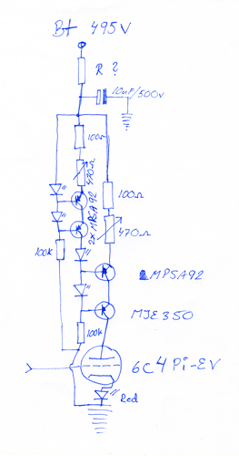

Ok.I´m building this CCS with a CCS for the Led´s
🙂 to have at my driver tube at 15mA.I am goint o have about 495v at the supply,now I wan´t a RC filter how large should the R be?🙄
I, to Led´s should also be 15mA.wait a minute the Leds are serie connected,should that be 30mA???😕

I think you need to give a diagram to make it absolutely clear what you are proposing.
Ok,lets see if you understand my drawing.
It was the R at the RC filter i wonder what value it should be?
The current trough the tube should be 15mA.And should I set the current trough the Led´s to 15mA or 30mA.Maybe a littke overkill CCS for the Led´s but whata heck,it´s only some Led´s and transitors.😀
I'm afraid that won't work.
(1) You have 495V. MPSA92 is only rated at 300V
(2) If you draw 15mA through a transistor with nearly 500V across it, it will dissipate 7.5W. MPSA92 is rated at <1W.
(3) If you want to use a CCS for the LEDs that provide the reference for the anode load CCS then you must use an NPN CCS.
(4) The diagram is wrong. Very wrong.
I think you are way out of your depth. Can I suggest that you simplify what you are doing, make it work, then add modifications little by little as your understanding improves. As it is, you will create smoke, waste money, and disappoint yourself. You really need to learn more about theory before embarking on such ambitious schemes.
