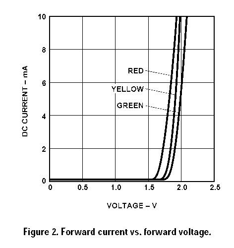

You need to look on the datasheet or measure for yourself current vs voltage dropped, and see how much current is required to make the LED's work linearly, for the example here, not a lot, but can vary hugely between different types. Kind of the same idea as not using tubes near cutoff if possible I guess. Maybe there's some configuration where the tubes and LED's nonlinearities could cancel?

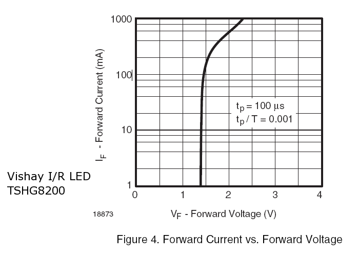

One thing I am pretty sure though is the comparative I/V curves typically shown for different LED colours are highly idealized. No spec sheet I've seen for visible spectrum LEDs display the sharp-knee/straight-line characteristics shown. On the other hand, take a look at this one from the spec sheet for a Vishay TSHG8200 infrared LED, picked at random for being the longest wavelength and a through-hole mount model. From a purely impedance viewpoint (ignoring noise, etc.) there’s your potential 2 ma LED.
Goodie-goodie 😀 Maybe just what we need. Time to order from Farnell again and experiment. I'd love to test this on my 407 preamp which is at 3.5mA current.
