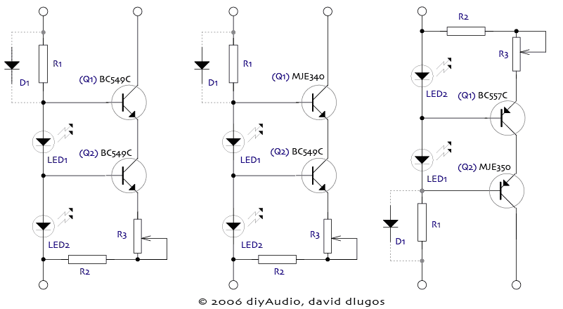

If you decide to build one of SY's LED CCS, heres a little tip. If you use the variable resistor to trim the current - make absolutely certain that you don't adjust this bellow about 100R . If you do you will ask the first transistor to conduct to much current and will send it out of its safe operating range - result quick death of the said transistor.
The CCS will probably still work as the second transistor will still function as a CCS, but you will get distortion and much reduced performance.

Shoog said:If you decide to build one of SY's LED CCS, heres a little tip. If you use the variable resistor to trim the current - make absolutely certain that you don't adjust this bellow about 100R . If you do you will ask the first transistor to conduct too much current and will send it out of its safe operating range - result quick death of the said transistor.
That's why R2 was included - to avoid accidental destruction of the silicon. It's usually the transistor nearesr the load that fails, not because Ic(max.) is exceeded, but because the combination of high current and standing voltage cause its power rating to be exceeded.

Depends on what the transistor nearest the load can withstand. If you were using a -15V supply to the CCS, each (red) LED would drop about 1.65V, so the voltage at the top of the upper LED would be -15 + 2 x 1.65 = -11.7V. The upper transistor will drop 0.7V across its base-emitter junction, so the emitter will be at -12.4V. Suppose you were using a valve with its cathode at +8V; that would mean that the upper transistor would have +8V - -12.4V = 20.4V across it. If the transistor was a BC549C and you wanted to limit its dissipation to 0.2W to keep it cool, then P/V = I = 0.2/20.4 = 9.8mA.
If you were using an MJE340 and wanted to keep dissipation to <2W, then P/V = I = 2/20.4 = 98mA. The lower transistor's conditions should then be checked. The lower transistor has 1.65V across it, so keeping power to 0.2W, P/V = I = 0.2/1.65 = 121mA, so that's not a problem. The BC549C is a 100mA device, so 98mA is within ratings. Just.
To calculate R2: The current programming resistance always has the LED voltage drop less the base-emitter voltage drop across it. For a typical red LED, that means 1.65V - 0.7V = 0.95V. If you knew you had to limit the current to 9.8mA with the variable resistor set to 0R, then R2 must set the current, so V/I = R = 0.95/0.0098 = 96.9R. Nearest value is 100R. Similarly, if you had to limit to 98mA, then 0.95/0.098 = 9.68R, and nearest value is 10R.
ryssen said:What value should R2 be?

I use the one with MJE350 at the anode,wouldnt it be the same to removeThat's why R2 was included
R2 and use R3 instead?Better to be able to adjust?
