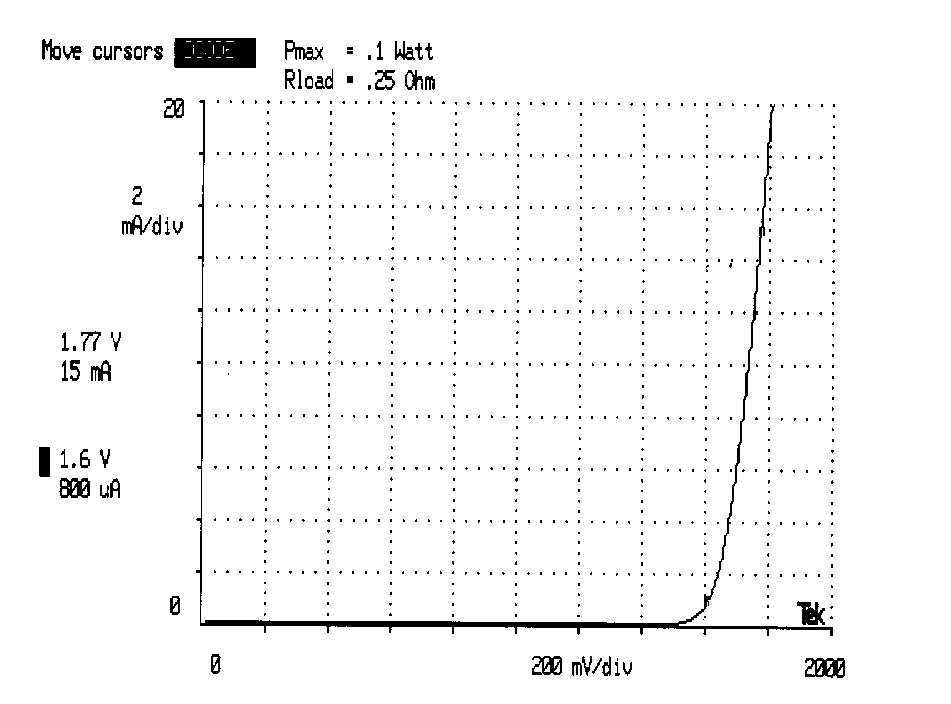

EC8010 said:
And this illustrates how sharply LEDs take off. It's the same red LED in all three attachments.
I was about to put together a test setup to make this curve when you posted this.

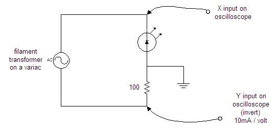

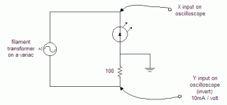

For anyone that wants to look at these curves themselves with different diodes, there's a really simple setup.
