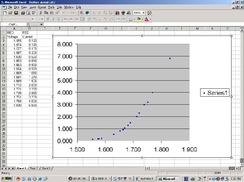

Surface Mount Small red LED
I have measured the V/I characteristic of the small surface mount RED LED. Attached pls find the measured datas.
It seems to me that the linear region of such small LED is good from above 1mA. It should be good for use in the circuits with smaller idle current.

Re: Surface Mount Small red LED
Nice work, thanks. At 2-3mA, the resistance does look fairly linear for small current swings, but the dynamic impedance is extremely high, roughly 30 ohms. That's typical for high efficiency devices, great for lighting, less so for reference or cathode use.
There's an optimal point where noise is minimized. I can't remember, but it was somewhere around 6V. But it's still very noisy compared with an LED or a reference diode like LM329.
kmtang said:I have measured the V/I characteristic of the small surface mount RED LED. Attached pls find the measured datas.
