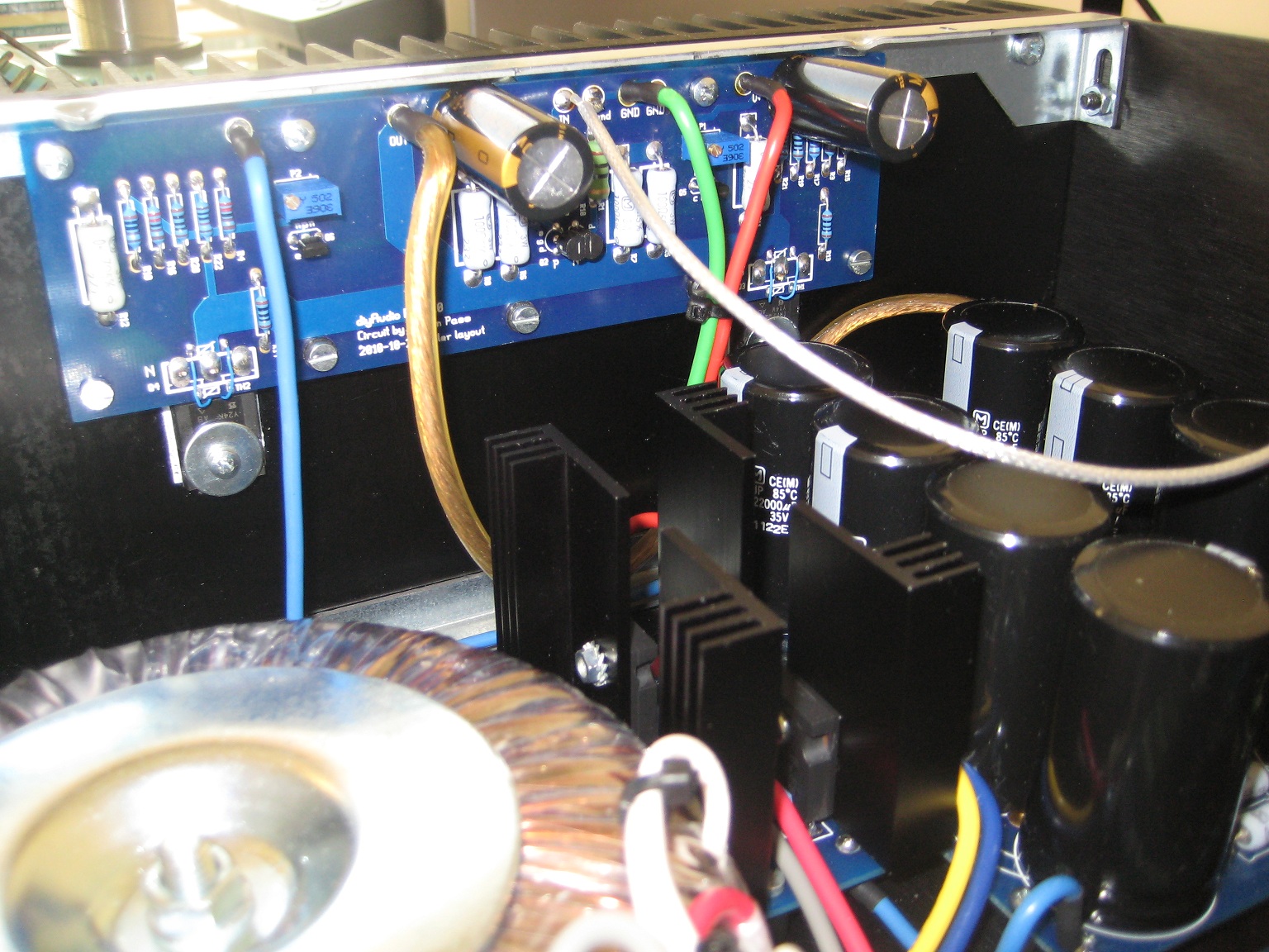

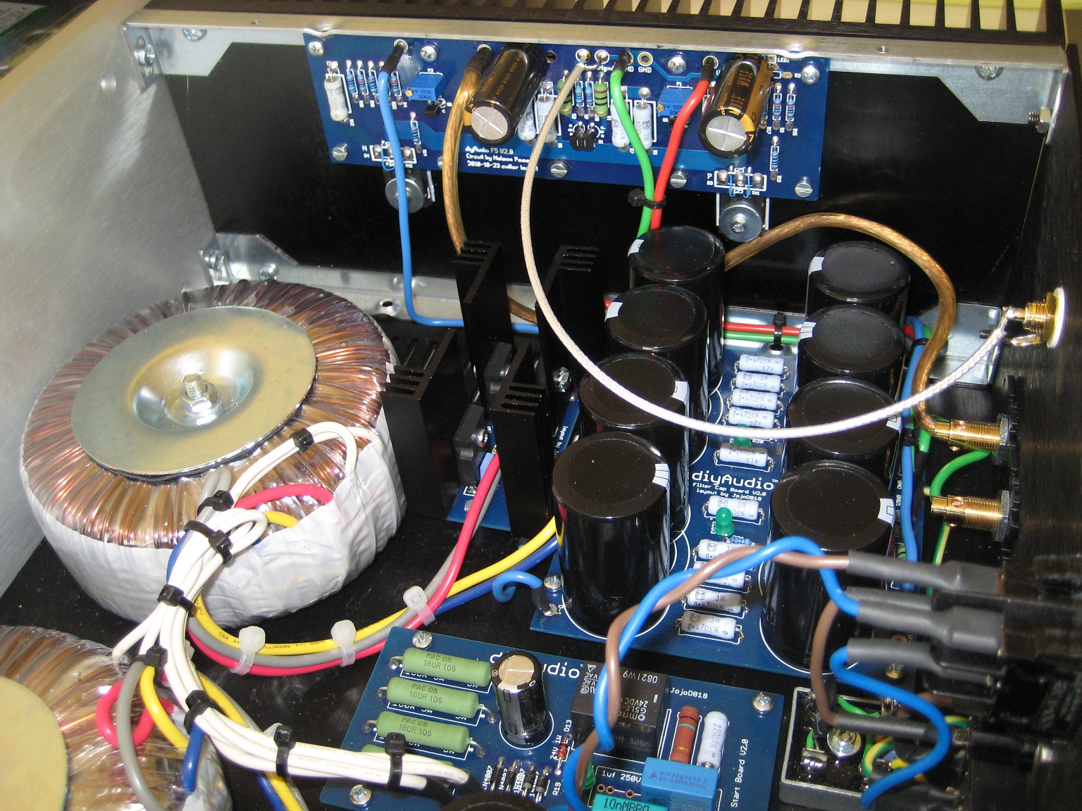

Another F5 with beefier PSU's

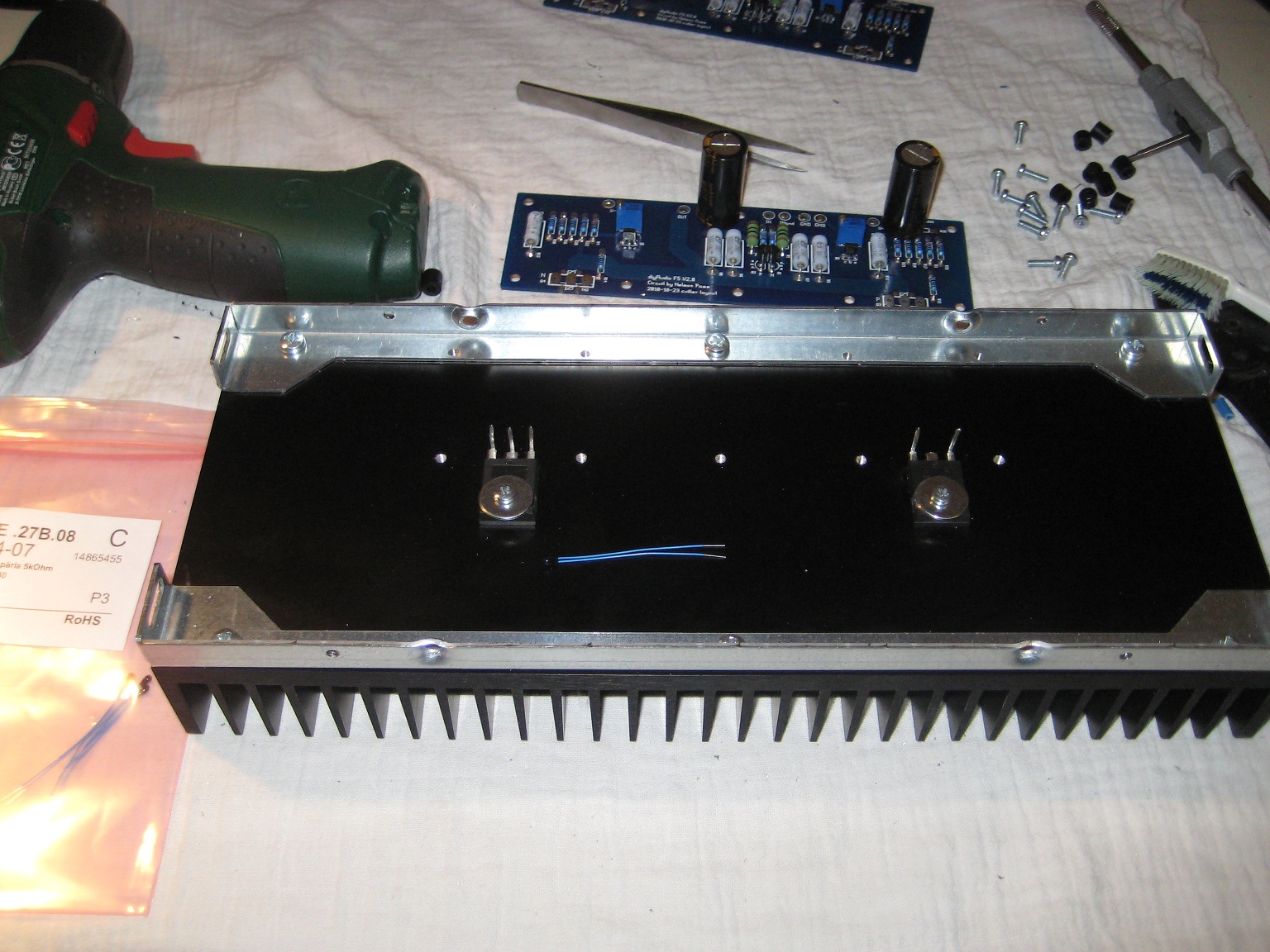

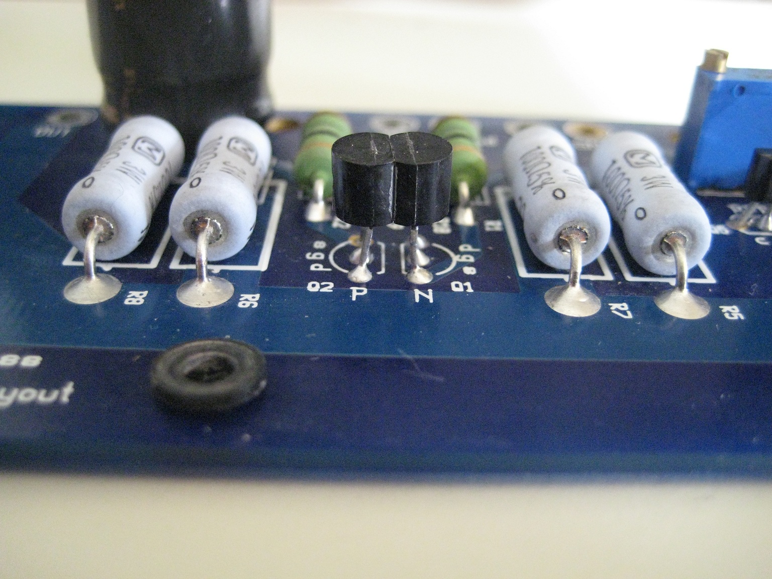

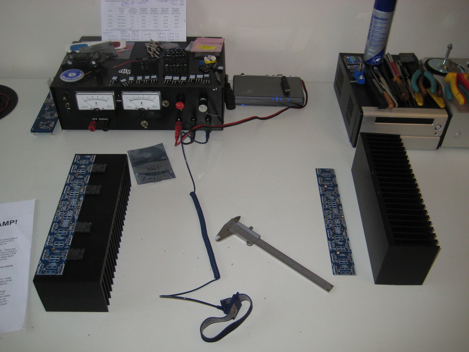

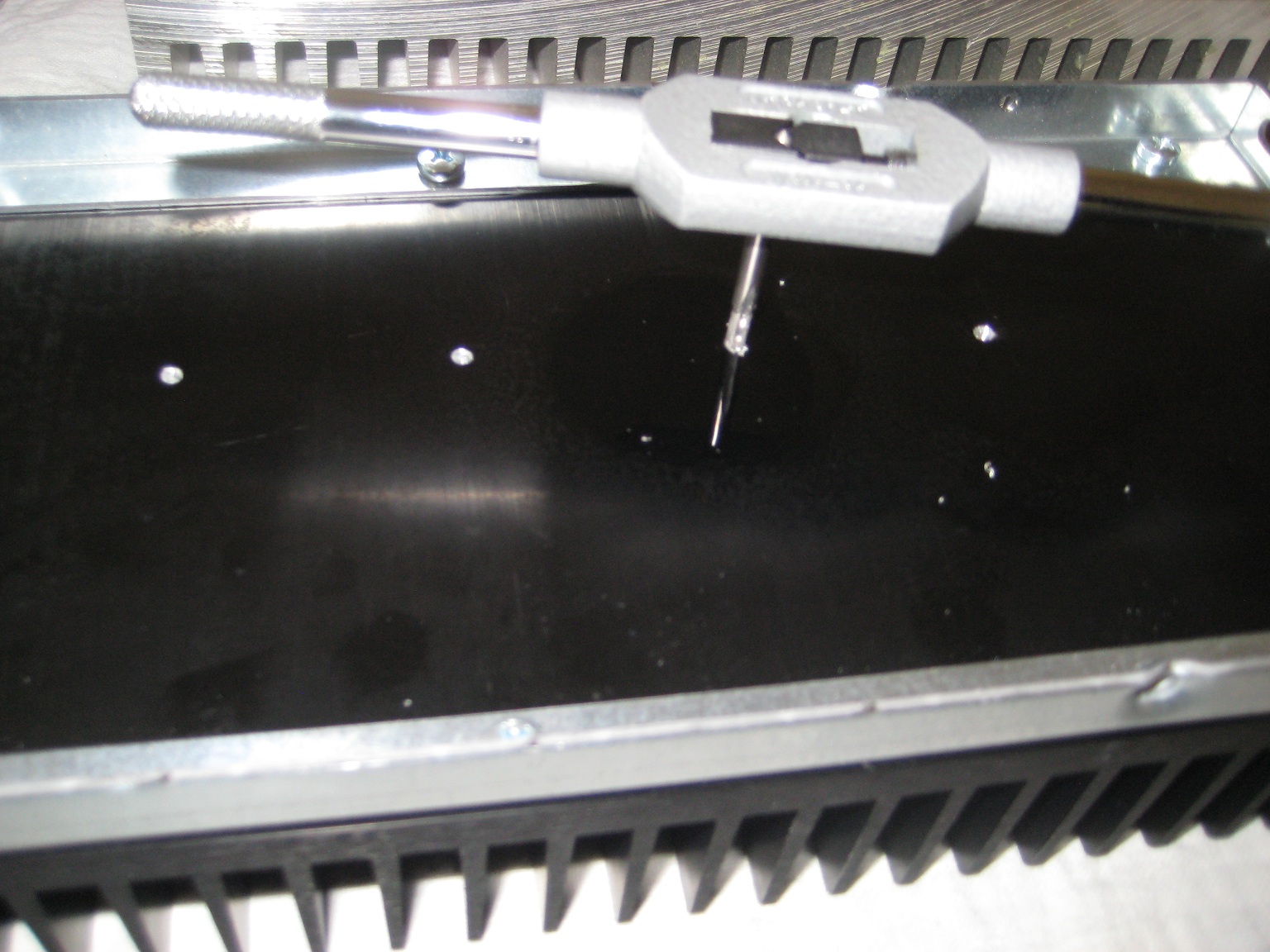

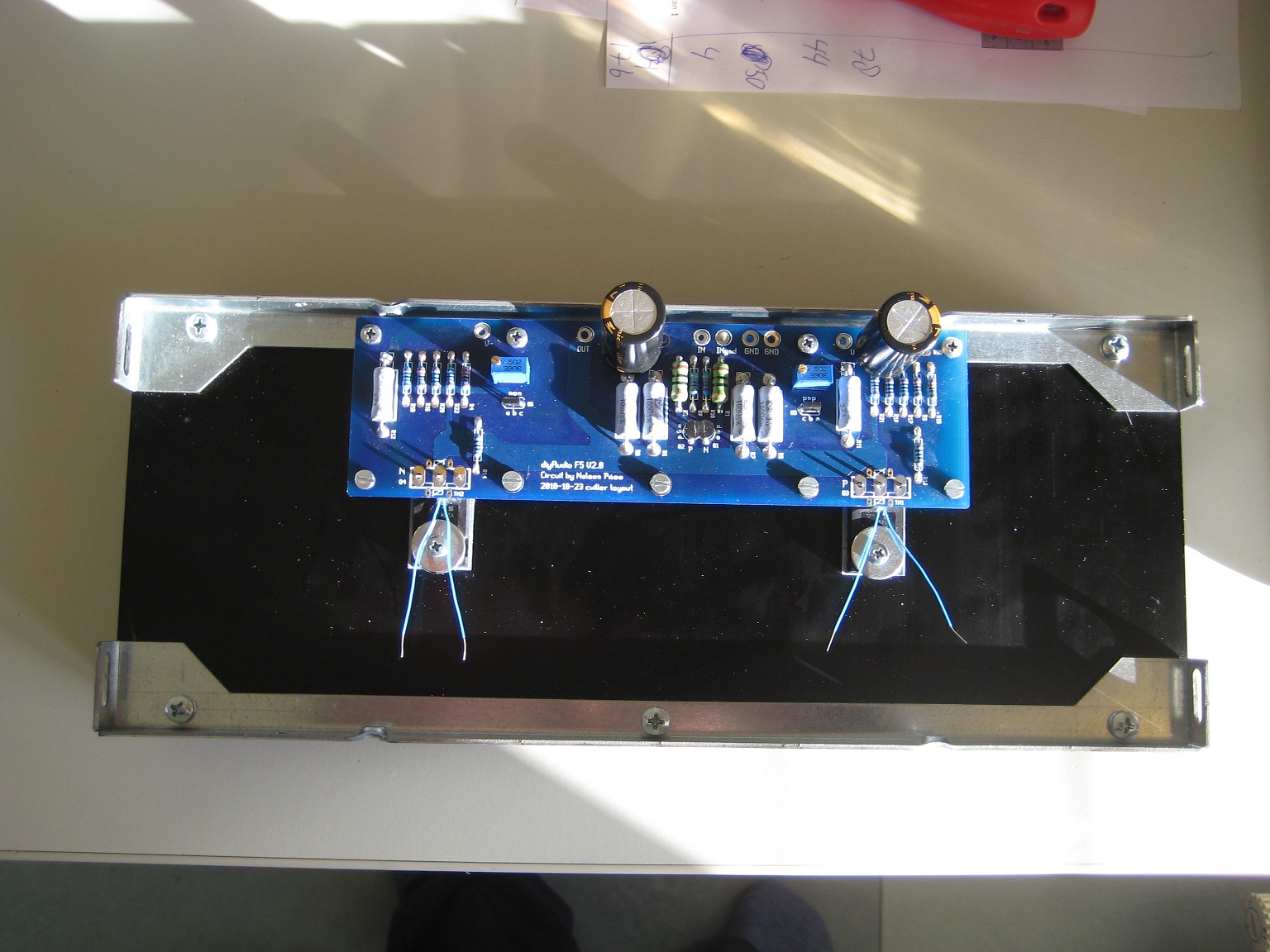

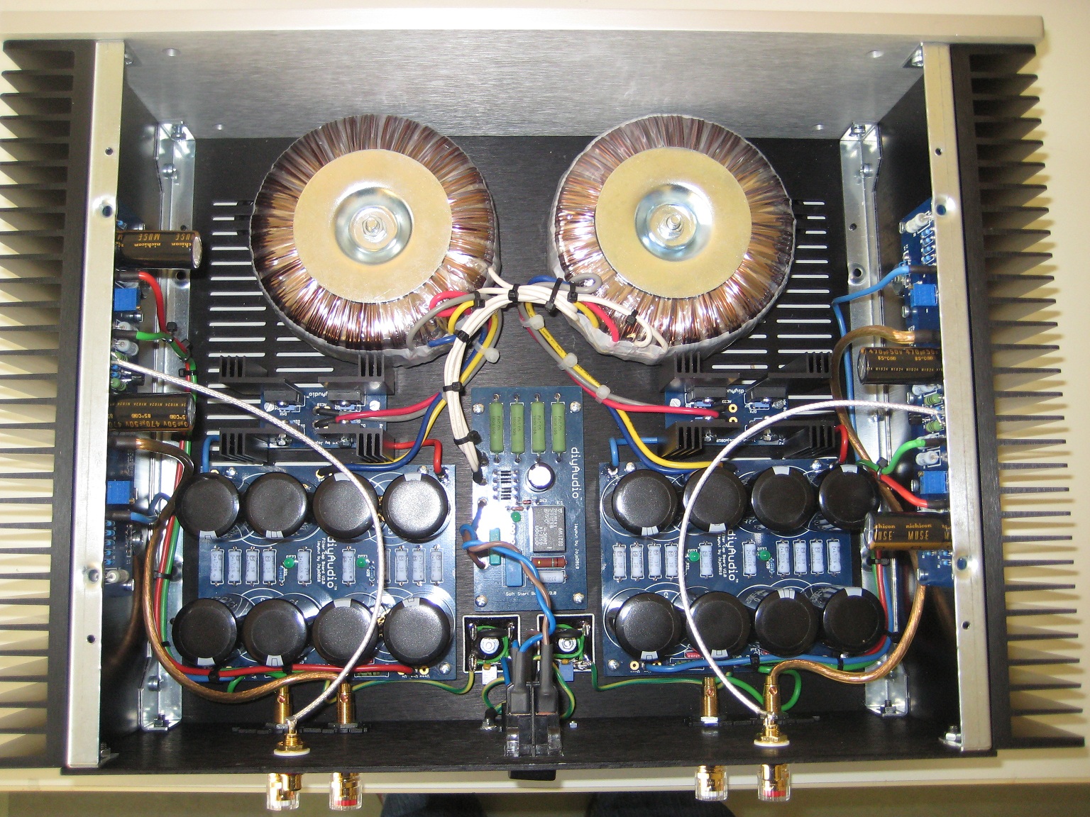

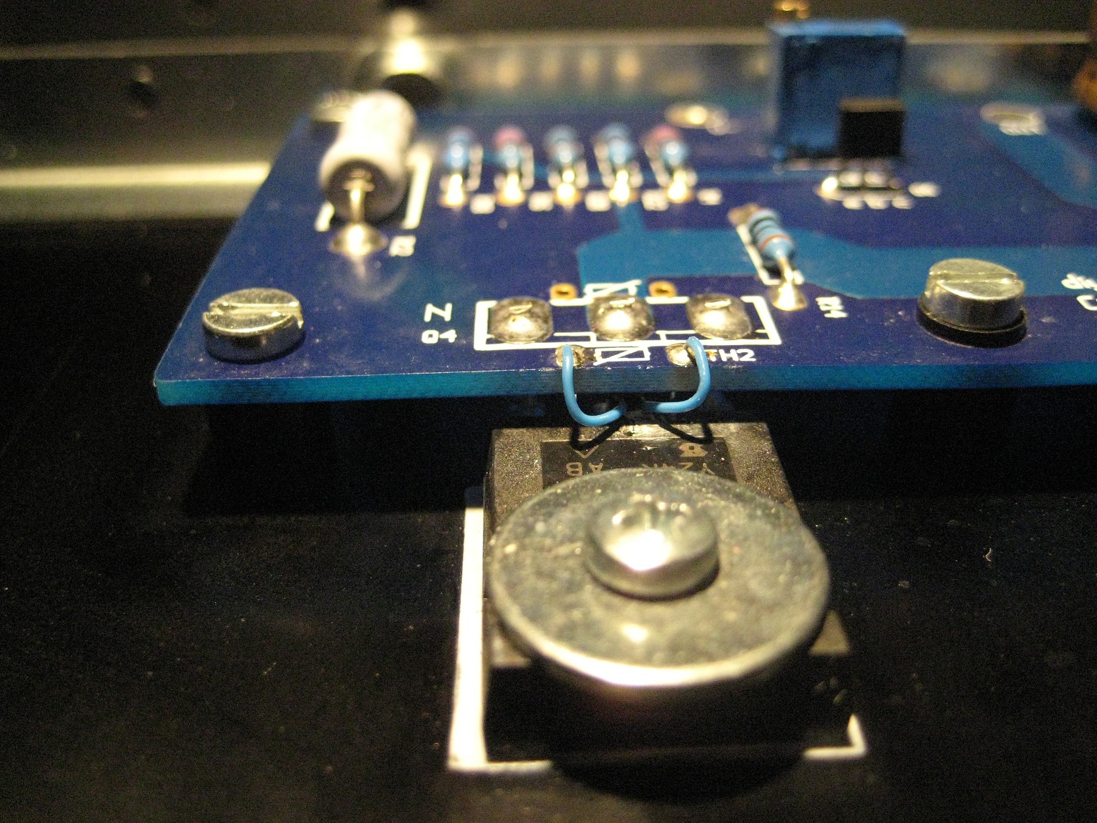

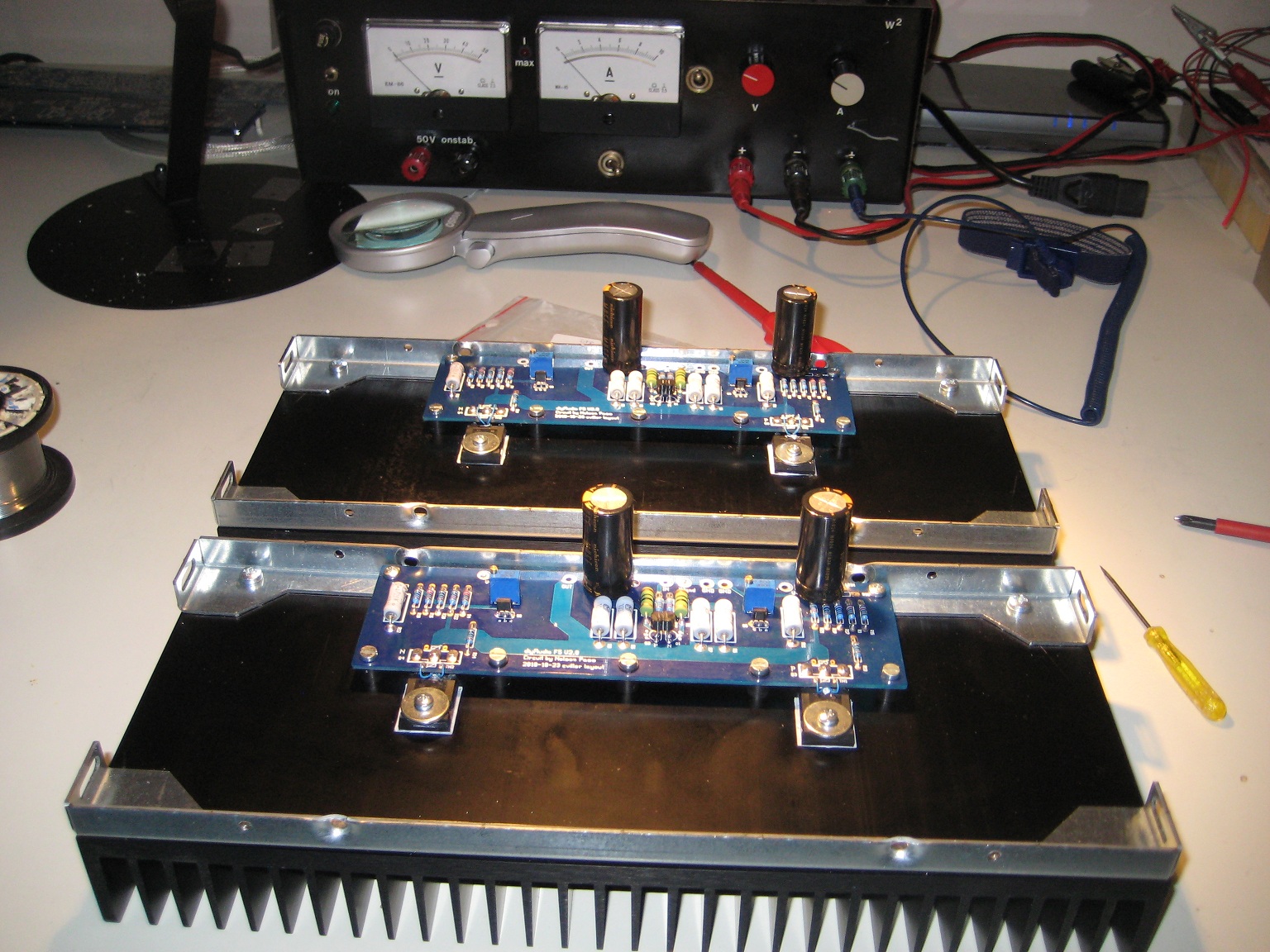

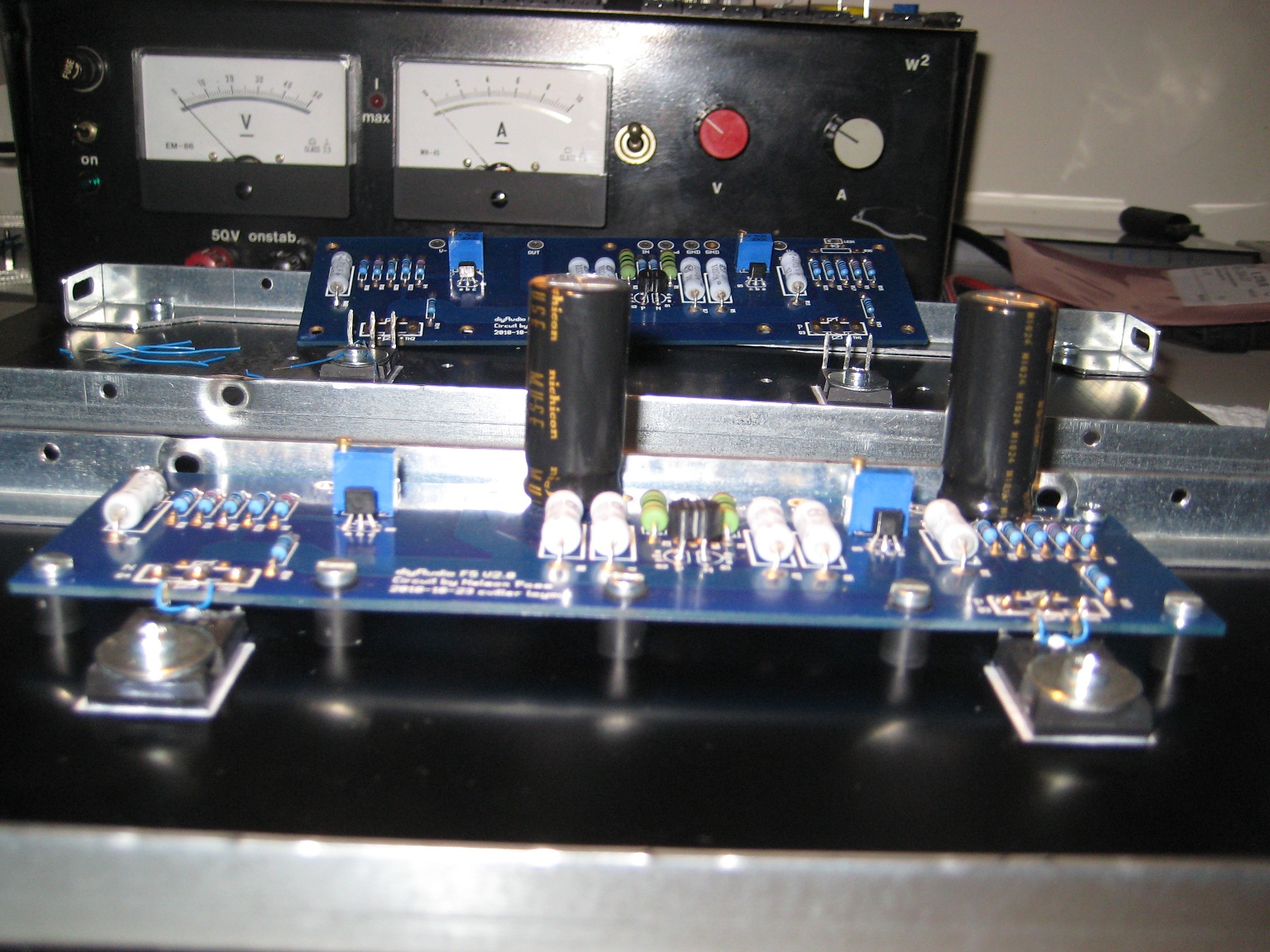

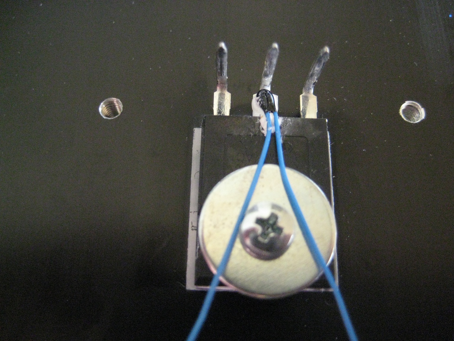

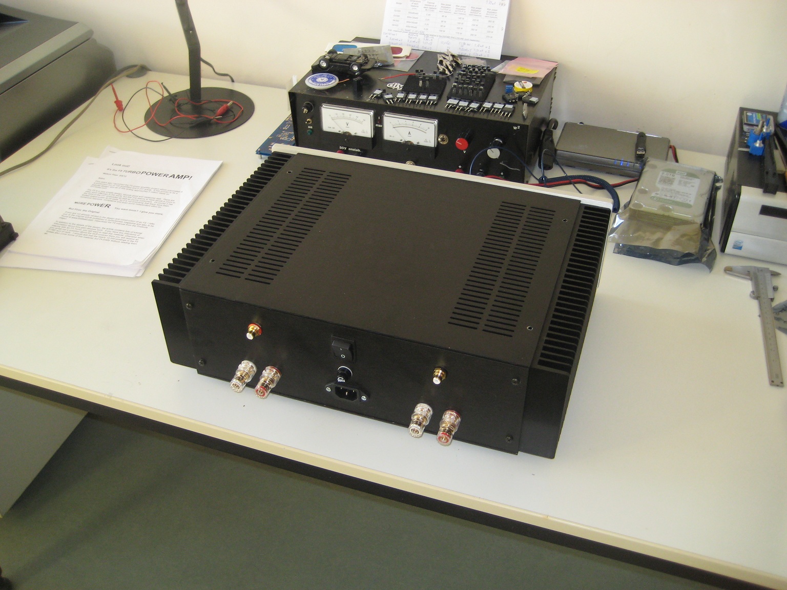

Finally finished my F5, it was a lot of work and fun, and it sounds fantastic. Nothing like I have ever earned before...
Lot of thanks to Nelson Pass and all other forum members for all the tips and articles posted.
I've been reading for days, maybe weeks, but it was fun and I learned a lot.
I have a lot of pictures to post 😀
The amp is dead quiet, not the slightest hum, and I can't hear any noise with my ear at the tweeter.
All the boards are from DIYAudio to support the forum 🙂 and they are great nice boards.
Here are some pic's:

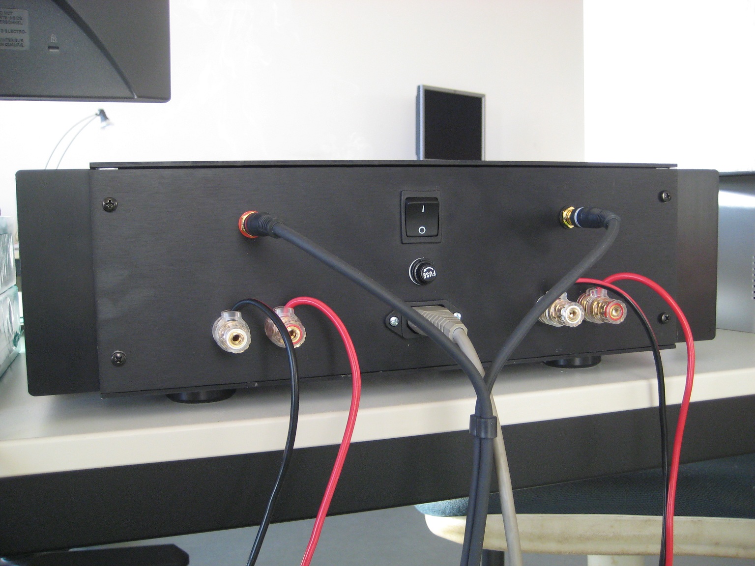

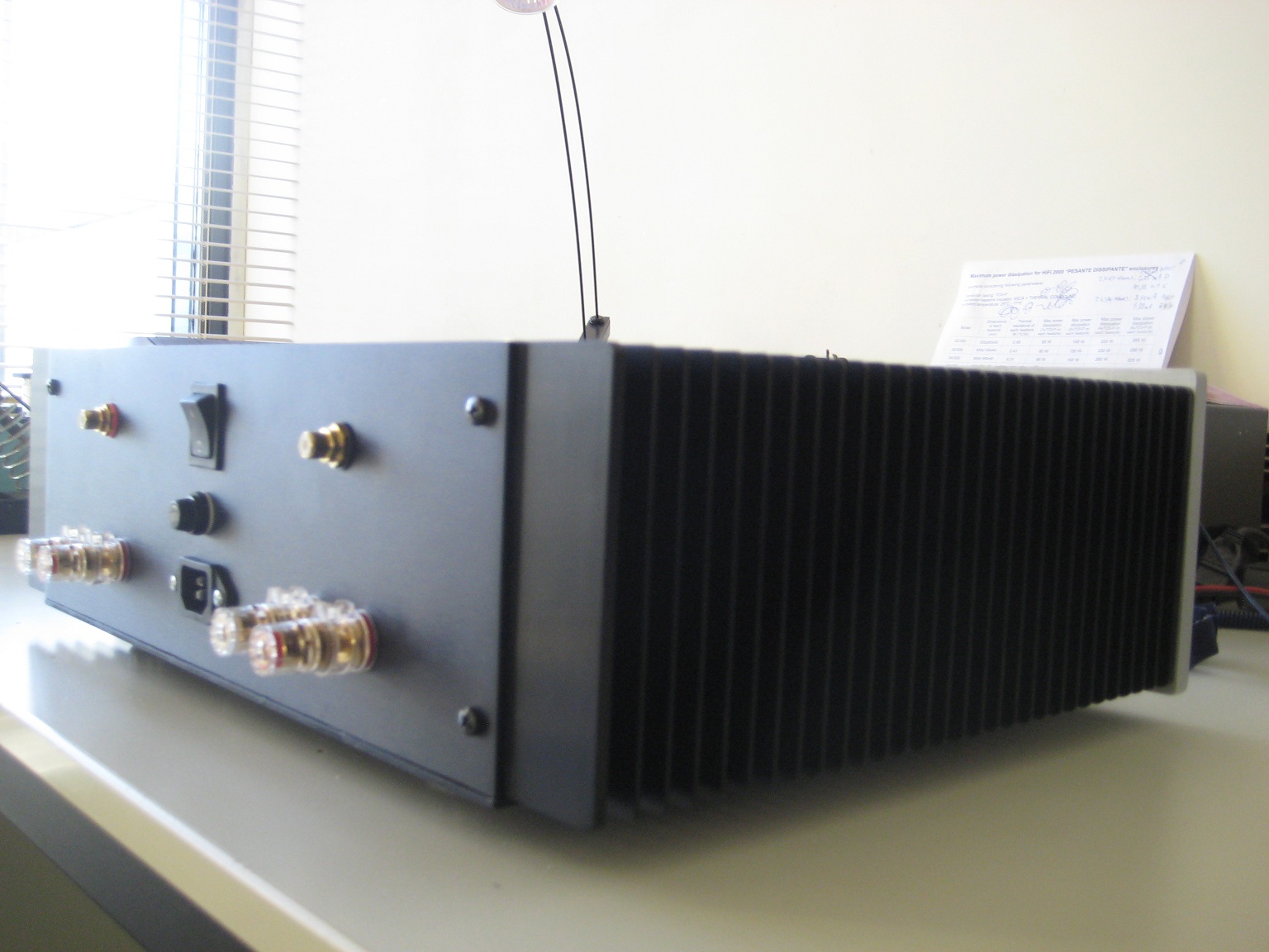

And some more pic's of the finished F5......
The last foto is my next project: the F5 Turbo v2 with bigger Austerlitz KS300.6 heatsinks, 2sj201 / 2sk1530's and I want to do the EUVL trick with the extra 5 Ohms resistor in the 2SJ74's source. Also truing to build the chassis myself with the heatsinks I have. So again a lot of work to come...😎
Thanks again for all your knowledge 😀

Your solder joints look perfect. Great Job on the entire build. I'm always interested in what speakers are being driven. Got any info?

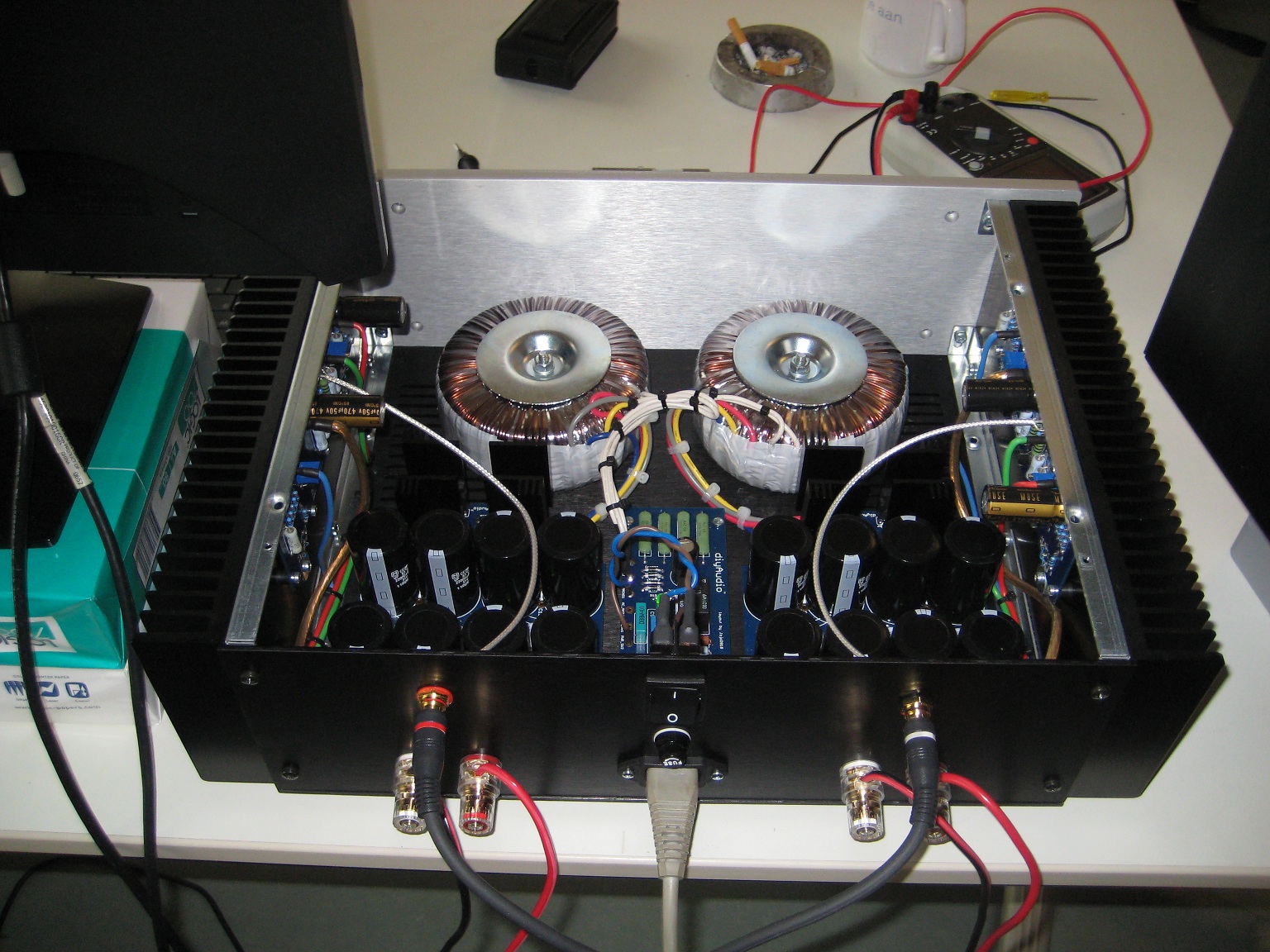

Since you are going to build, let me suggest you take a look at the "Sunflowers". They are premium output devices at a very reasonable cost. I've built around fifteen different designs over thirty years and I most likely will stop with these.

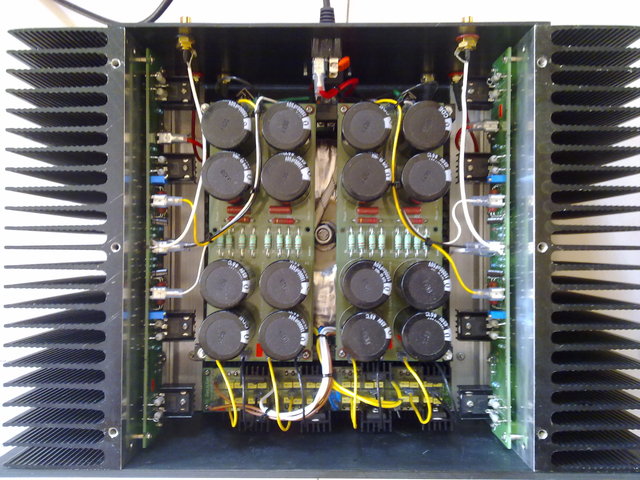

You're correct AudioSan! 3U300 with alu backplate and 10mm frontplate... Just enough cooling for a F5.
Heatsinks get around 48 degrees Celsius at 1.3 Ampere bias.
I tried to bias them at 1.75 Ampere each, but that was too much for the heatsinks...

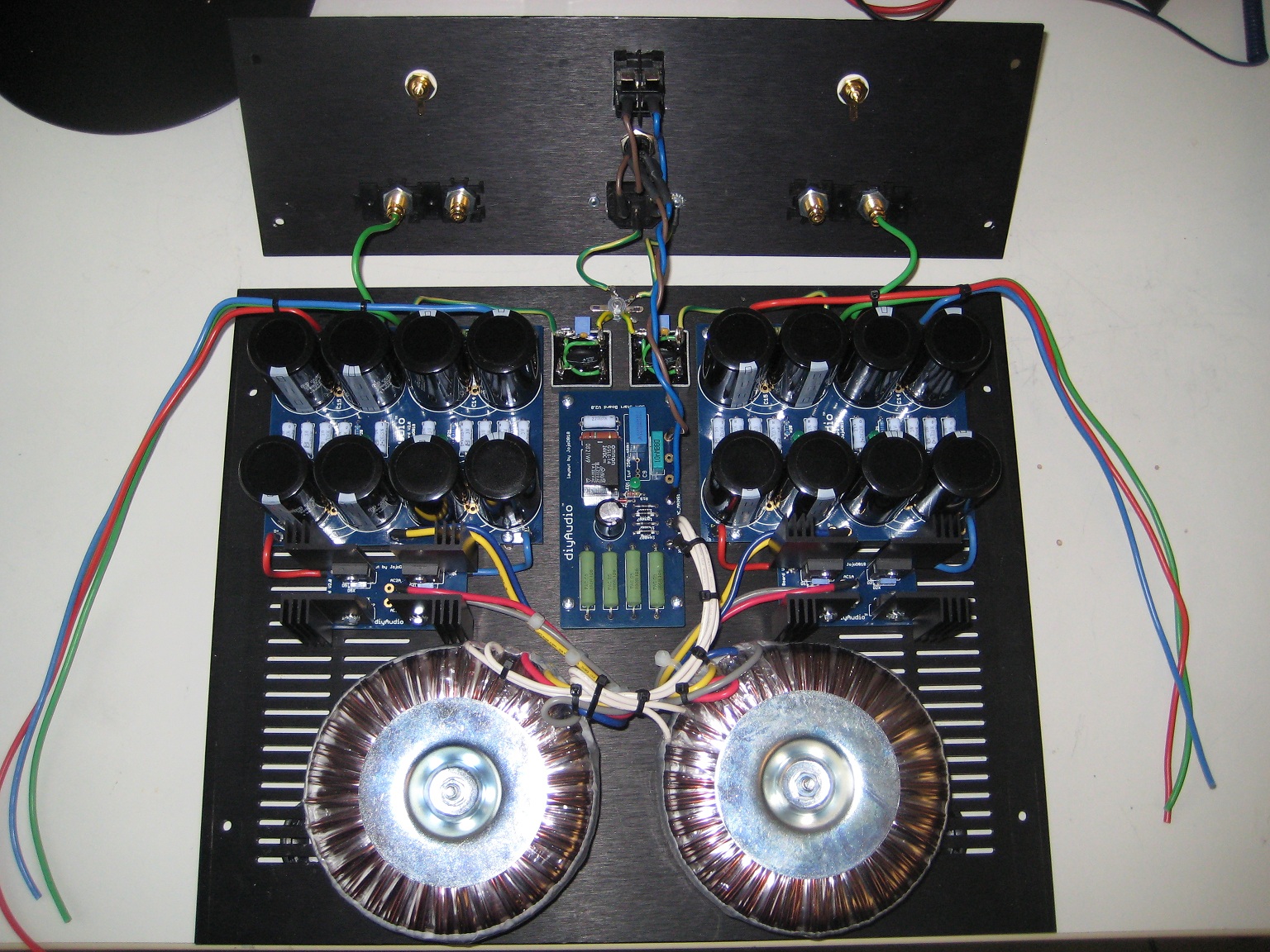

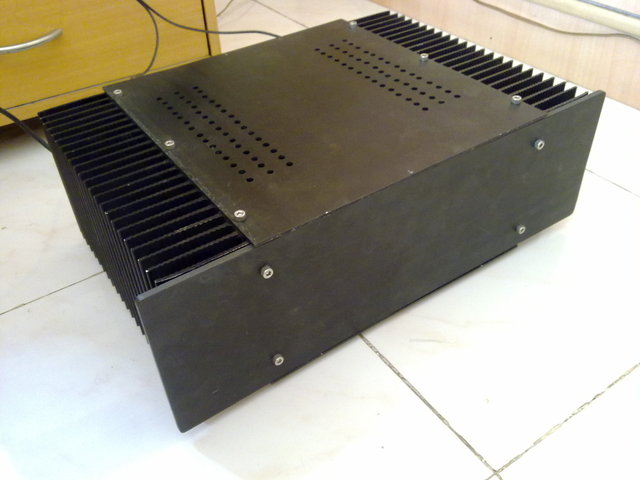

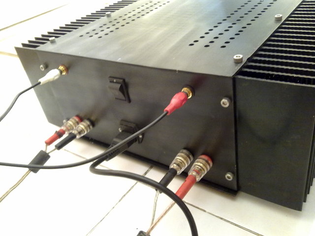

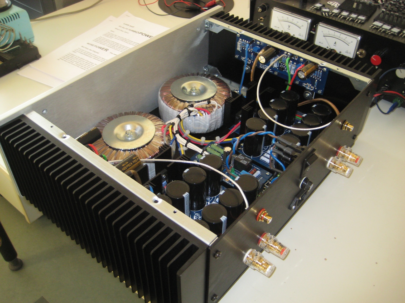

Pass F5 turbo build

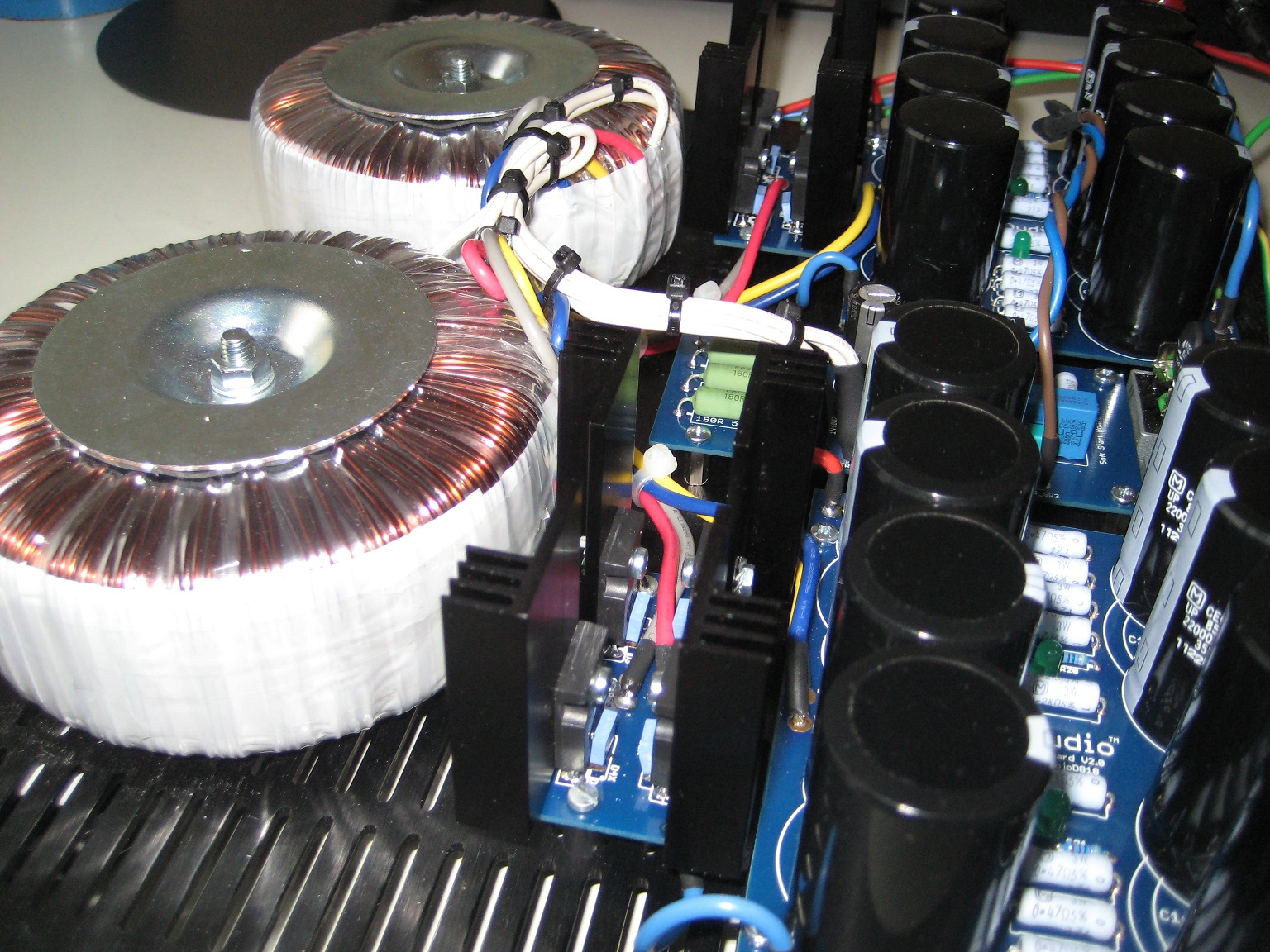

I built this Pass F5 turbo V2 for a friend, biased 0.55A/device on 33V rail. Caps are 4 X 15000µF /rail making total 120,000µF/channel . Toroidal trafo 4 X 24-0 secondaries for transformer making total 1KVA and PCB designed by me for 15 people in Indian forum GB.
Aluminum box is handmade using hacksaw, power drill and set of files; except anodizing.
More coming in F5 Turbo builder's thread.
View attachment 330517 View attachment 330518 View attachment 330519
Is the mains transformer located underneath the large capacitors' PCB?
Yes, those power filter PCBs are elevated above transformer. There is 3/4" gap between transformer and PCBs.
