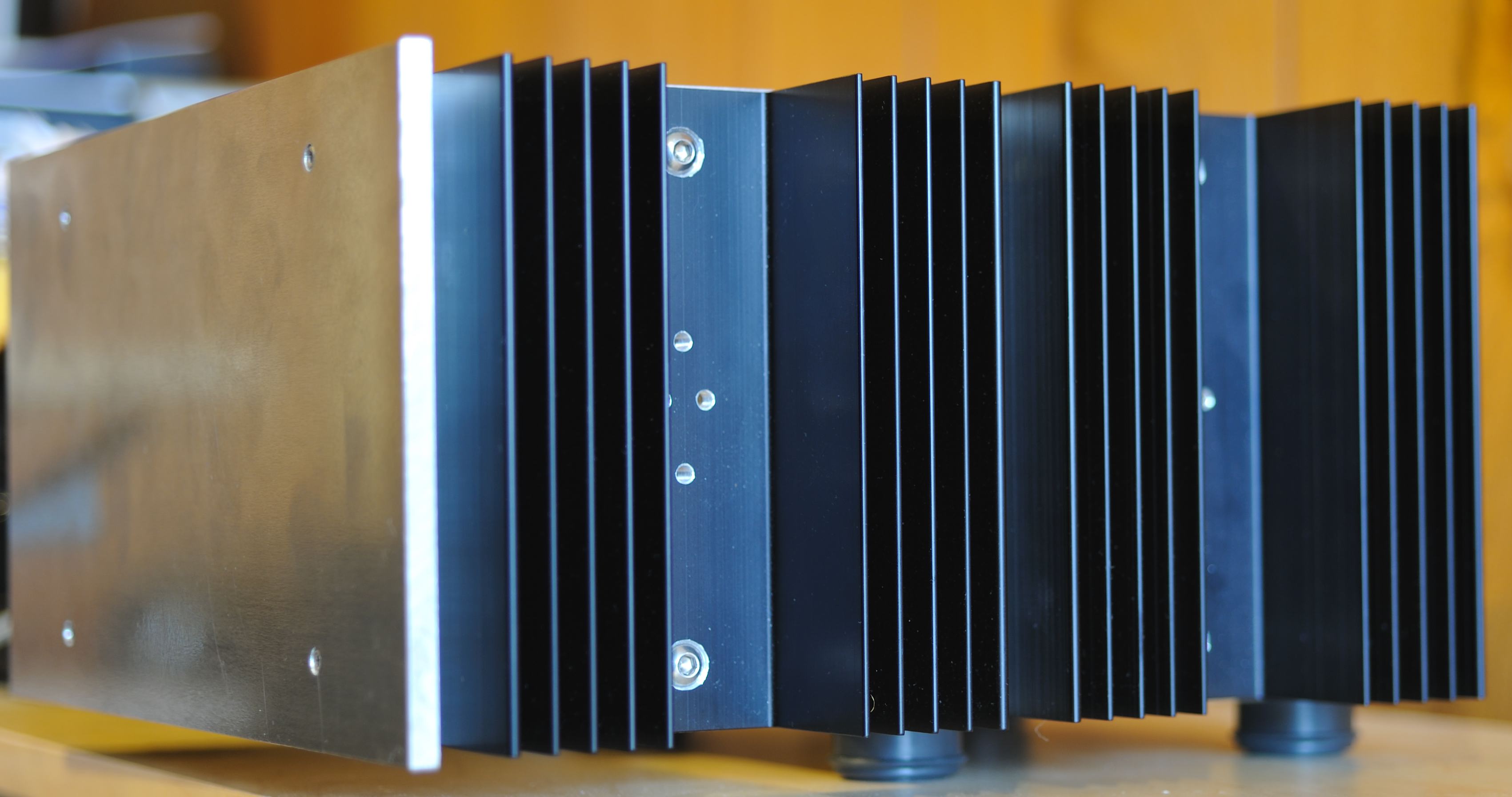

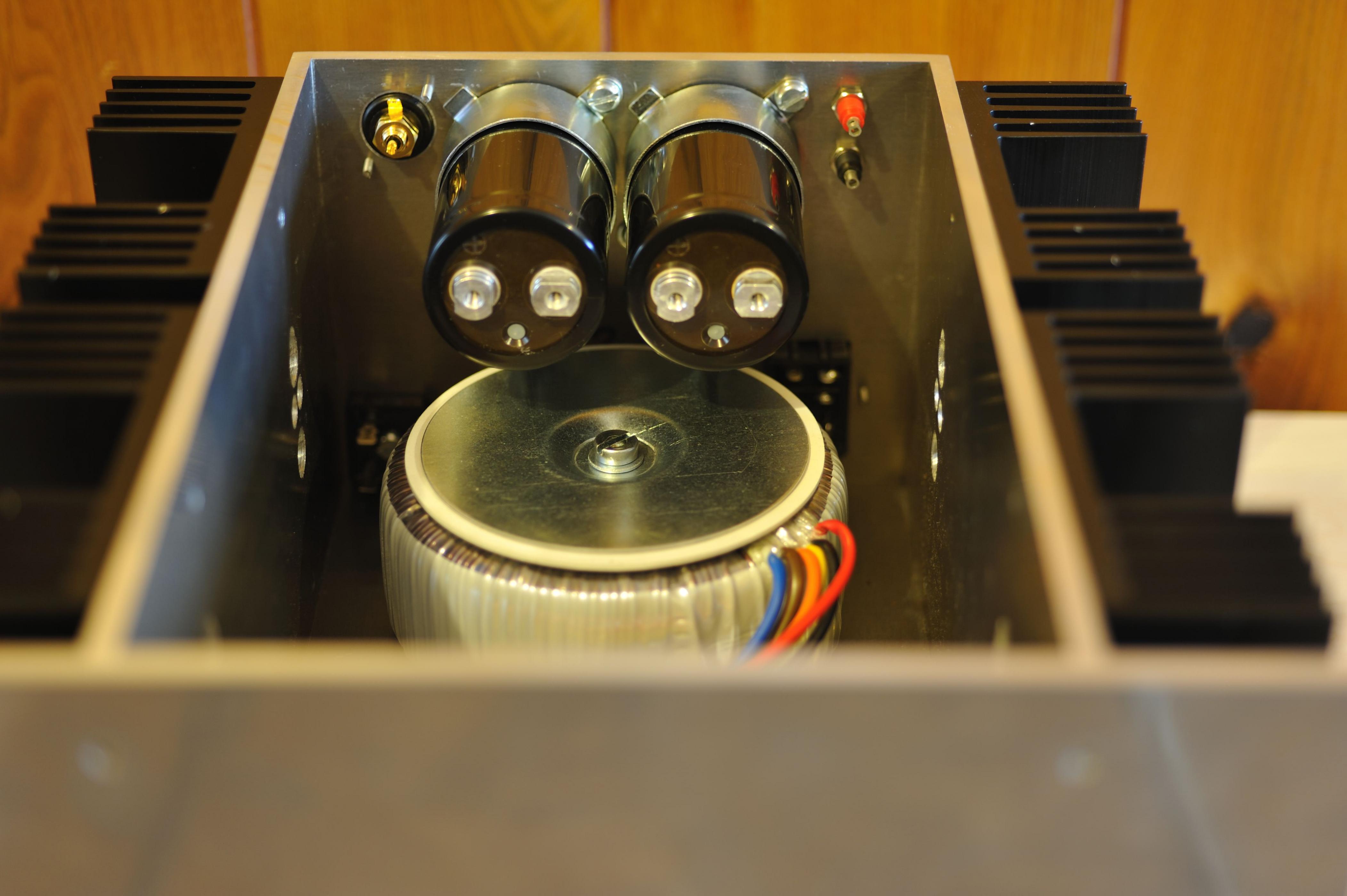

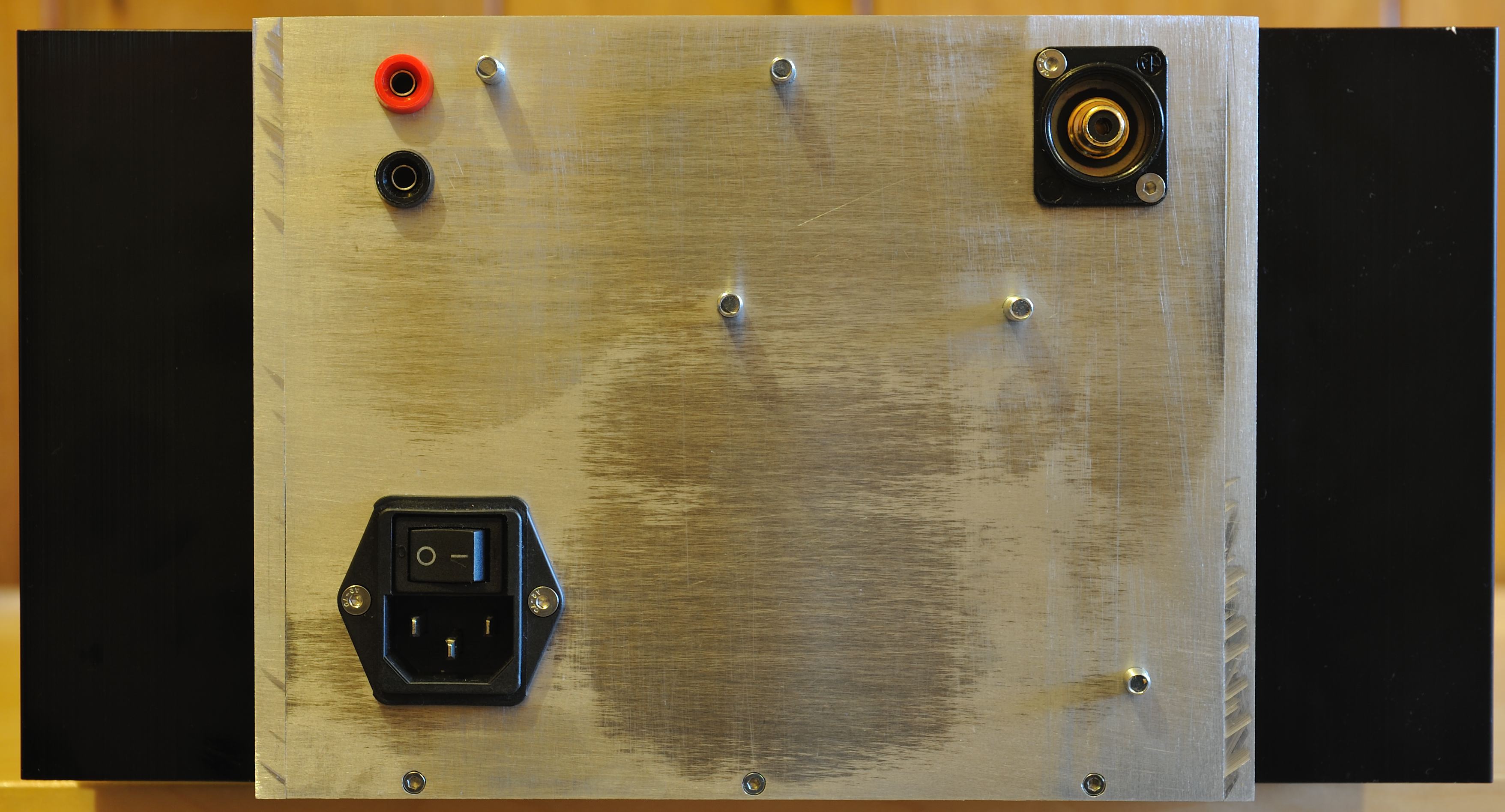

Hello to all, this is my first post on this great audio forum. Thought I would share a few photos of my Pass A40 project. First of all I would like to say thanks very much for the many hints and tips I've picked up from all who have built this amplifier. I have spent many hours reading loads of posts and have finally registered as a member of the forum.
My amps are still "work in progress" but are getting ever closer to completion after a busy two week christmas break spent mostly in my dads workshop. PCBs are built and metal work 99% finished; just cosmetics and case top and bottom to sort out before internal wiring up can commence.
Heatsinks are 0.5 deg c / watt per output transistor; mains transformer is 500va; smoothing caps are both 22000uF.

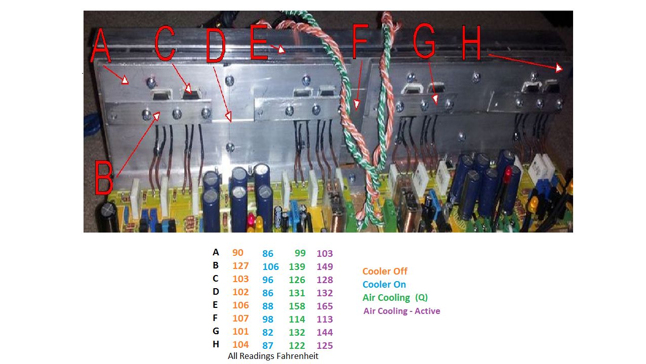

Here is a proof of concept project to incorporate water cooling for computers into a discrete power amp build. There was a successful build with a LM3886 project, but that is a big overshoot.
This type of amp might benefit more with this technique. To stay in the spirit of this thread I'll post subsequent developments and photos on that other thread.
The basic block is built from generic locally and widely available stock. The major element is 1/4" x 3" x 17" aluminum. Mine was cut from a piece of 3x3 angle but a company like Metals Depot has about all one would need. The 1/2" x 1/2 " channel was selected because it provided more "fins" per unit/mounting screw.
The box is from a sheet of 3/8" Plexiglas cut on a table saw with connecting edges polished to 1600 grit wet sandpaper - then glued together with Plastruct Liquid Cement. Metal to Plexiglas meet with a thin automotive paper gasket with Goop on both sides. Blind threaded holes with 6-32 screws were used along with 1/16" x 1/2" angle for reinforcement. For safety reasons the cooling system must be self-contained and completely separate from the amp.
The power transistor mounting plate is attached with 8-32 screws into more blind tapped holes in the waterblock.
The stilts were installed as I thought I would place the cooling system under the amp, but decided I needed to make sure it would work before going to all that trouble.
Success - Amp - cooler combination in full operation in a complete system.
These readings were done with simple IR gun (I bought a new meter with a thermocouple but I put that part somewhere I wouldn't loose it, and....🙄) so they aren't exact or scientific. There is enough information though to warrant proceeding to the next phase as well as learning where the heat transfer can be improved. I suspect I'll be able to use a smaller pump and radiator/fan and still get the efficiency needed.
Readings
The air cooling readings are on the partially "de-feathered" ugly duckling with a few new parts and shorter wires.
Sound wise - the new Audyn Plus input caps have produced a huge improvement in the brightness and stage of the amps. Several other parts upgrades will follow shortly.
BTW - the next phase will be cutting/folding the water block in half to avoid the 17" dimension for better placement (hidden) inside a chassis. Something like this:

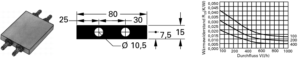

Why go to all that trouble when a professional fluid heat exchanger plate can be had for little dollars, and superior in every way to your contraption.
Size and construction of your aquarium suggest little knowledge of fluids and thermodynamics.
He might like the building and learning process! 🙂
That said, what's sort of Comercial available unit would you propose for such a build?
Think I posted the following picture half a dozen times already.(up to 3-4ft length if so desired)
In Europe, at vendors as Burklin in germany.
In the US, think McMaster&Carr.
See If you can spot the significant differences between that one and bcmbob's cooler.
