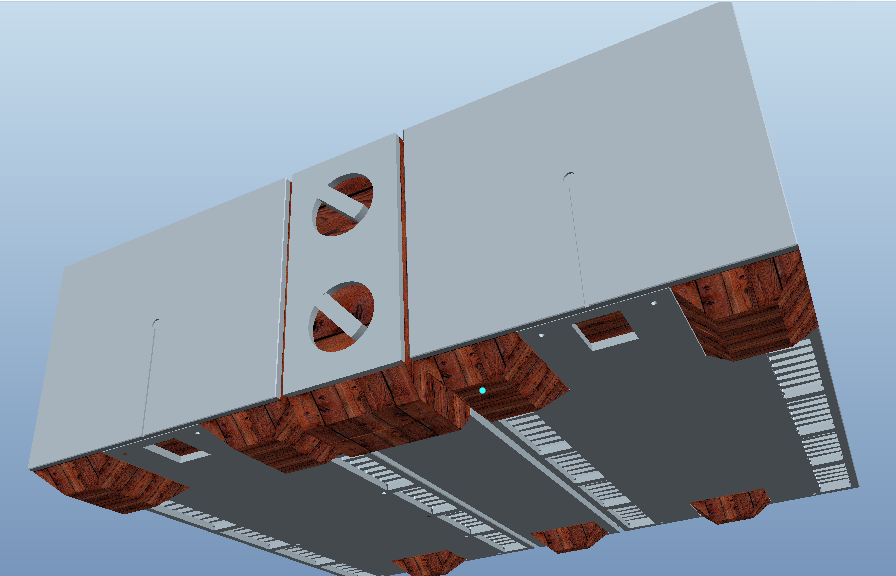

For completeness I felt to add for those who might consider a heat exchanger build themselves, that in most cases it's more expensive to DIY one, plus that the one as-is has several elementary flaws.

It's been a fun and funny morning, but I would also welcome some candid comments about the cooling technique itself. I'm going to play through at least to the next phase, but all comments both pro and con are welcomed and encouraged.
If this thread isn't exactly the proper place for the topic a new one could be started if there is any interest.

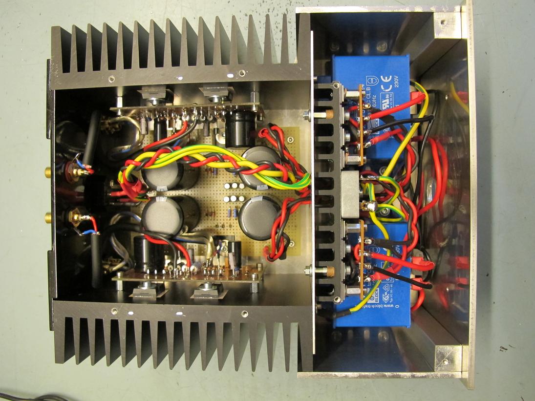

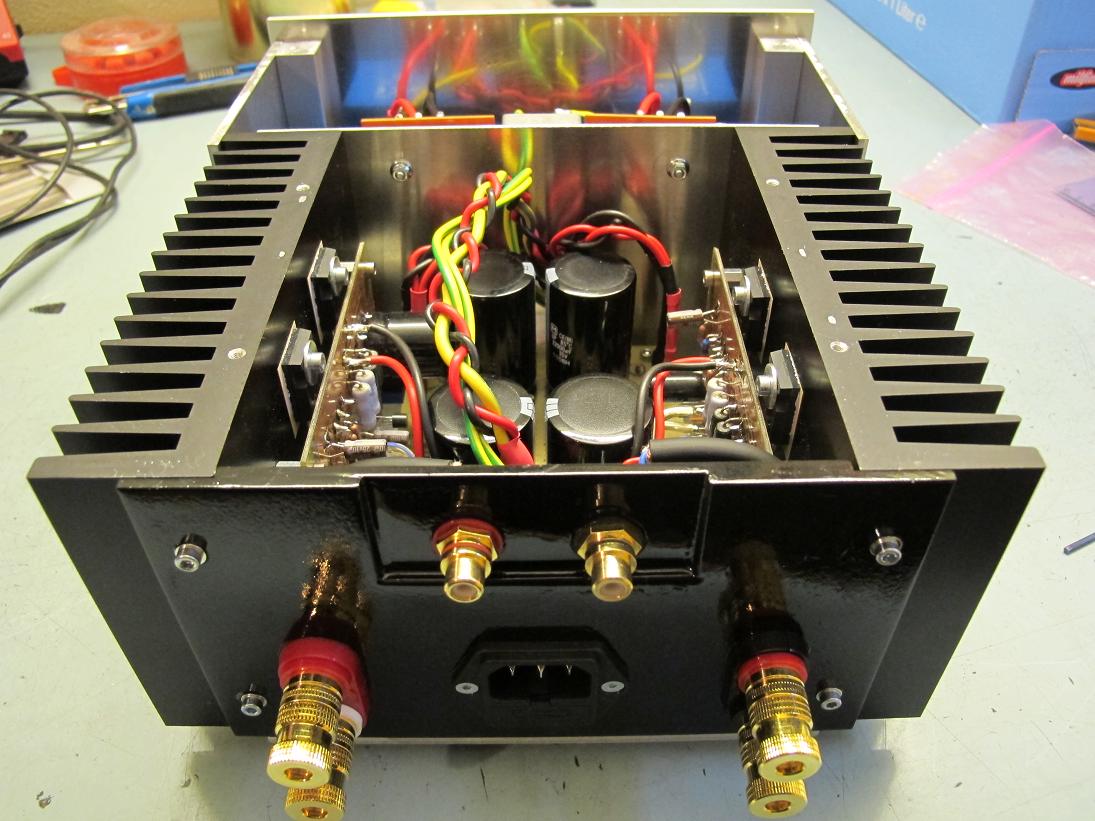

ACA mostly done
ACA mostly build from spares lying around.
Works on 22V regulated Rails. Sounds realy nice for 5 Watt.😀

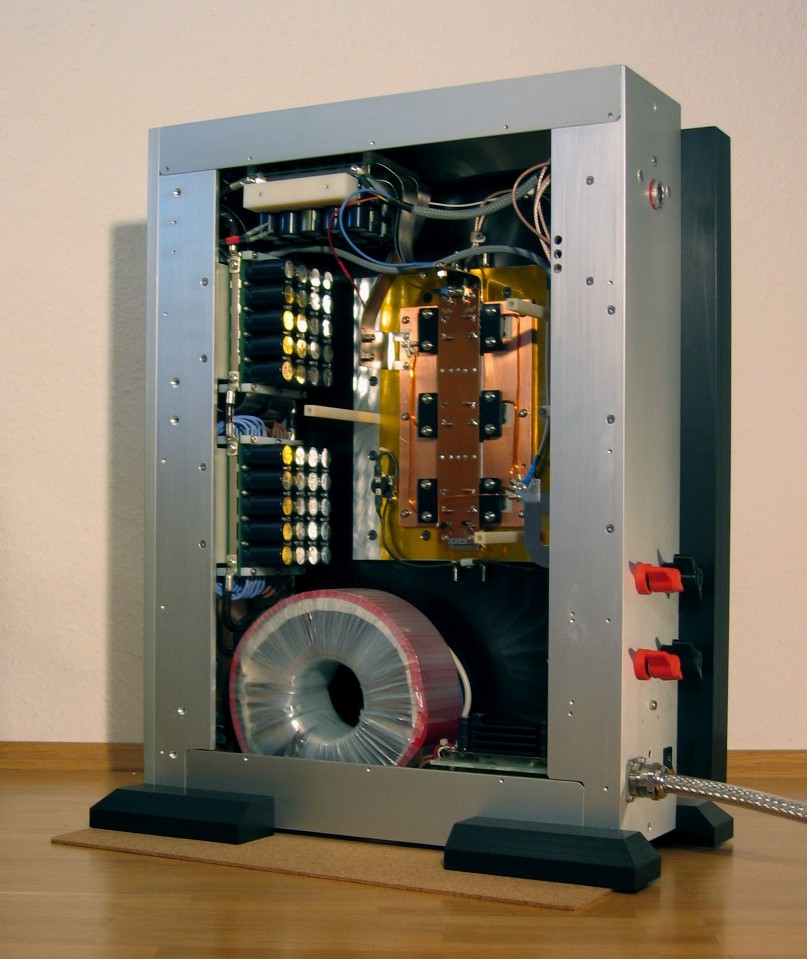

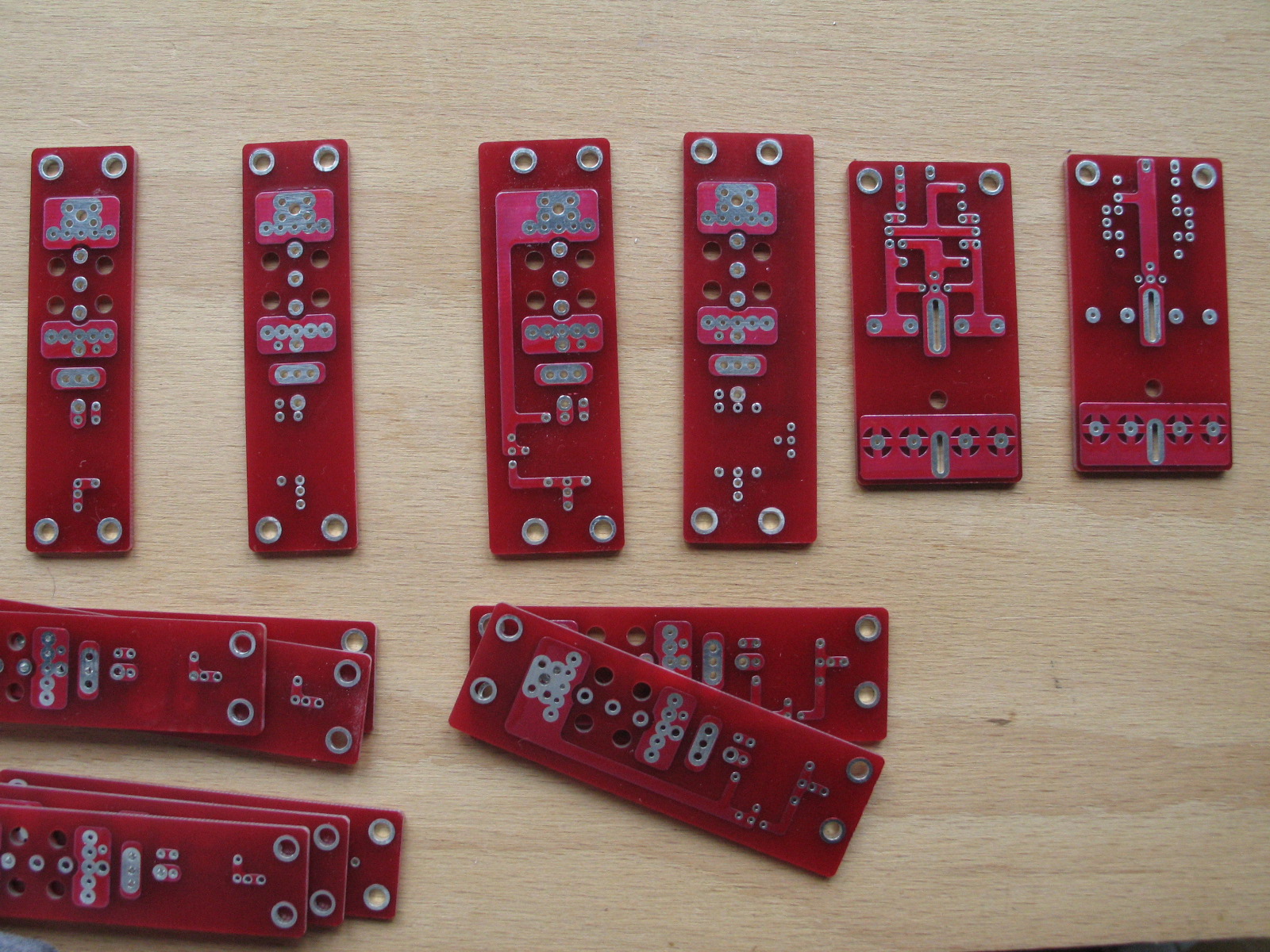

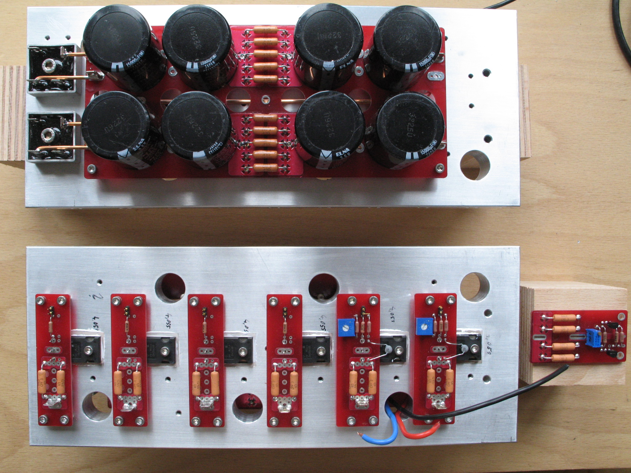

F5 turbo, with modular output stage (V1, V2).

I have been requested by PM to post another one.
Patrick
I am just browsing through the Pass labs forum. Some fantastic stuff here.
This one is stunning Patrick. What have you got the bias set at?
The case work . . . wow, what can I say. Did you do the machining yourself or get it done by a professional company?
Kudos!
Thank you. 🙂
1.3A per FET.
> Did you do the machining yourself ?
This particular one yes, most of it by hand milling.
The front panels and the Speaker terminals were done by CNC.
And I wrote the G-Code myself.
The F5X cases are now done by our own factory.
Cannot do all 30 sets myself by hand .....
Patrick
