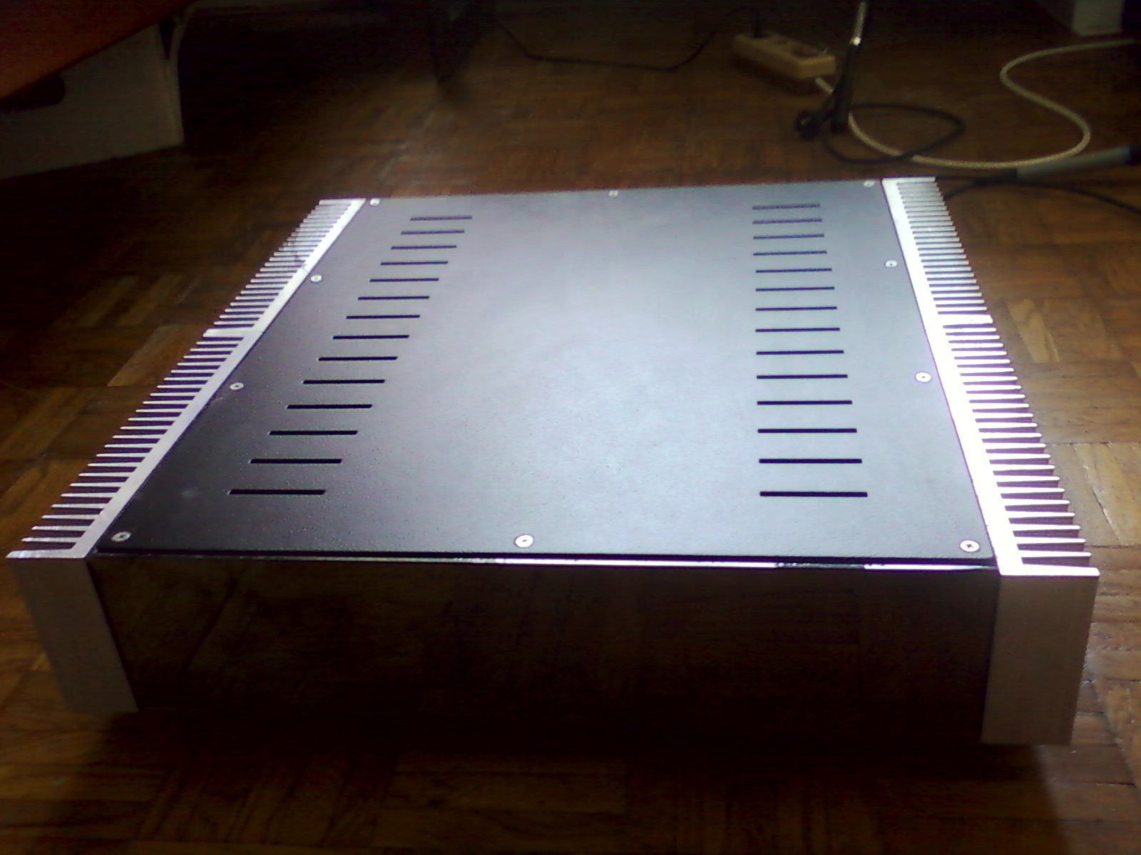

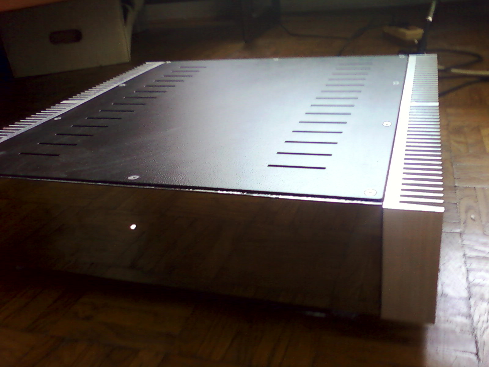

CeeVee: this is a Slovakia made extruded aluminium heatsinks ZH2838, Rth (100mm): 0,79 °C/W see the catalogue 2010 GAMA alumínium | Marian Gahír supplier is by the same web

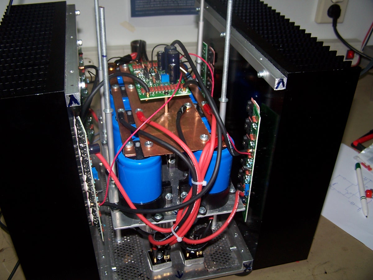

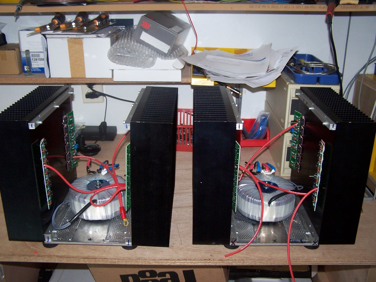

400mm(heatsinks) 10cm height
my mistake 50cm depth,10cm height

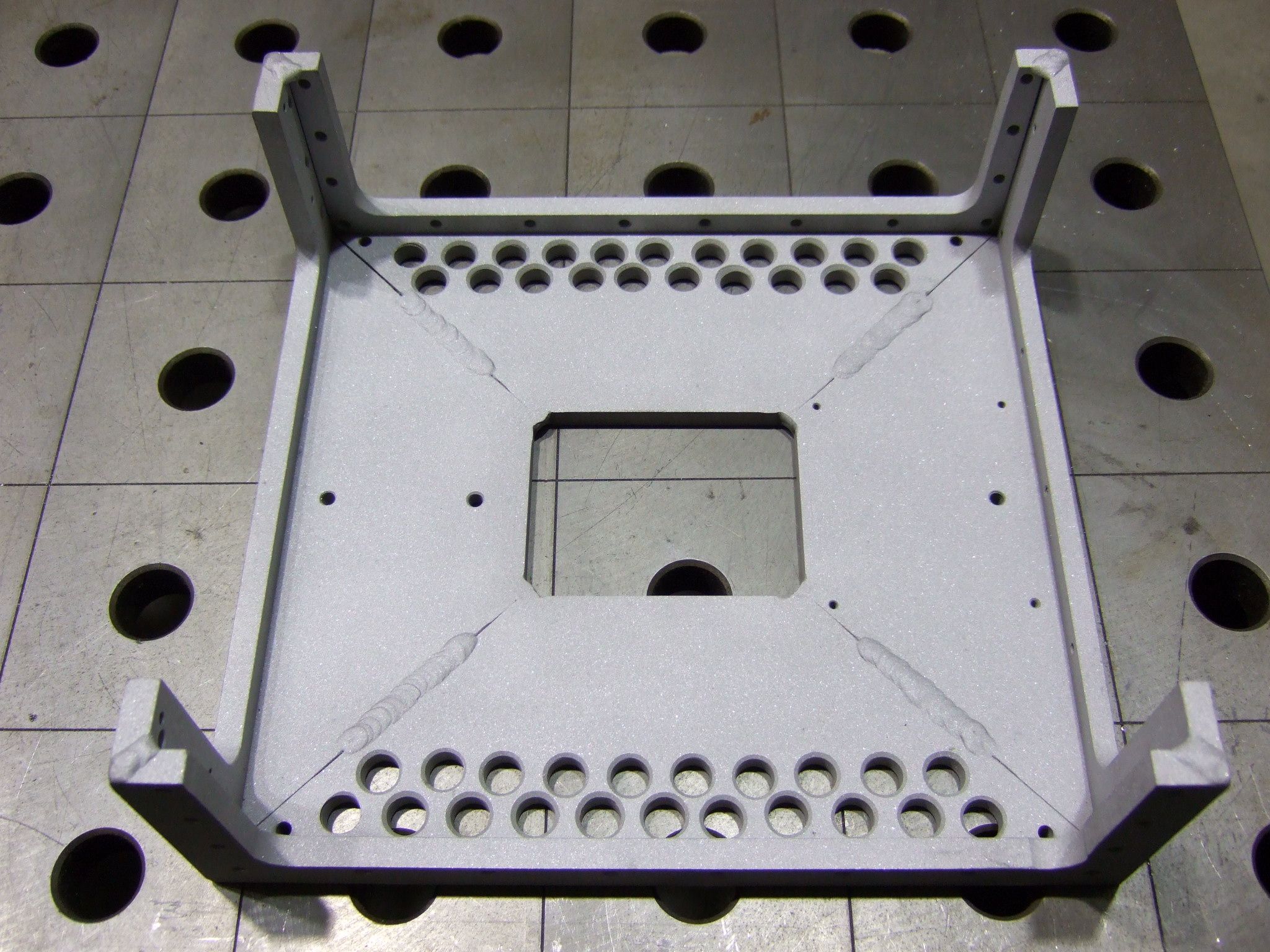

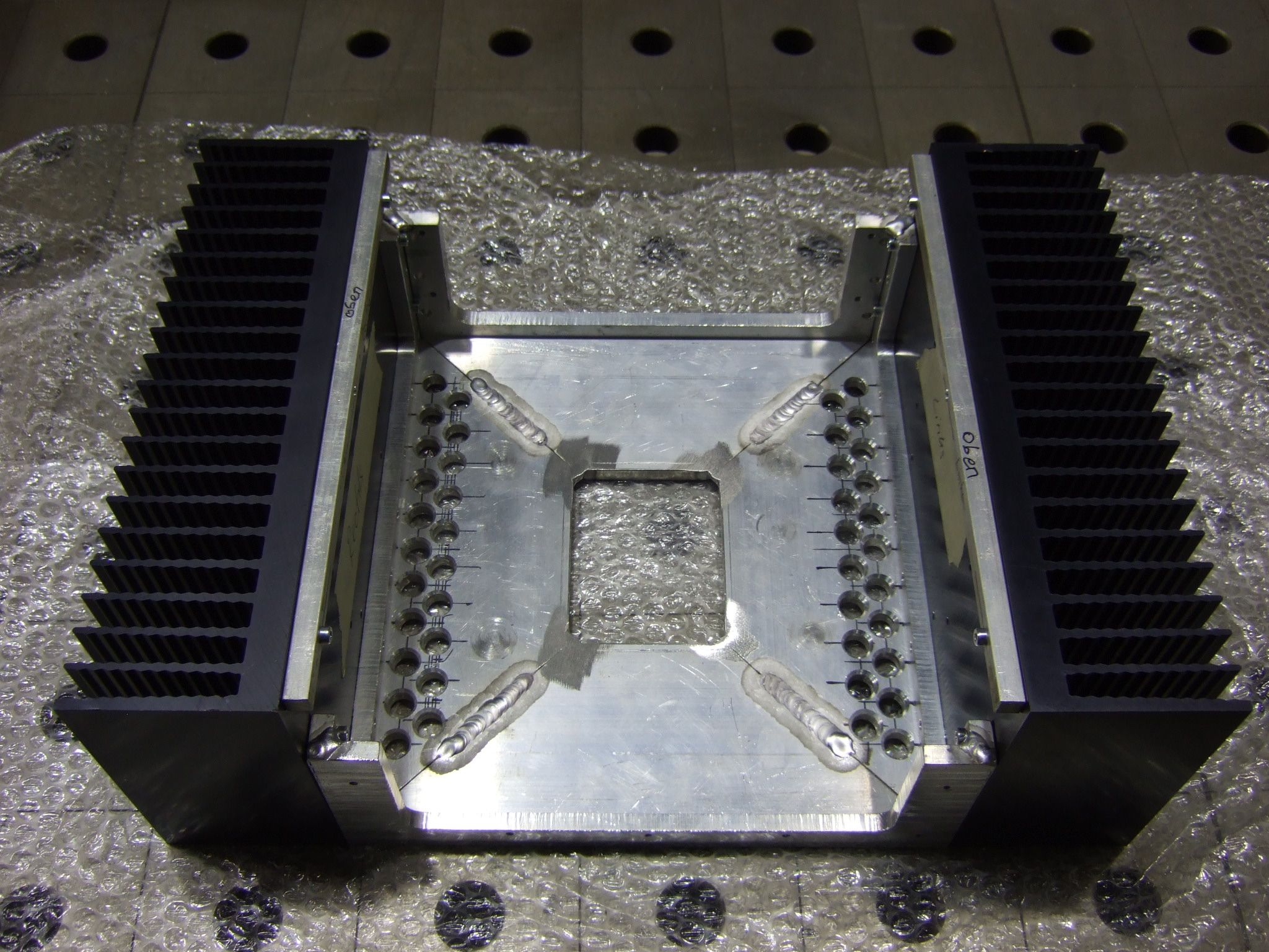

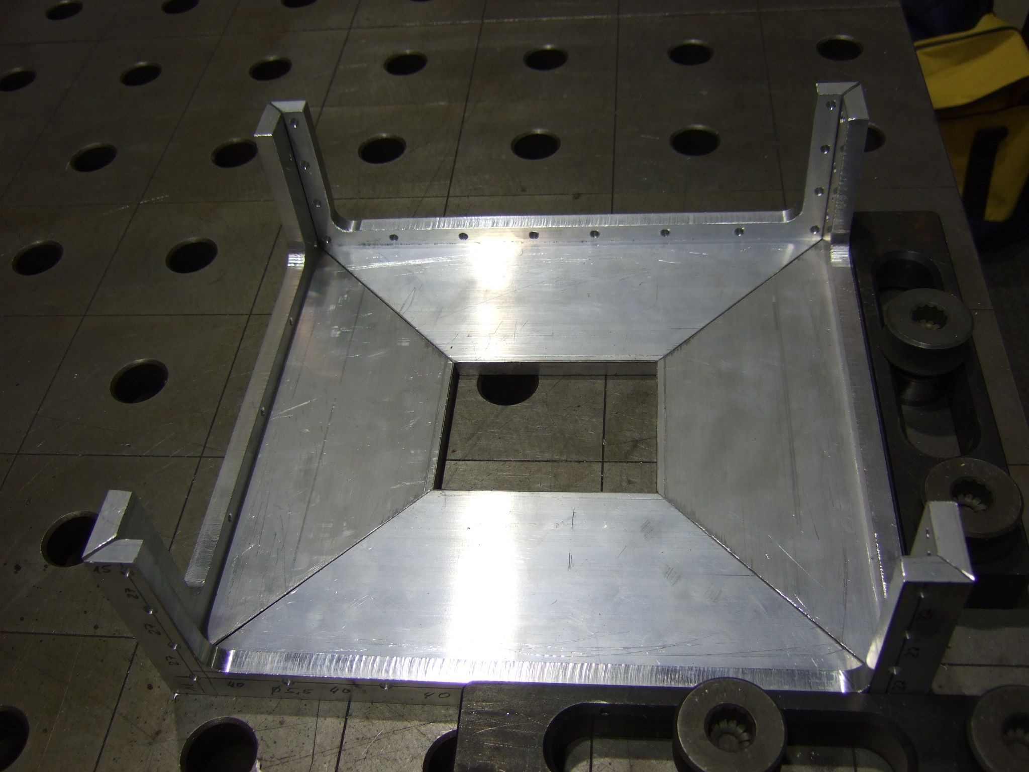

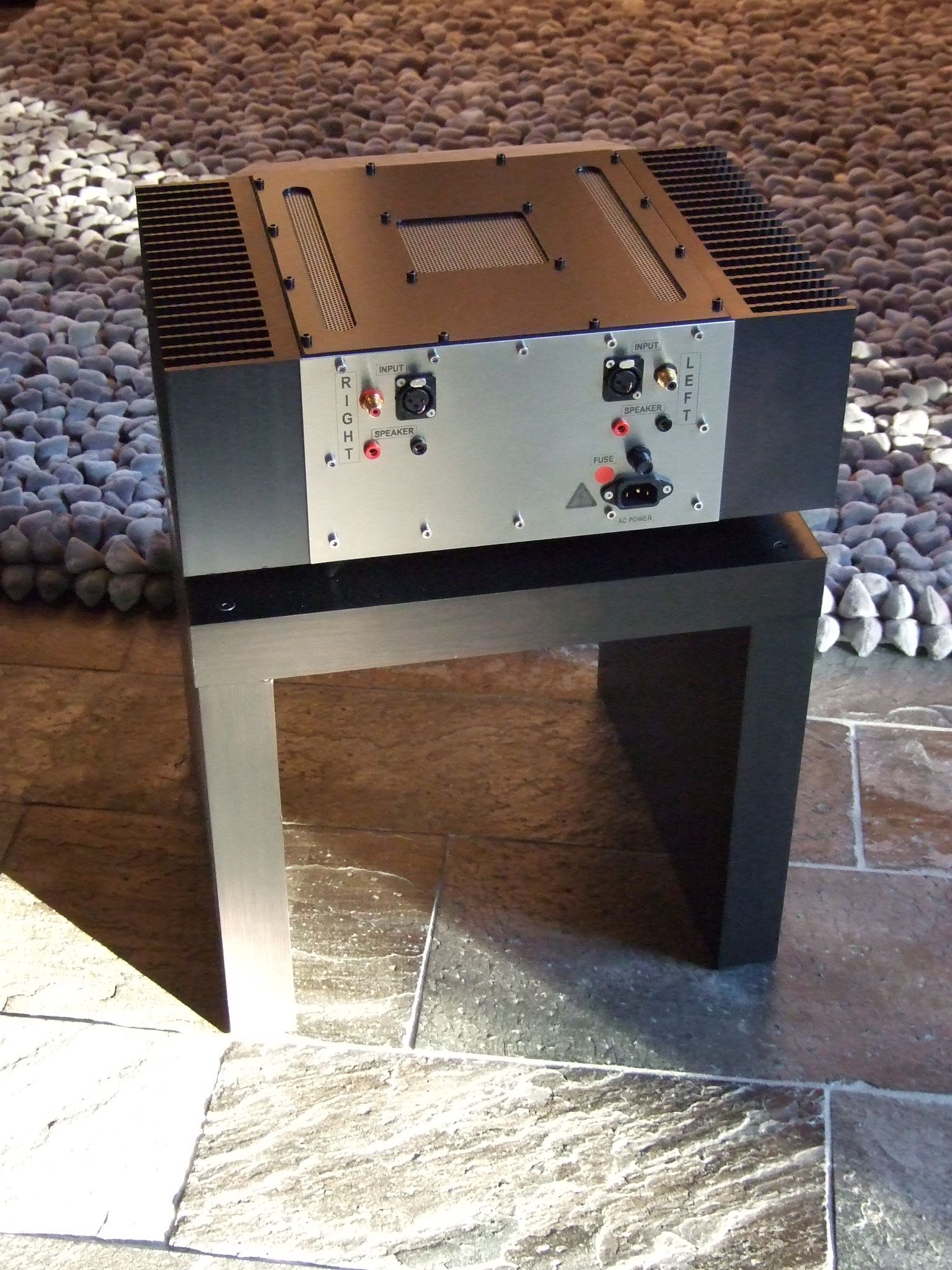

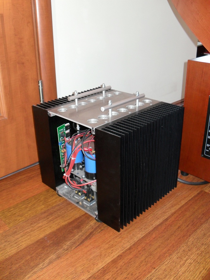

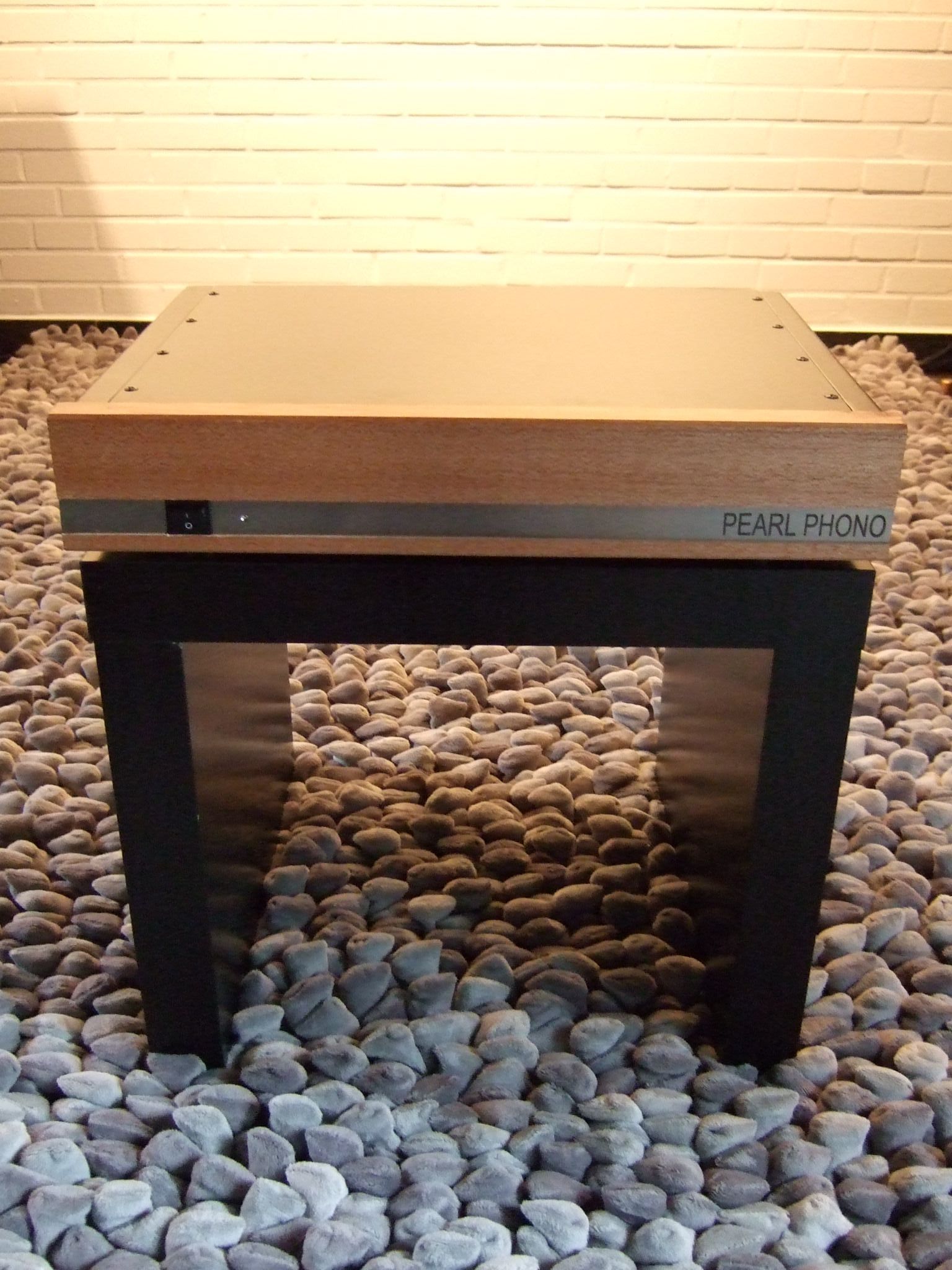

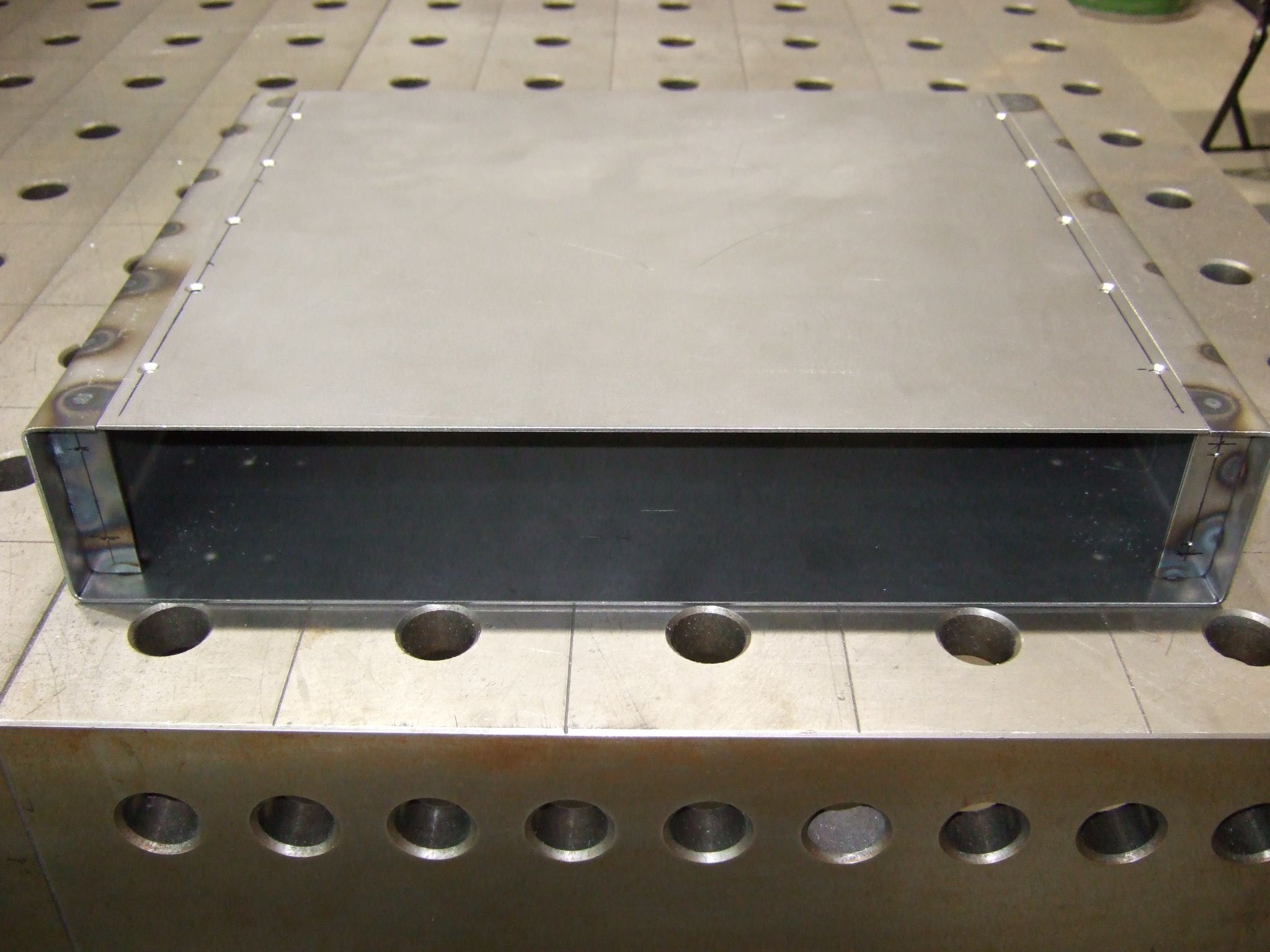

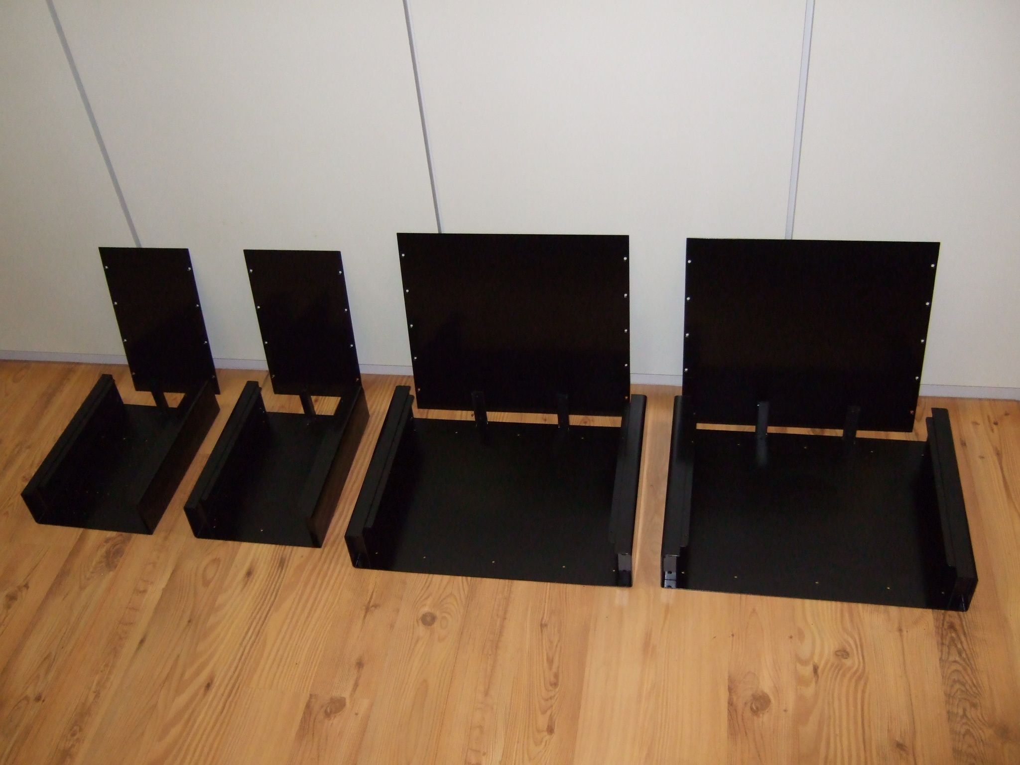

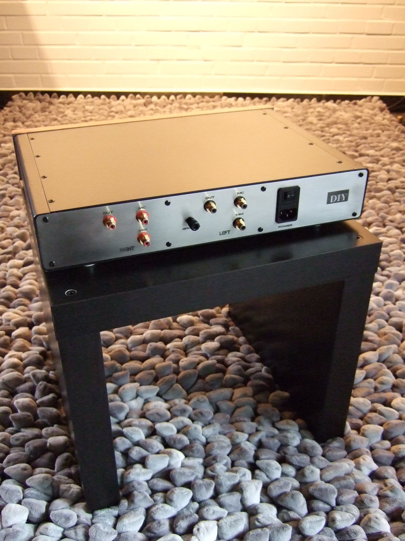

Here are some pictures of building the cases and some finished ones which are waiting to fill up ...

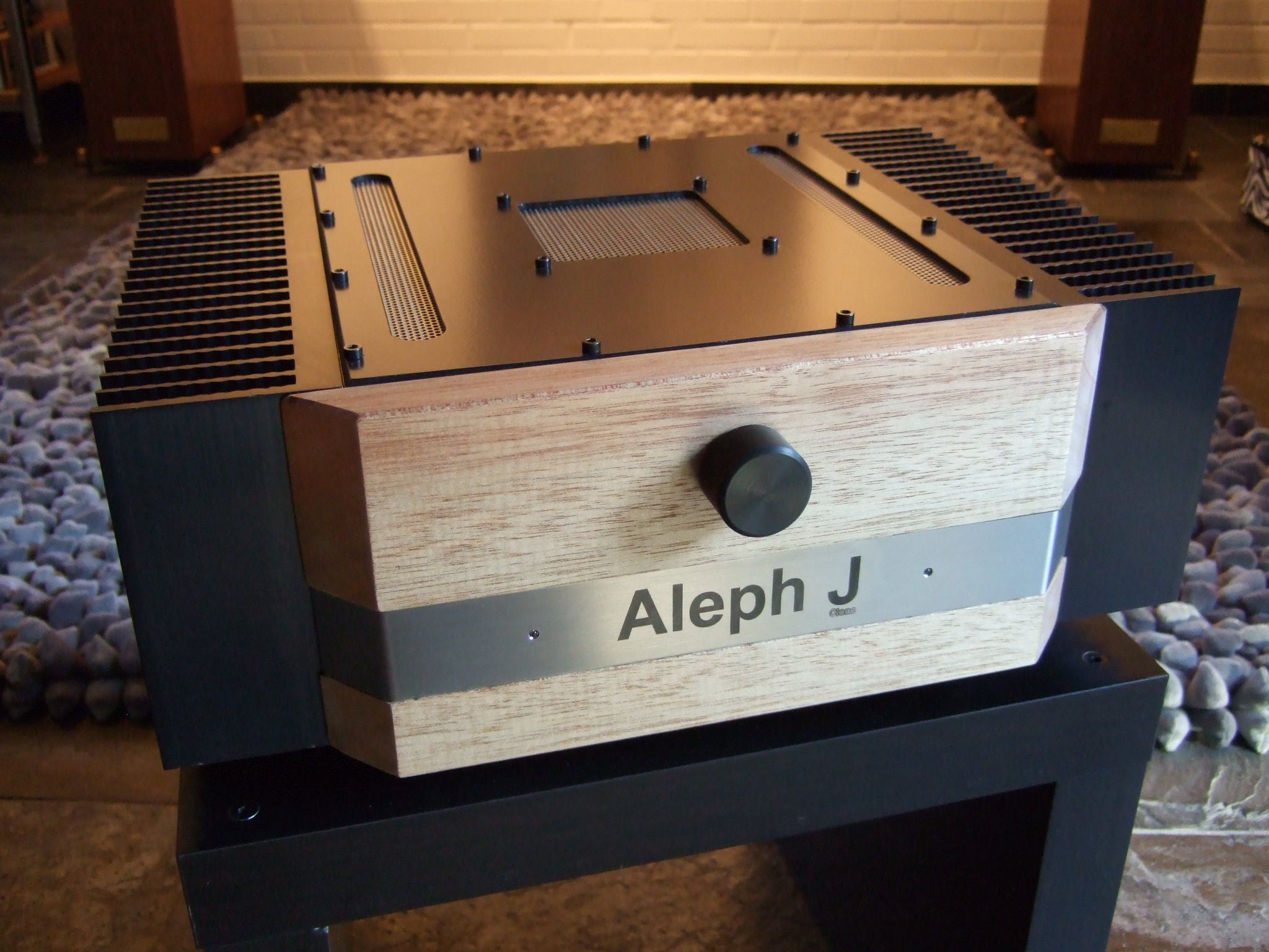

For the Aleph J I took aluminium, the finish is sandblasted and the case for the Pearl is bended of sheet metal, mild steel, thickness 2mm.
Nice aluminum welding..... beads like "a roll of dimes".....! 😎
