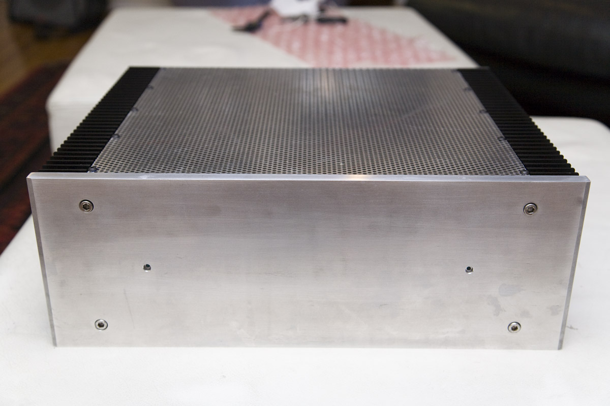

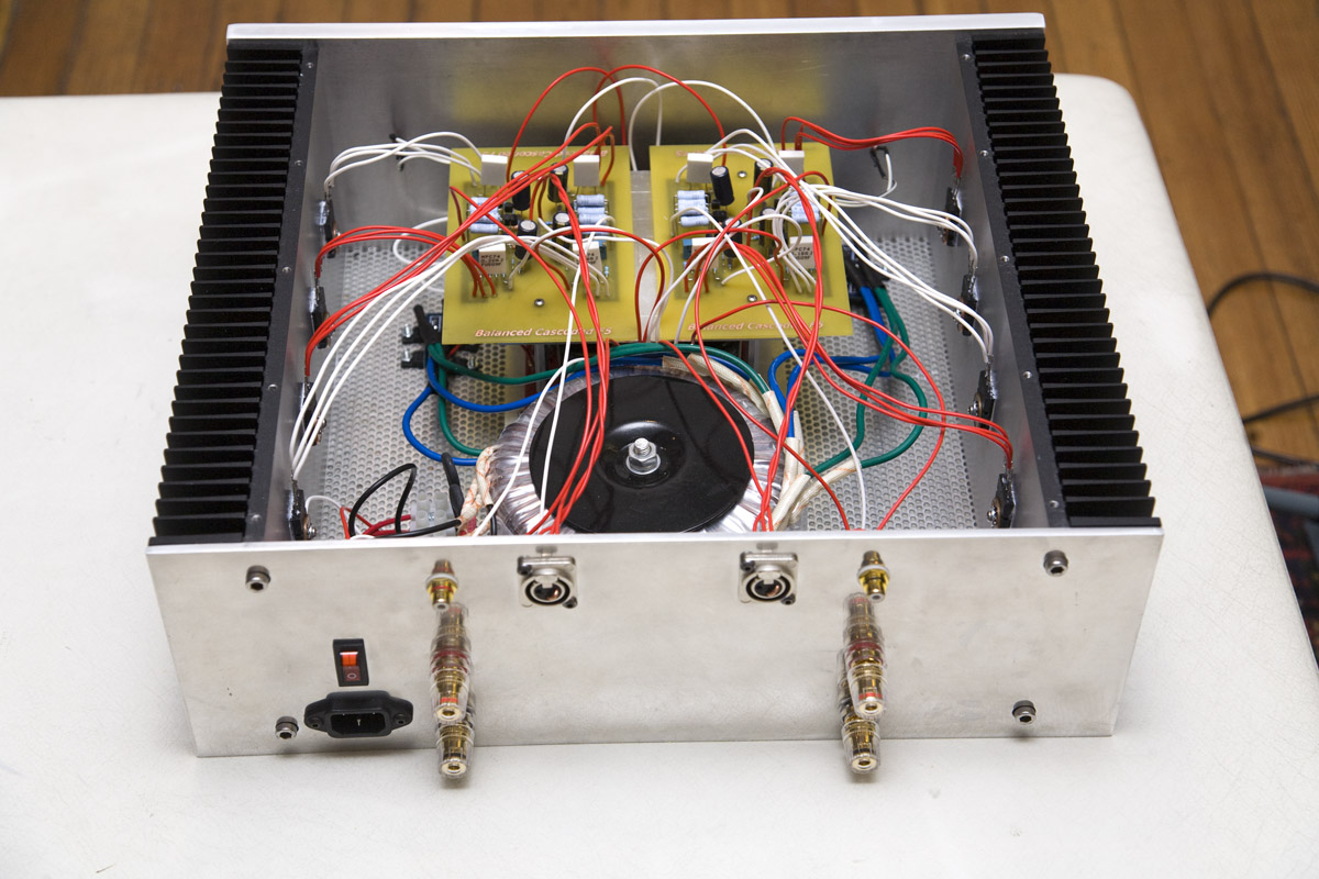

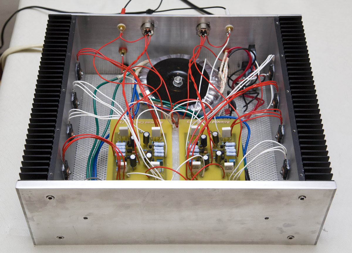

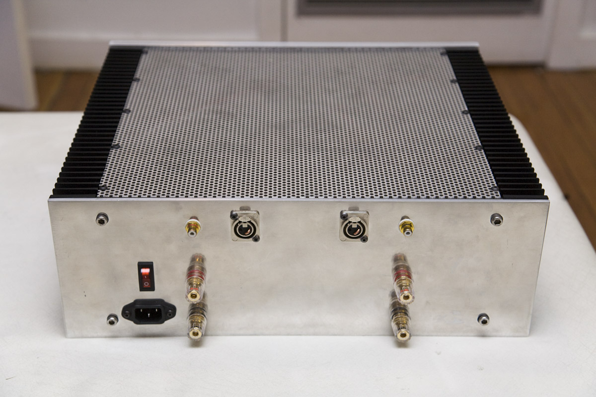

Cascoded - Balanced XF5 for ~$600 with the finest quality parts
I posted this build in my F5 thread, but I'm sure this thread has different followers. The photos are of my Cascoded Balanced XF5.
I used:
I'm putting together a "How To" on the build, including the PCB layouts. I'll post it when I get it all together. If you're interested, let me know.
I intend to clean up the wiring when I have a chance, and change the toroid to the front of the case, from the back. I'm in process on two more F5 variations, hopefully they turn out as well.
I used:
- 12v - 800VA Antek toroid (capable of 1000VA)
- Matched Toshiba 2SK1530/2SJ201 outputs - 4 pairs from ZhouFang
- Matched JFETs (2SK170BL and 2SJ74BL - with differential match for degeneration)
- Two Conrad MF35-151.5 Heat Sinks
- Custom case with 1/2 inch Aluminum faceplate, balanced and RCA inputs
- Fukushima resistors
- 8*MSRF1560 Ultrasoft diodes
- Custom PCBs
- Power Supply - CRC (in the style of the F5 Power Supply). Currently 8x18000uF, will be 4x 68000uF when I upgrade the case

NY - very nice DIY case - i like those immersed bolts!
Thanks for the props, but I didn't build the case - I don't have any real tools (I finally bought a drill press of PCBs and a router to make OB speakers). I'm about to post a how to thread on building your own. I'll post all the sources in that thread.
