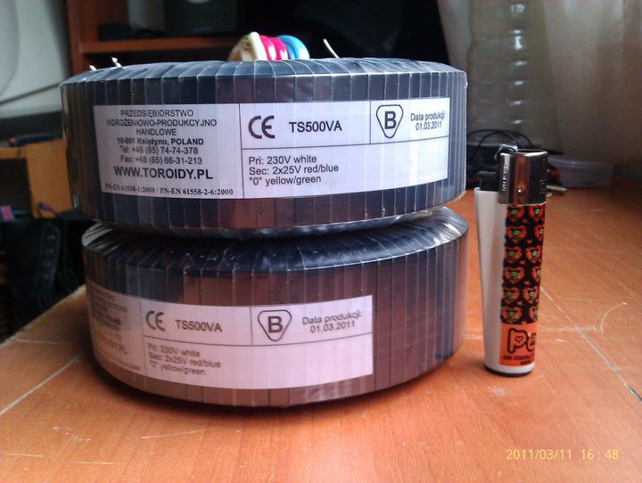

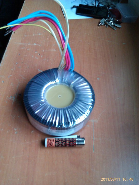

Is that toroid from Toroidy.pl?
yes indeed, very nice , the amp absolutely dead silent.😎

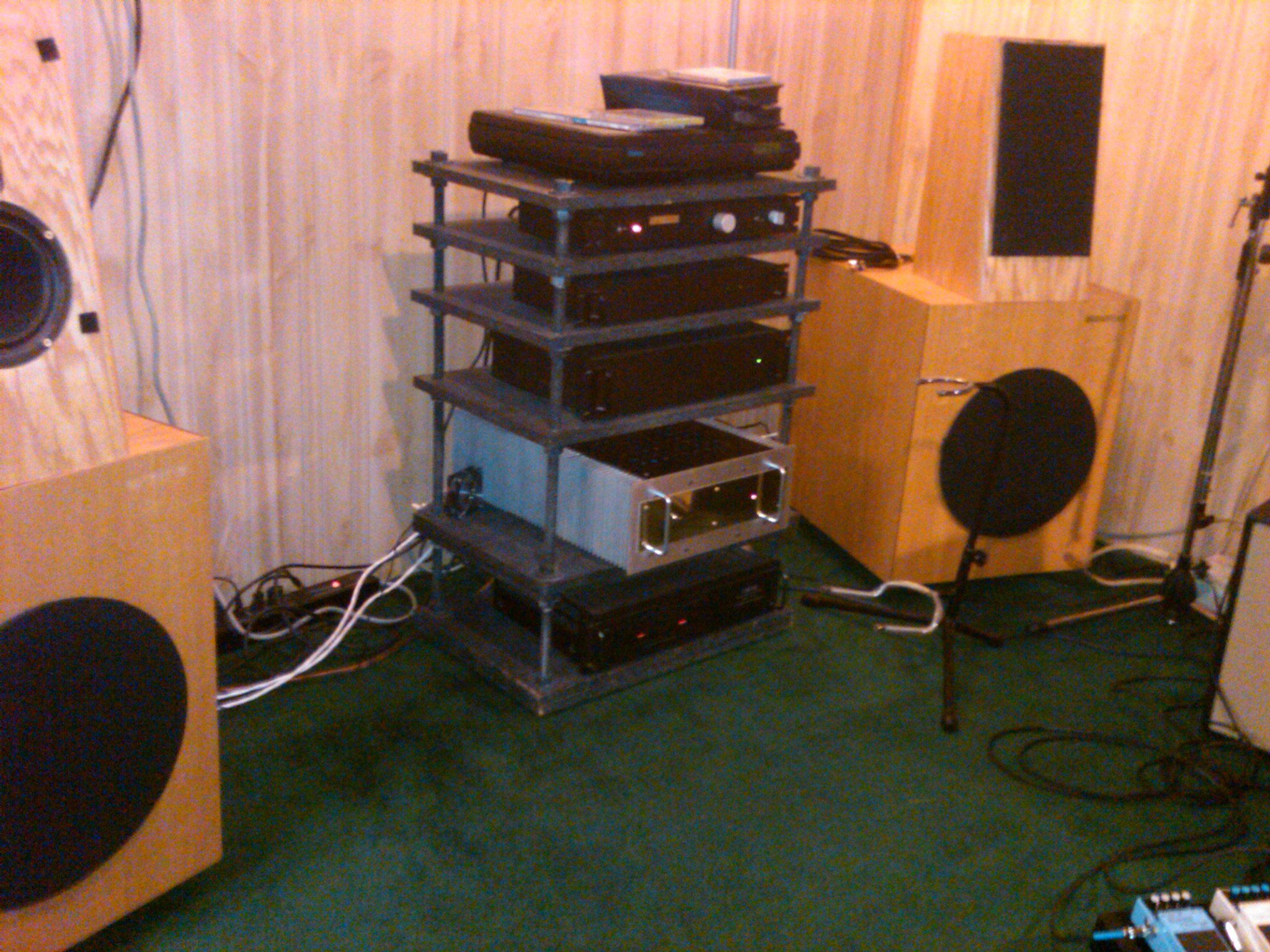

The Pass A75 and system I built 15 years ago. Preamp is also an actie x-over. Biamp setup with the A75 driving the sats and the Carver driving the subs. Outboard DAC using BurrBrown chips...forgot which ones.
Just received two of them a pair of days ago 😱 They have an extra wire for the inside shield. They're potted. 500VA 2x25vacyes indeed, very nice , the amp absolutely dead silent.😎

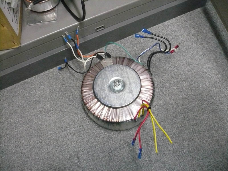

for mains AC there is always solution - either routing it under technical bottom of amp ( perforated one on pics ) or shielded ( as on pics with black bottom )
note that Papa is not loosing sleep about that ....... so that must be illustration of importance ( remember Migty ZM's interpretation of Papa's details - "... good enough "
I agree that other power routes are of more importance ....
this pic deliberately posted
and then - shielded mains cable
this one - not shielded mains cable , but routed under technical bottom
that black central thingie is just route from static shields to sole safety gnd point on chassis

Edit: I particularly like the "routing" of picture 2....

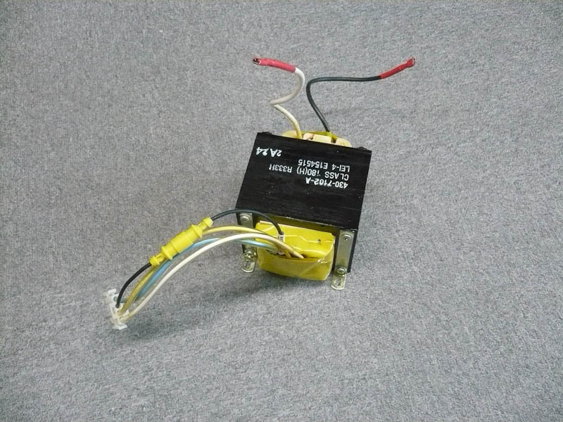

Few weeks ago I received in the office a bunch of junk to be disposed. Most was real junk, but many things stayed.

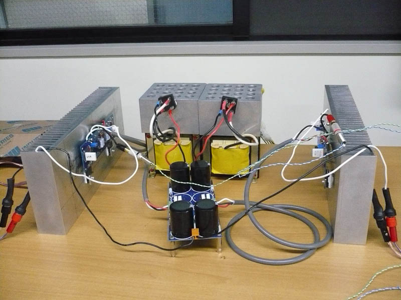

There some pictures of the Junk F5, waiting for an inspiration for a case. The idea is to have two monoblocks, each will have two of the black ugly transformers and one heat sink. I was thinking about putting the heatsink on top. It's not ideal but it should not be so bad.
With this trasformers I get only 13 V but I think there is no limit to current. At the moment I am using Toshiba mosfet biases almost 3A.

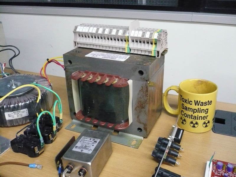

I also have a couple of these monsters 3.5 KW step up transformers. I could get probably 40 V using them the wrong way.
Suggestions on how to box the monoblocks are welcome !!! Actually this is why I posted them.

You don't want to know what the Al blocks on the transformers are and where they come from 🙂

Those Alu blocks look very nice..... tells us more.
O.T. Everything OK for you Davide? I do hope so. I saw that yellow mug on your desk and I immediately thought of what is going on not far from the place you live....
Now it's better, although the building is shaking while I am writing. Family had to evacuate and I have a lot of time for DIY. (Let's see the bright side)
Actually all these components were dismissed from nuclear facilities, blocks included. They are used to keep samples at constant temperature.
