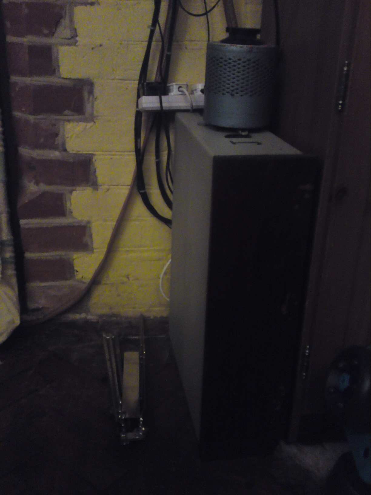

To explain the poor pictures:
The power supply for the SOZ is housed in an old IBM 286 PC case with a wooden plank on the front. This contains a huge standard transformer I found which has high current secondaries at 55-0-55 and 110-0-110 (and various additional taps I'm not using) - This beast was built for a large rack-mount fire detection system. I forewent the inductors in the recommended power supply and just used large number of Phillips 1000uf military grade caps. Separate secondaries supply the left and right channels. The 0-240V mains is supplied through the obligatory variac.

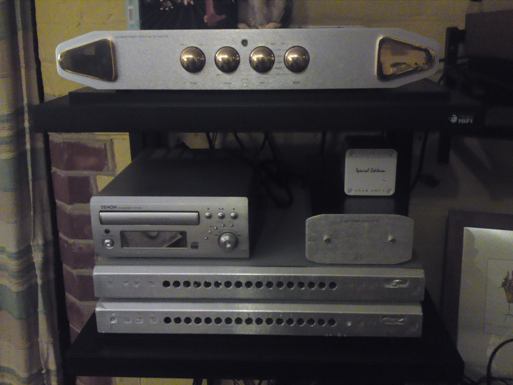

The SOZ amps are shown at the bottom of the 2nd picture. I used (slightly scratched so rejected) cases from CCTV equipment. Each has a rear/top/centrally mounted 110V AC fan, for cooling, powered direcly from the tramsformer 110v AC secondaries. The resistors are mounted on a lateral metal plate within the from half of each unit while the mosfets are fixed to heatsinks on either side towards the back of the cases. The colling is actually quiet up to at least half power. I never run the amps above 20V (30% on the variac) as there is no need to. I have central heating and I worry that I haven't adjusted the DC bias in a long while:)
I use an Alchemist Forseti Pre-amp. This was the first and only pre-amp with a balanced-line output I could find here in the UK. Don't tell me it's a poor amp without listening to my system first!!!!

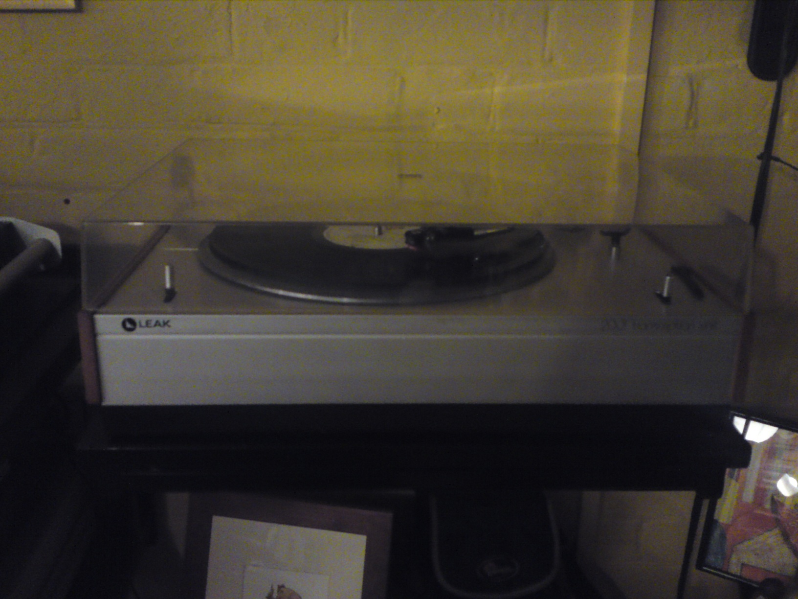

The last photo shows my pride and joy: a Leak 2001 Transcription Unit turntable with Shure V15 mk3 cartridge.

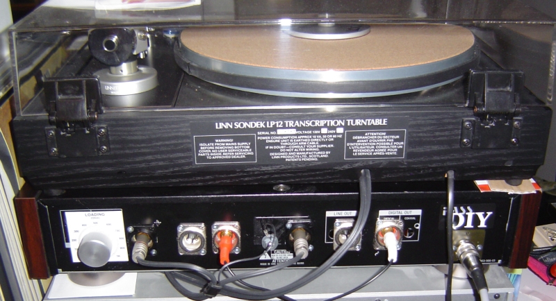

Hi, here is my Pearl II, sitting with my LP12.
On the backside, from the left, the load impedance adjustment (10 ohm ... 1kOhm), followed by the input and output of the left channel, the ground terminal, and the input and outputs of the right channel. To the right, the connector for the external power supply (thats a "brick" with a 60VA toroid, followed by two separated paths with bridge rectifier / caps / cap multiplier), feeding the phono stage with pretty good DC. (Less than 1mV of noise, under load). Glad I put that connector so low, that left some space for the PassDIY sticker ;-)
The symmetrical connectors are not used at this point, since this was supposed to be the "test bed" for phono stages but for now I just enjoy the music...

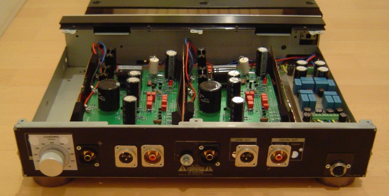

Inside, the two PCBs sit in individual “chambers”, all star-grounded at the back panel. On the right side is the input filter for the power supply coming in. When cranking up the volume, there is only a little bit of hiss but no hum so I guess thats a good sign.
The case is salvaged from a Sony satellite radio, the wooden side panels going along nicely with the turntable case. All I had to do was to make holes for the connectors, and create a new frontpanel (just a rectangular piece of aluminum, with two LEDs).
what should I say.... after a couple oscillation issues that were solved with the help of wayne and nAr, it works beautifully!

Nice to see your pics and the fact it works fine now :) Enjoy :cool:

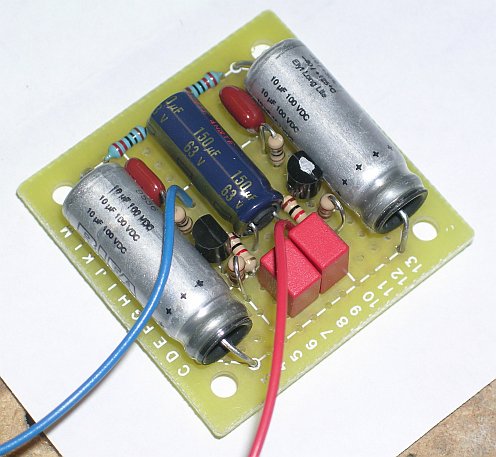

well its not really and amp but still mighty powerful.
I love the jboz , 3rd one this year.
getting the layout down - took about 45 minutes to build, all p2p and it worked, which is always nice.
not sure where it will go, the other I made loves working with my 6em7 amp. really tightens up the low end. thanks again Mr. Pass for a simple and wounder design.:D:D
here is a pic - enjoy,

Cute as can be!

It definitely encourages others to give it a try.
Nice work.

Curious, what's this ?

I dont think there is anything under there except wires. Maybe thats what you were looking for, but here is the schematic. Well, its one of the schematics that Pass posted but there were others from I think both Lineup and EUVL and probably several more. People were commenting that this pdf was gain of 50 and that a source resistor of 100R might be better for a line stage but do your own research on that as I picked that info up at about 1AM this morning and am not sure I am right.
