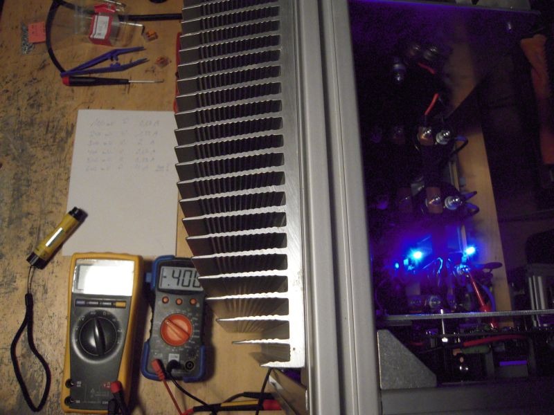

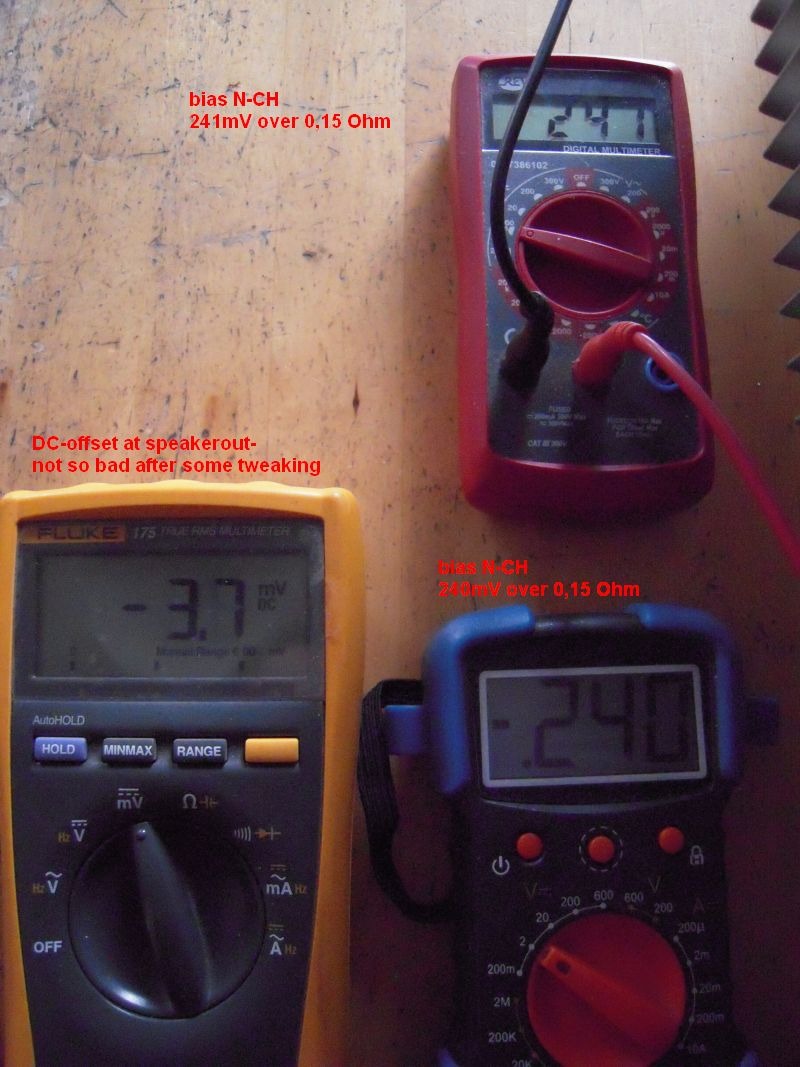

after some tweaking...
It seems I can get the values into the ballpark?!
-3,7mV DCoffset (at speakeroutput) is good. But I ran out of wiper at the trimpots to bias higher.
I have to change some resistors... The adventure continues.
Cheers

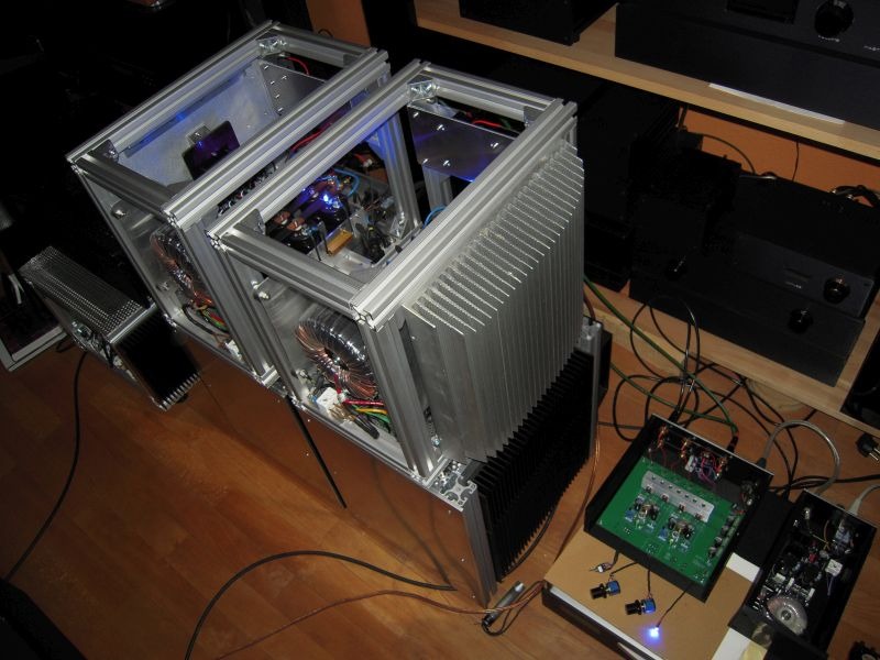

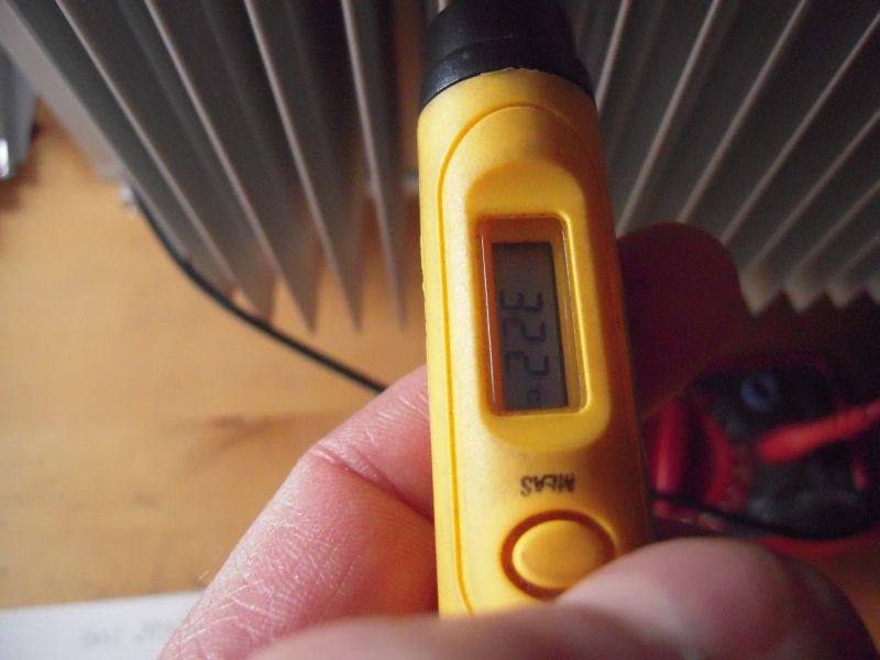

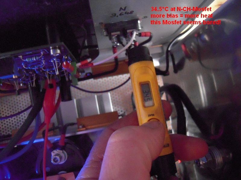

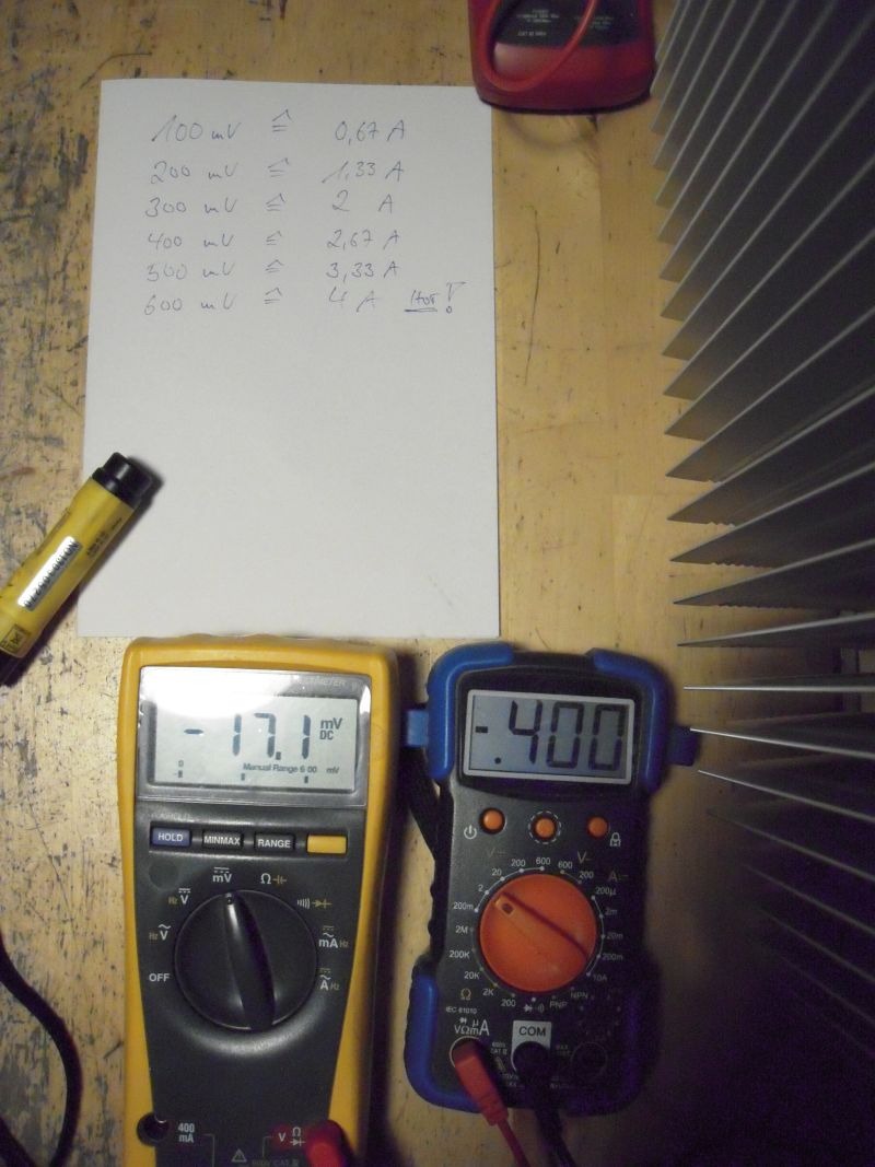

Hello out there,
i have biased the 'baby' to 400mV over the 0,15 Ohm resistors. So I am at around 2.67 A.
After 30 minutes I measure around 38° C at the outside of the heatsink (where the Mosfets are inside).

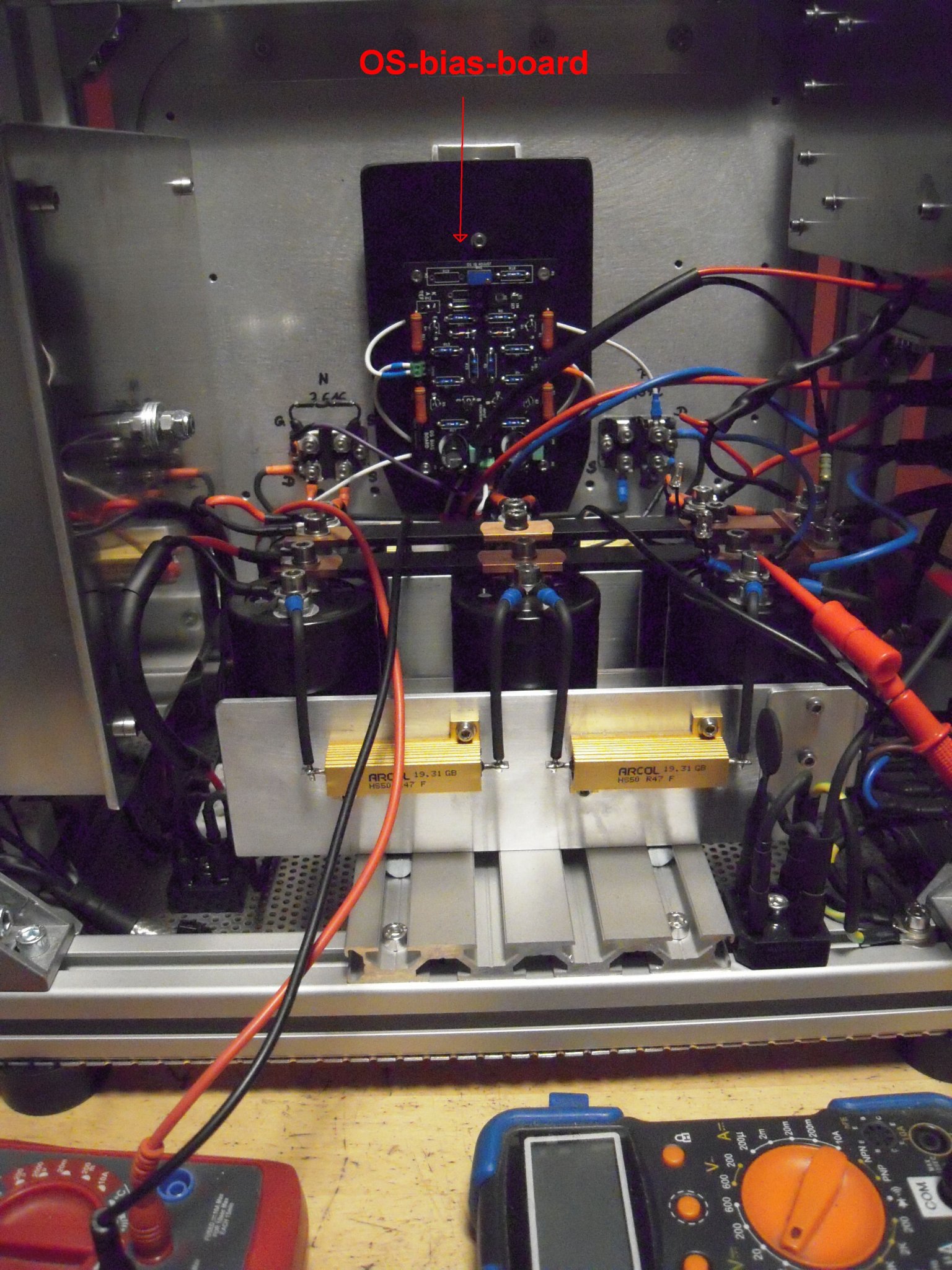

Hello ZenMod,
I think it is solved. I have made my own bias-boards. The circuit is very close to your Babelfish XA252-
OS-bias-circuit. I have used ZETEX NPN and PNP for the Wilson-current mirrors. I also had to adjust
some resistor values. I have to say - I copied from you! Offset is at the moment around 5 - 10mV after 30 minutes. At startup larger. Will see what the speakers will say at switching on? - Oooomph![redhot :redhot: :redhot:](https://files.diyaudio.com/forums/images/smilies/redhot.gif)

if DC ofset is good in temp. equilibrium and up to 500mV at sartup, and going fast to zero with time, nothing to worry about
XA252 is having FE serving also as servo circuit, while - as I understood you , you don't have that style of FE
if picky, you can include servo there

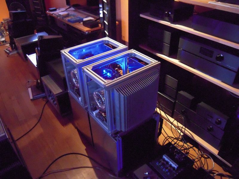

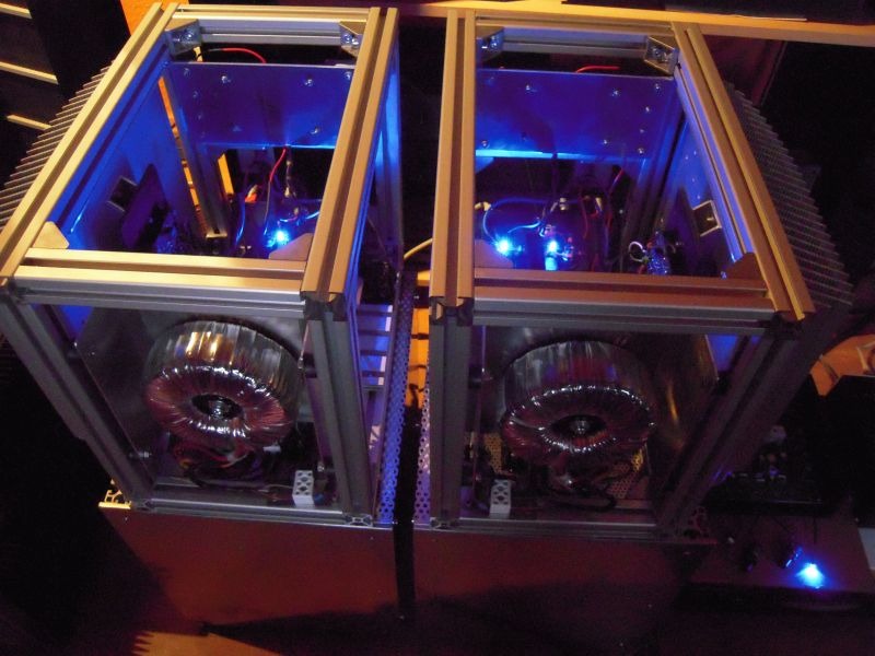

Hello sound-gourmets,
Dirk is very happy!
The IXYS-Mosfet-monoblocks are up and running.
I am listening to music out of this aluminum-excess.

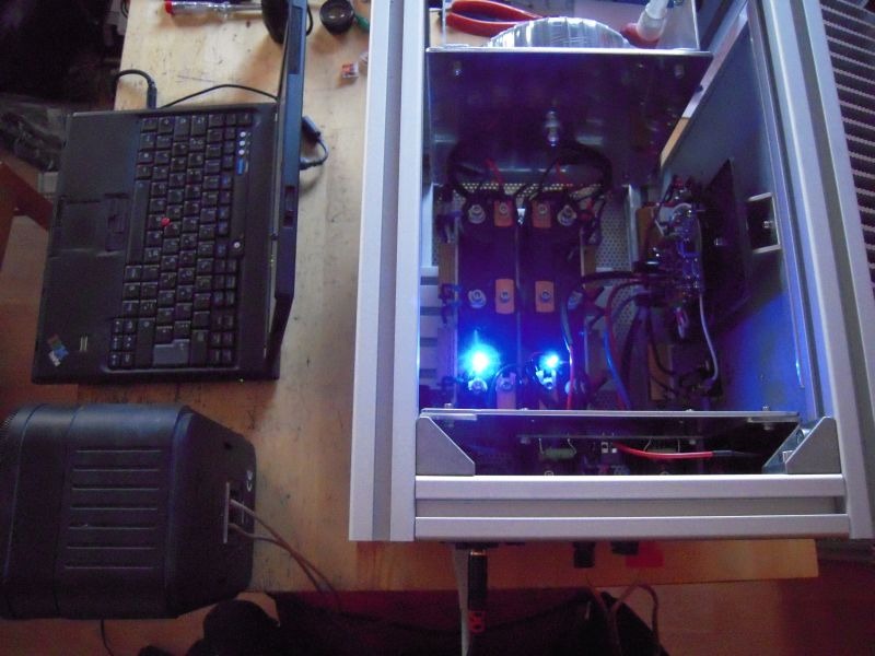

Hello ZenMod,
DCoffset at speakerout is at switch on around 150-200mV, but immediately goes down to around
40-50mV offset. After warm up (min. 30 min.) it is anywhere inbetween 5-20mV.
railvoltages are +-31.4 V DC unloaded and +-28.9 V DC loaded. Ripple voltage at the PSU was 0.4mV
unloaded and is now with 2.67 A of bias at around 18 - 20 mV AC.
Temperature at heatsinks is around 38° - 40° C.
No nasty blops. I am listening at the moment in the listening room...
ACP+ as preamp and those two 'big blocks' behind.
