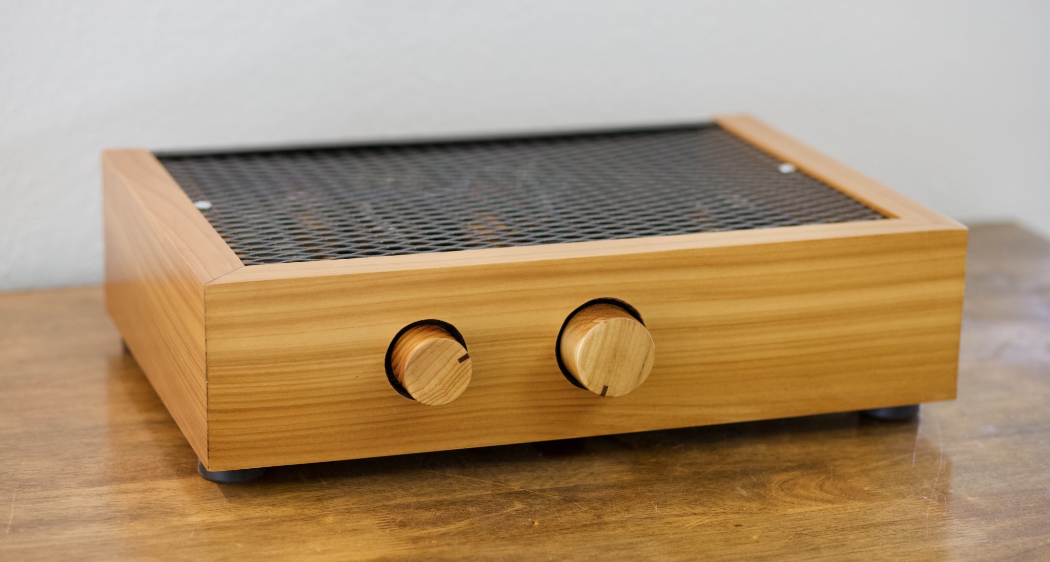

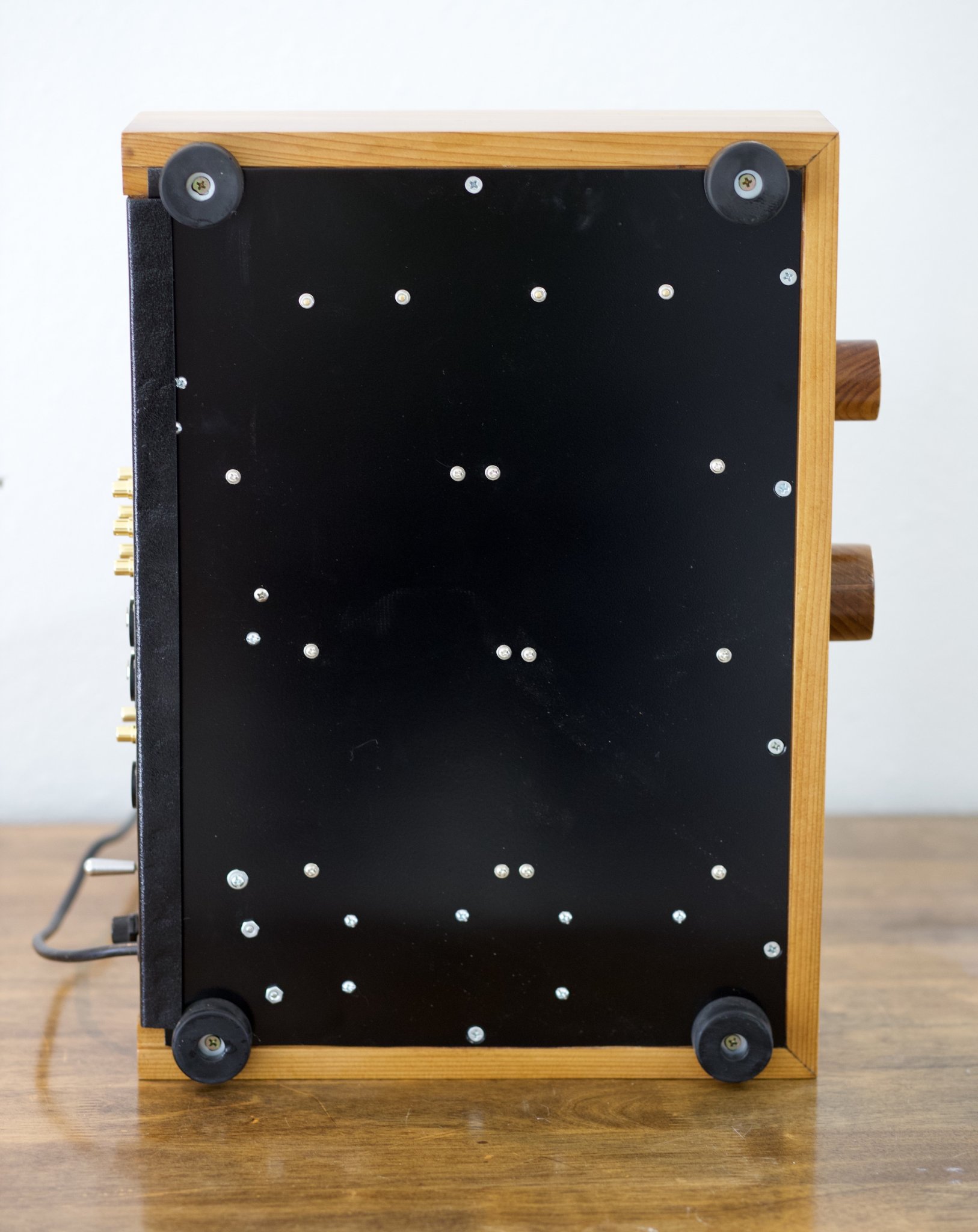

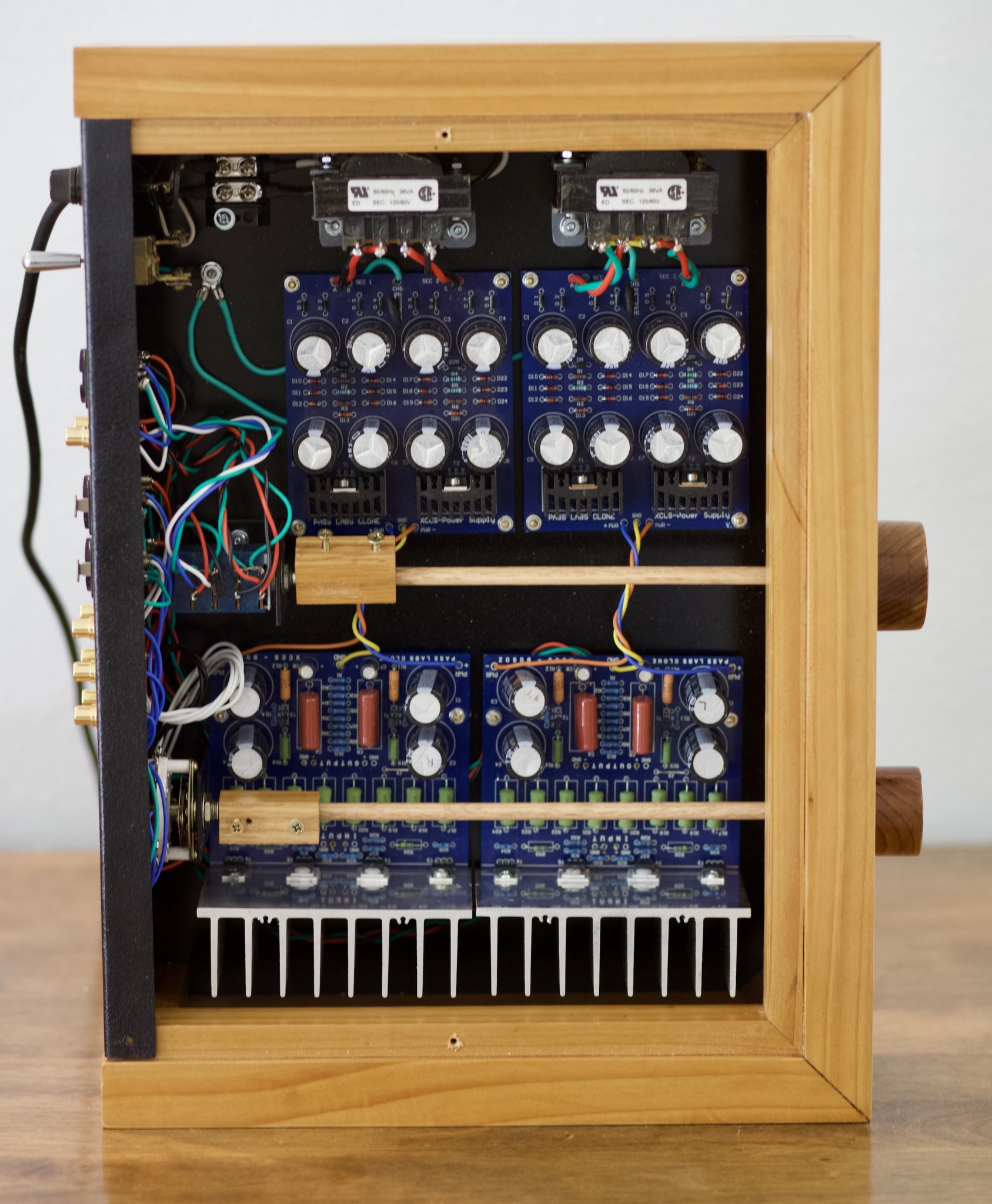

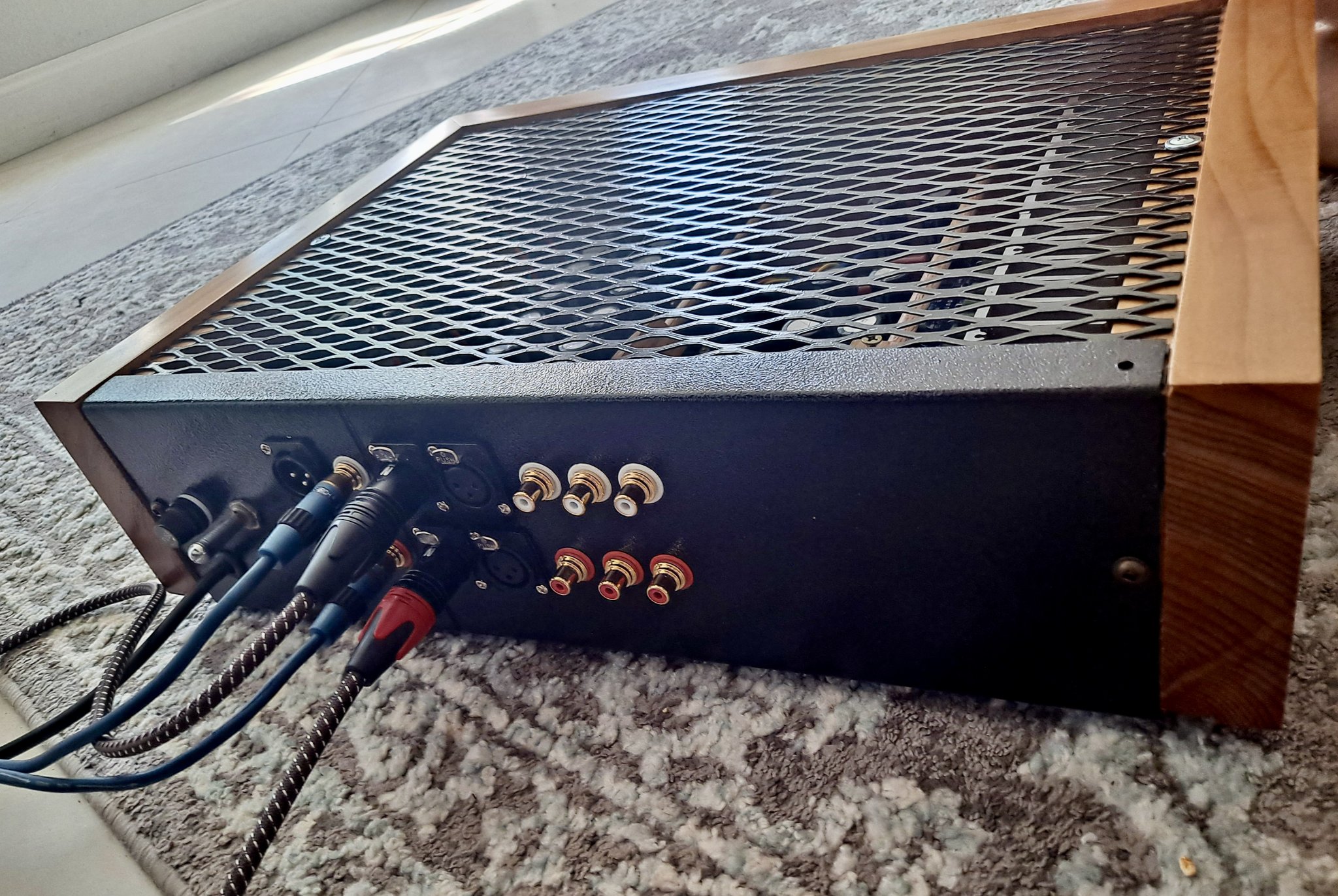

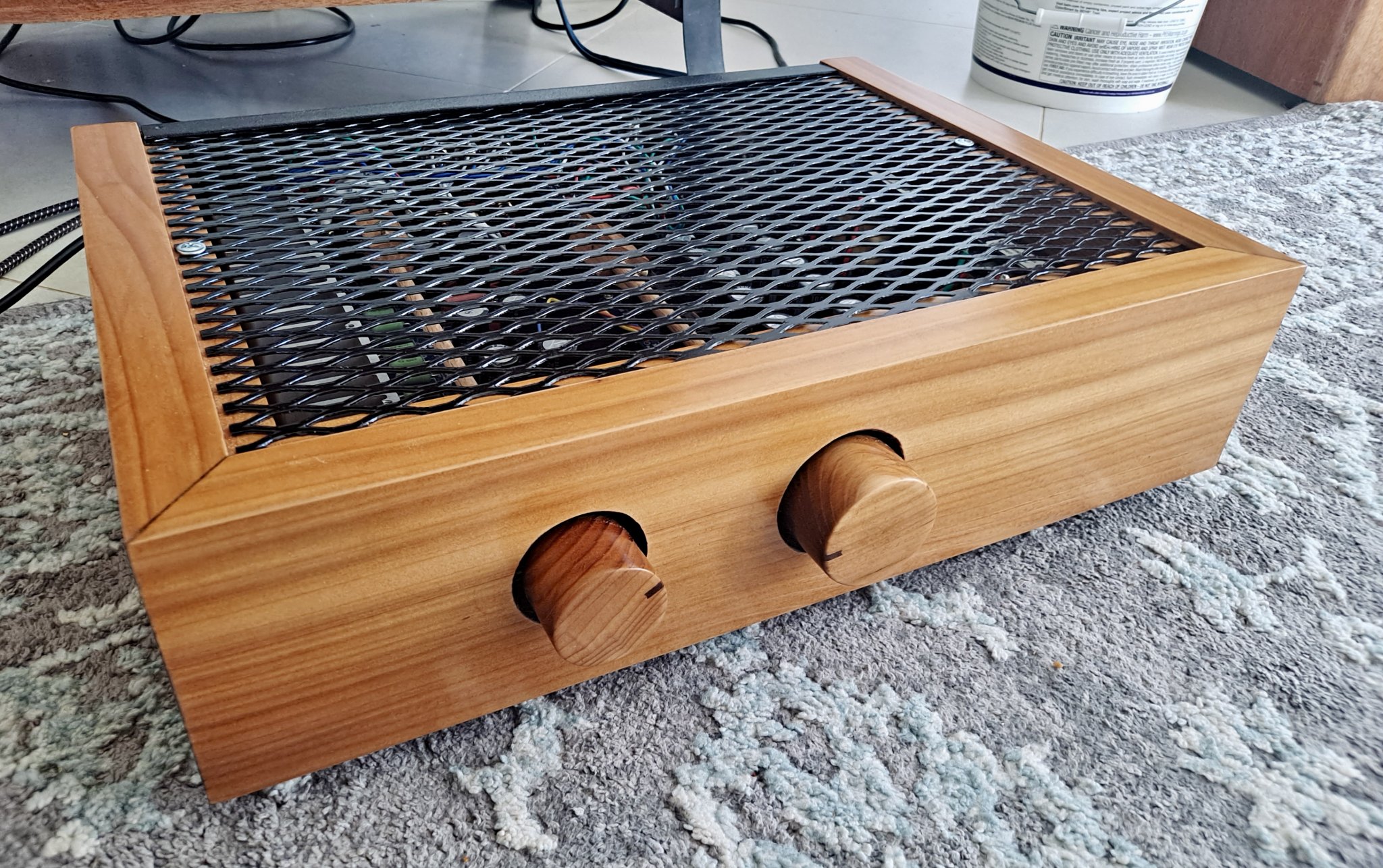

I just finished (still need to hook up the power switch) this BOSOZ. I bought the boards populated and non-functioning on eBay and figured out the little issues. New active devices, a couple of resistors bigger heatsinks. 16 gauge steel sheet from Lowes coated in Rustoleum enamel SG paint for the bottom, Duratex on the back then coated with the Rustoleum enamel SG to match.
The wood is milled from a large piece of Cedar that I pulled out of the trash. Oak dowels are made from a cabinet door pulled from the trash, pointers on the knobs are mahogany from an old book case off the road. Power switch is from an old 40's sailboat. 16 gauge steel sheet from Lowes coated in Rustoleum enamel SG paint for the bottom, Duratex on the back then coated with the Rustoleum enamel SG to match.
I made some mistakes on the boards. They are not the high quality that the DIYaudio boards. Lifting components and old wires off of the board lead to a couple botched pads and traces. I did a couple of point to point repairs. Nothing significant though.
This preamp sounds fantastic. Very dynamic and detailed. Good imaging. I am going to listen to it for a few days then rotate my BA2018 in and see what I think.

I feel like I am hearing new things that I didn't hear with the BA2018 but I always seem to think that when I put a new piece of equipment in. I will say that is is a very good sounding preamp. The presentation of the sound is quite different from the BA2018 and with that I am quite happy with it. I like variety. I Emailed KK-Pcb.net about the build plans and after a couple of weeks so I think they may still sell the PCBs.
I will say that having an arsenal of preamps is a nice way change the way your system sounds.
