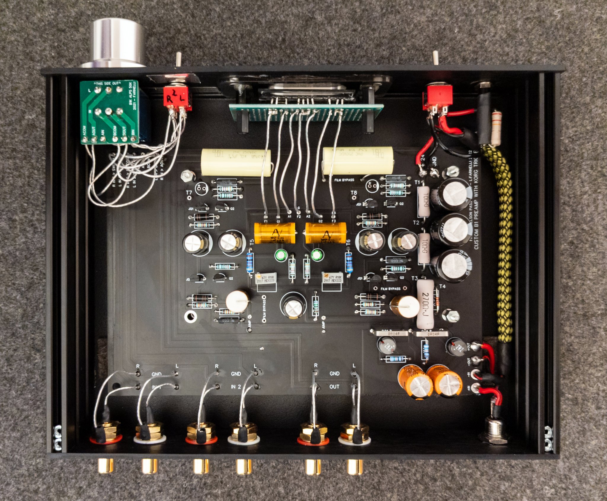

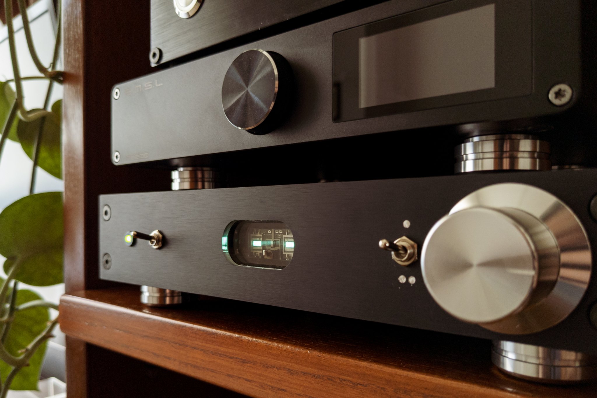

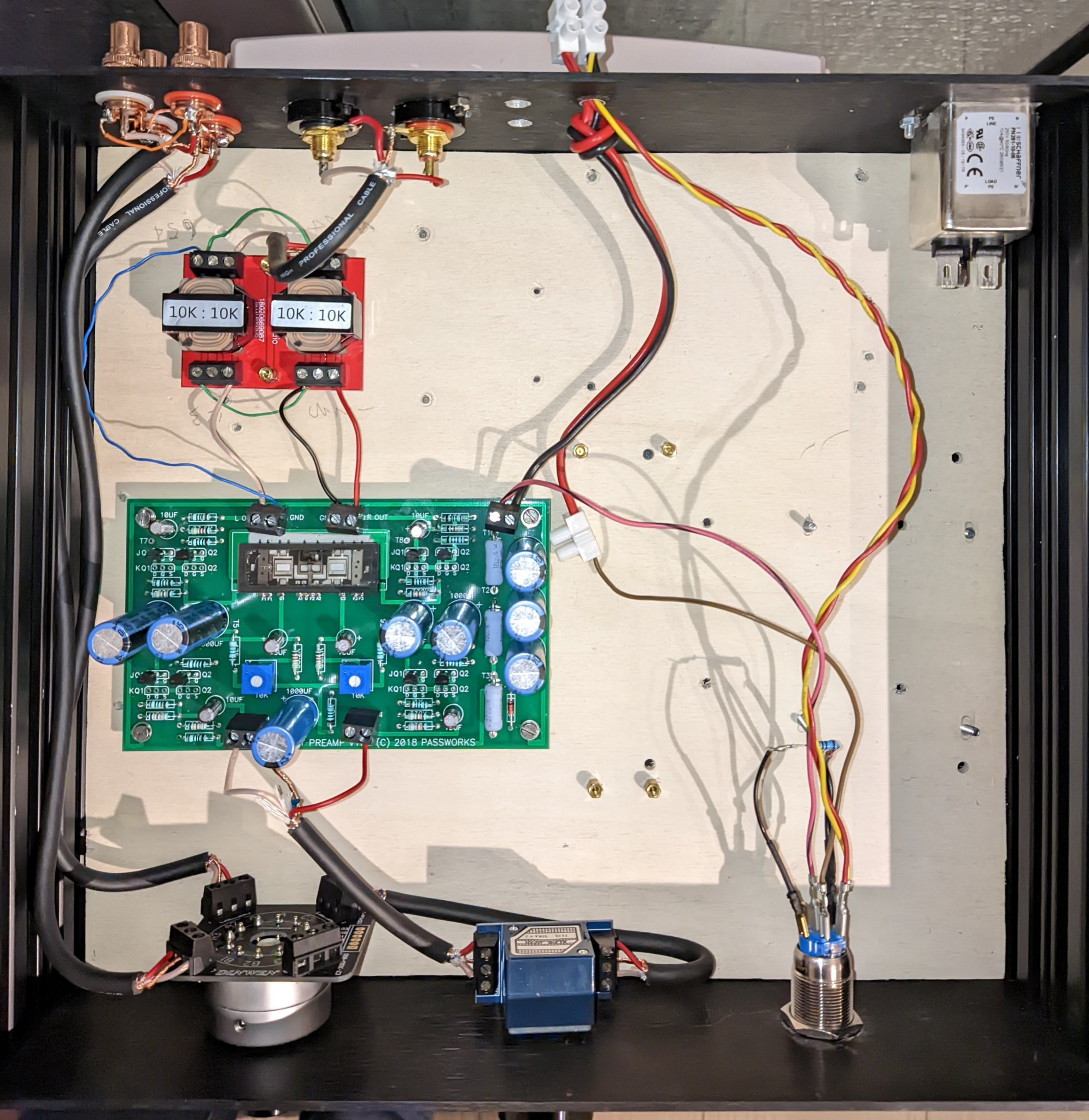

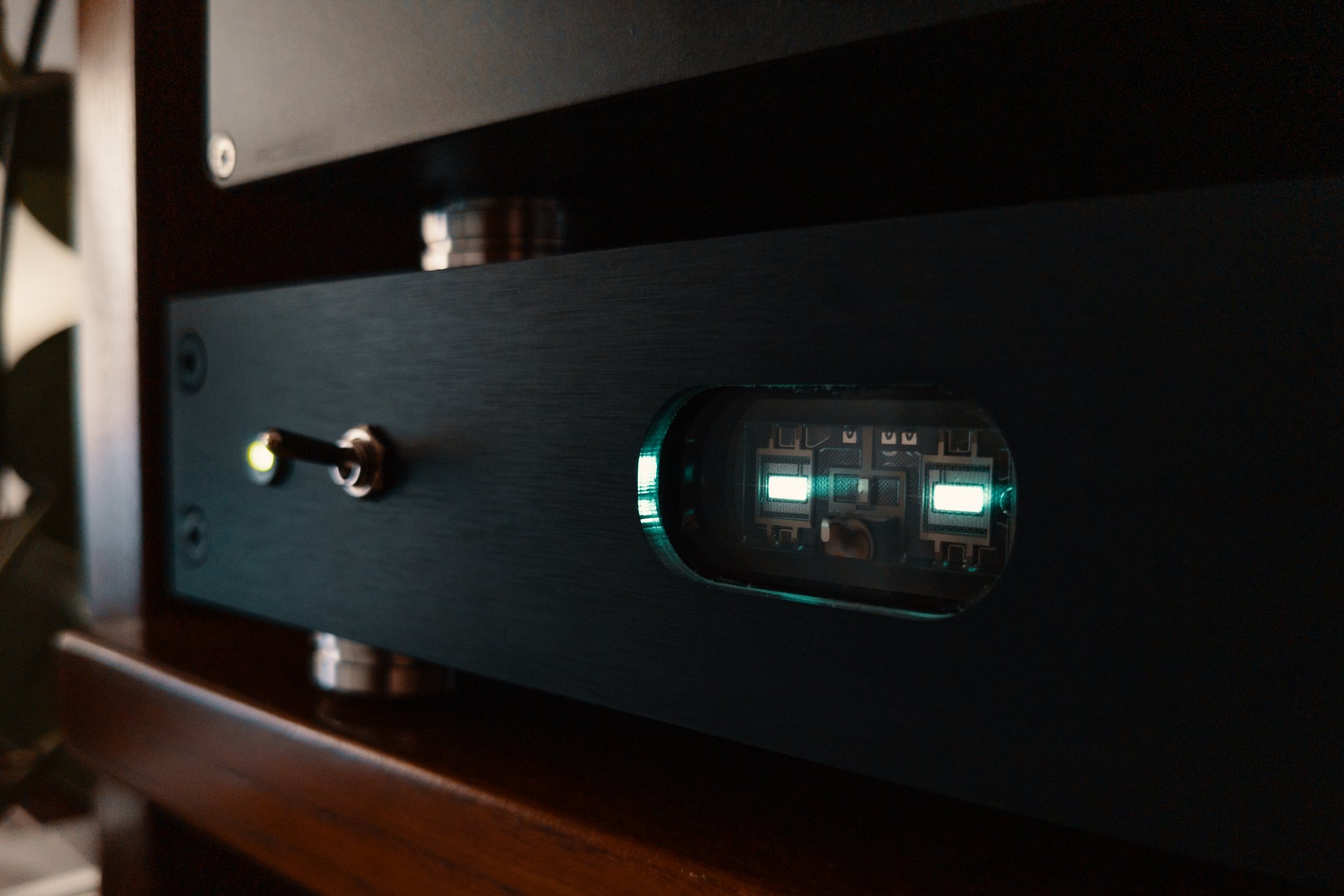

Just finished putting together my second and probably final iteration/clone of a B1 with Korg Triode. As I’m new to the hobby, the first one was a chance for me to learn how to match JFETs and this second one was a chance to play with poly caps, wirewound resistors and to “make” a slightly custom PCB. In this final version I’m using the JFETs matched by Mr. Pass and provided with the DIY Audio Store B1K kit (which took a long long time to arrive, that’s why back in December I made a version using my own matched transistors). I kinda squeezed in a loosely inspired (read=probably wrong adaptation) of Mark Johnson’s inline DC filter. This forum is a gem, the amount of knowledge and ideas available at a fingertip is huge, but so bloody dangerous to my wallet (I’m already thinking of what to build next)
Now, the preamp sounds excellent in my budget-friendly system (Elac, SMSL, Pro-Ject) and it’s not terribly microphonic. It’s fairly silent and it really shines in soundstage when set between 9.2V-9.7V. The “colour” it adds to the music is there but subtle and I don’t see myself getting tired of it anytime soon. As an added bonus, it’s not yet set my apartment on fire. But I’m also sure I made a lot of mistakes and unorthodox/messy/uninformed choices (in that case, don‘t go gentle and please absolutely tell me off! 😊)
Hello seipersei,
a very nice B1 Nutube- preamp! I am sure it sounds as good as it looks.
Enjoy the sound! 🎼 🎶
Cheers
Dirk

Ahó, ammazza seipersei, il tuo Nutube é na figata!
Did you design that pcb by yourself? Congrats for your awesome creation!
Gaetano

Grazie Gaetano and thank you all!Ahó, ammazza seipersei, il tuo Nutube é na figata!
Gaetano
I’m not sure I ”designed” it, but yes I used EasyEDA to pretty much clone the original pcb that I bought from the store. But I also wanted to try to make some space for the poly caps (which also meant removing the unused holes for the Toshiba JFETs), simplify the wiring for the NuTube and move it slightly forward, simplify the input and output wiring as much as possible by running traces on the pcb instead of using wires and finally I was curious to try Mark Johnson’s inline DC filter (although I used different and probably worse components compared to his original BOM).

In EasyEDA there is a function that lets you search and place the footprint for the Korg NuTube, which was quite helpful@ seipersei
how did you obtain/create the exact footprint of the Nutube device?
I see a lot of interesting things though, and I'm sure it sounds fantastic. Are those transformers on the output to reverse the phase?@seipersei
Lol, il mio é molto più tarocco! It seems much more homemade than yours!
Also, I've been leisurely scrolling through this thread and some stuff is jaw-dropping inspiring 😵 It convinced me that my next build must be an amp by Nelson Pass
To be honest, they are there because in a preceding version, they allowed me to obtain a balanced output to drive a class d Hypex ucd700 amp. Then I built the Honey Badger amp, which is single ended, but I kept them cause I made a comparison with and without and I like their sound.Are those transformers on the output to reverse the phase?

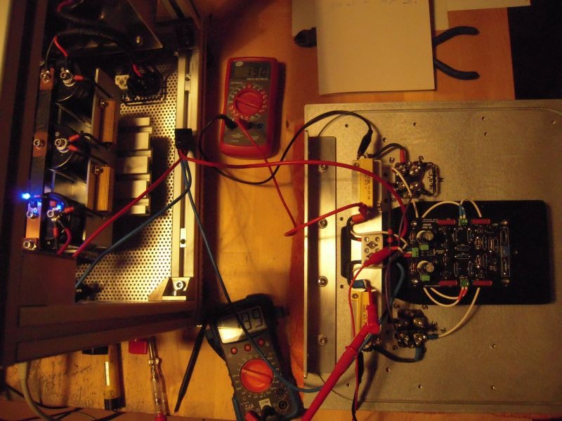

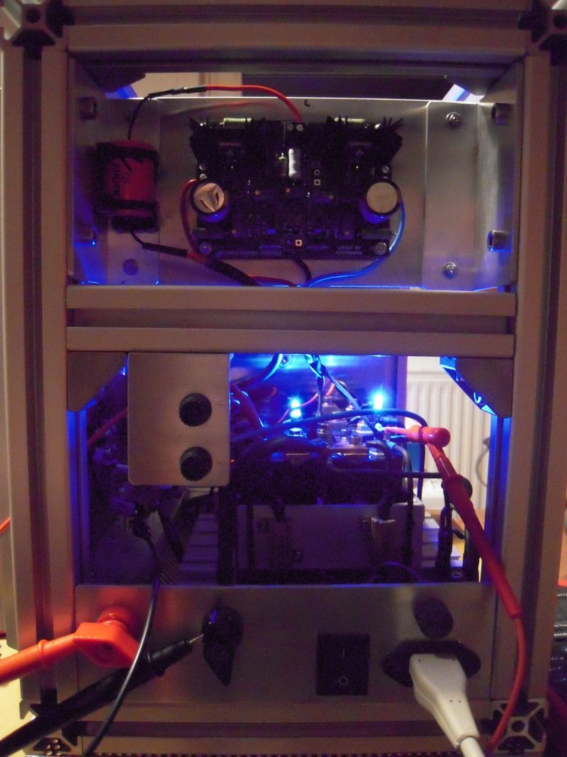

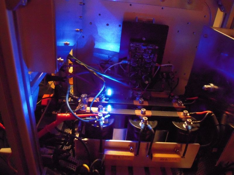

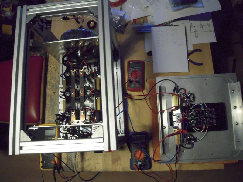

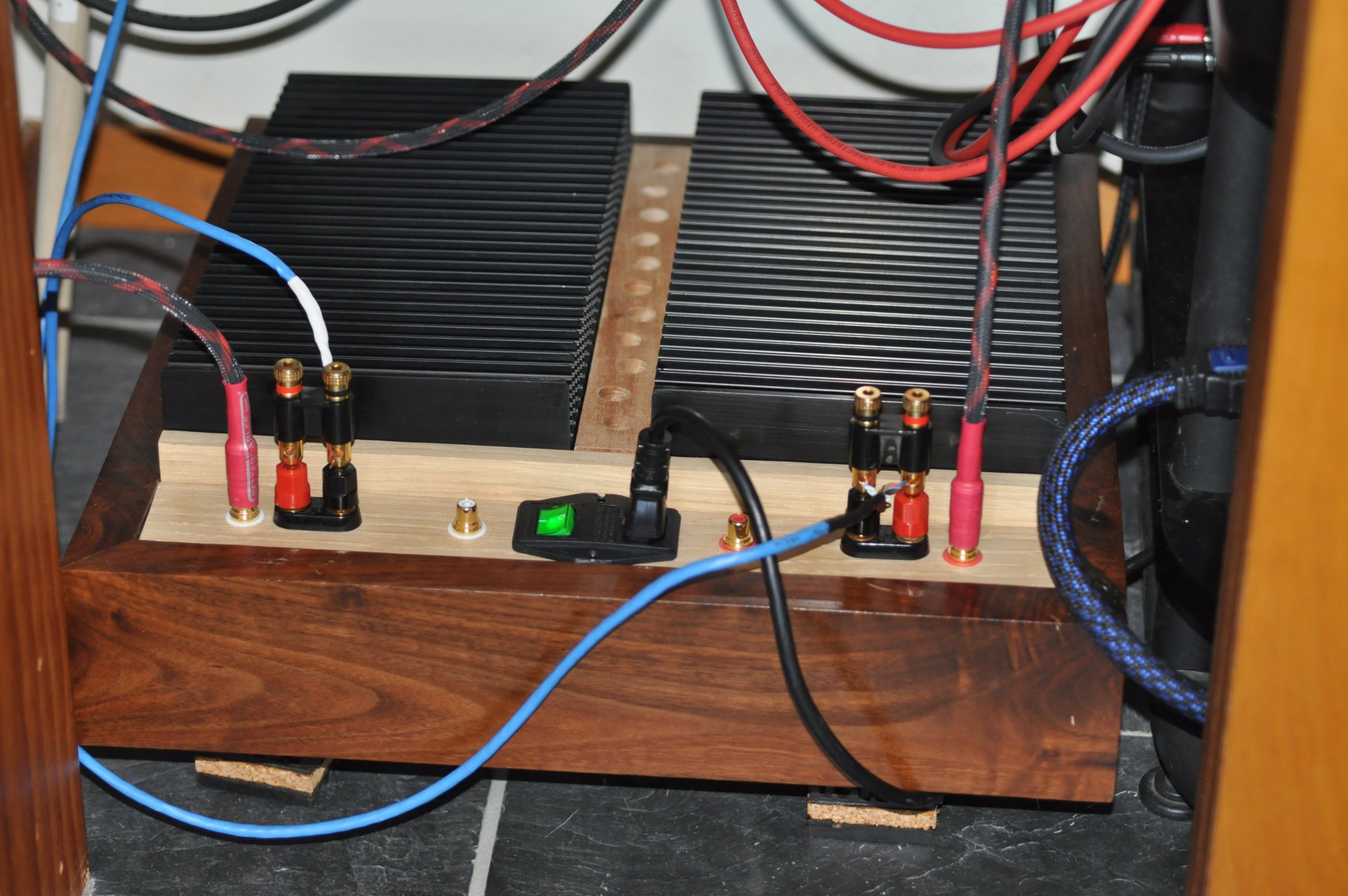

Hello out there,
I fired up my first Monoblock with IXYS-Mosfets this evening. No fire till now!
I have biased up to 1.7 A. Mosfets at around 40°C after 30 minutes. So, let's go higher...
I think this is not enough bias for FAB-membership?
Only large DC-offset at speakerout. Have to check the next few days.
Prestage is cascoded BA-3.
Good night!
Dirk 😴
