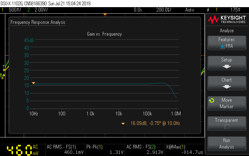

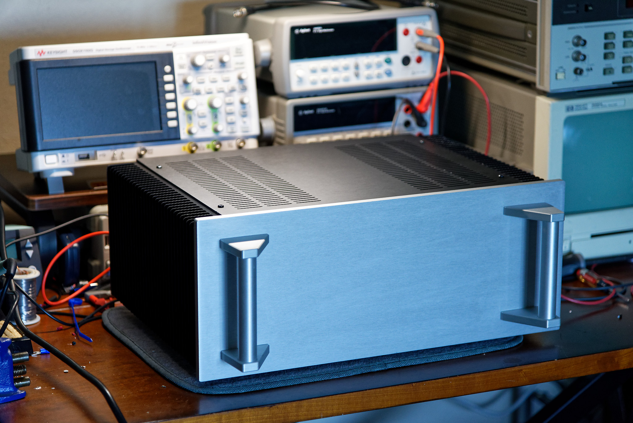

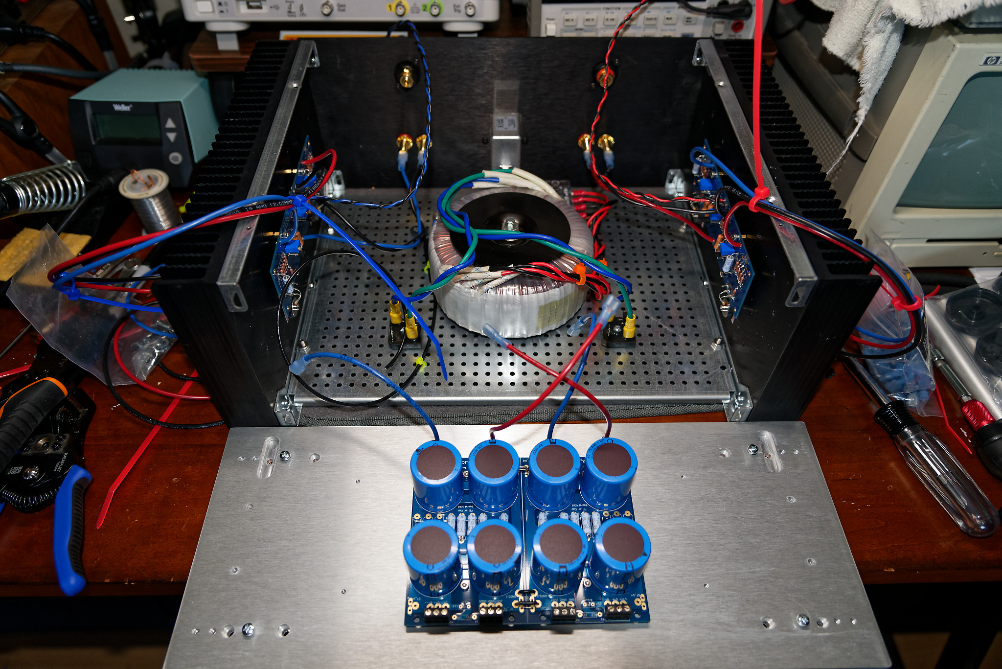

I built this amp to go between an Audio Research LS3 and a pair of Altec Model 19s. The LS3 has way more gain than it needs (18dB) and the Model 19s can play more than loud enough with little power (99dB/watt). It seemed like the 15dB of gain and 25watts of power would not be a problem. So far they've been a good match.
I pretty much went with the build guides from 6L6 and JojoD818 which is why it looks pretty much like your standard build I guess. However following the guides seemed the best way of assuring the build would be successful. I'm very happy with the results. Despite being only 25 watts it drives the 19s with more authority than the Dynaco Mark III clones I built for them last year and those measured out at just over 60 watts each.

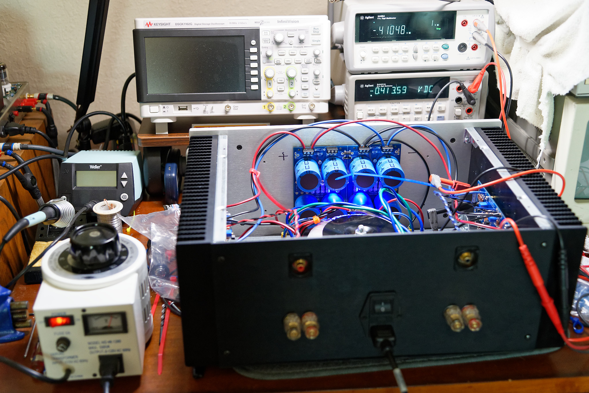

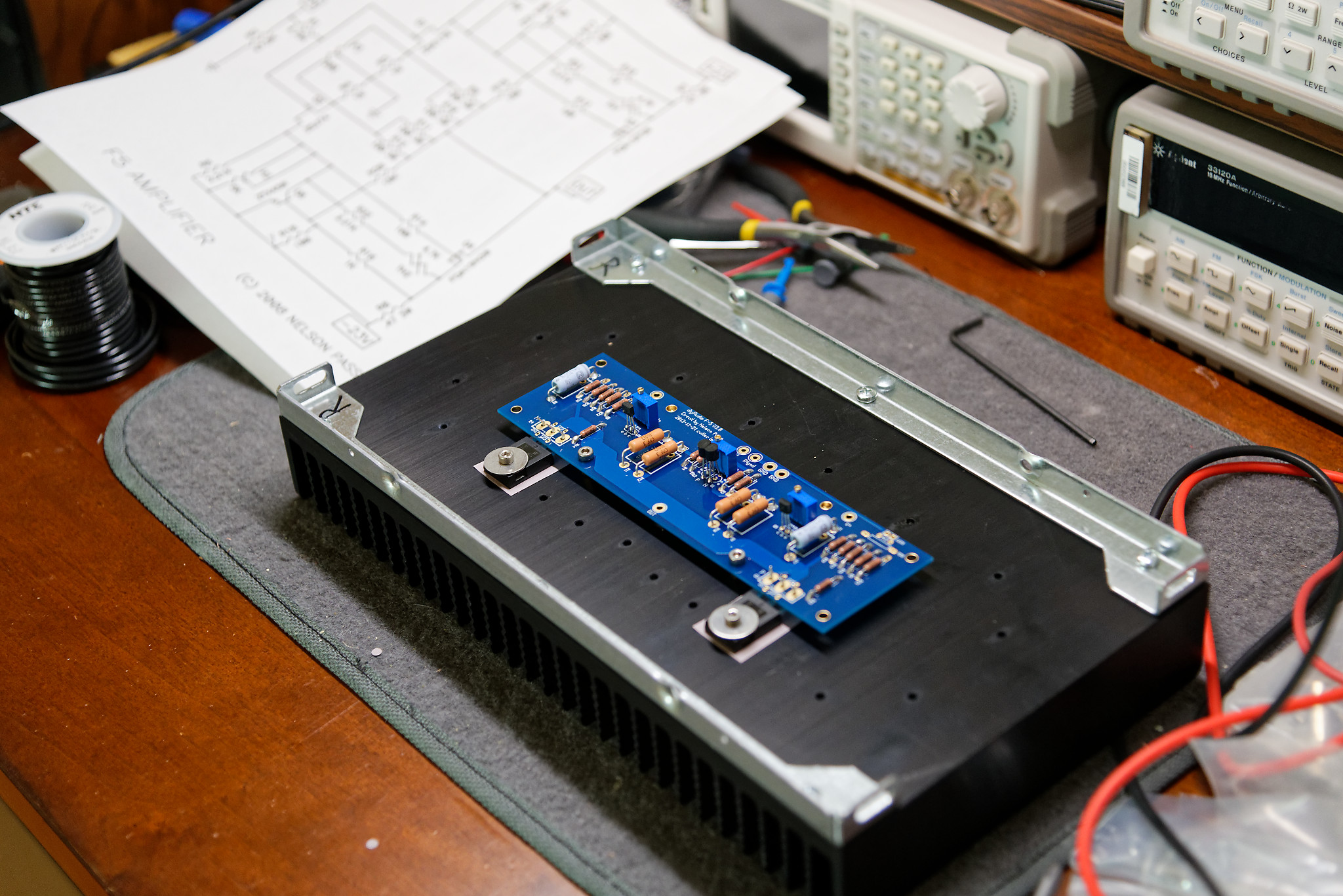

The boards and F5 parts kits came from the DIY Audio Store. The jfets came from Punkydawg on ebay. They were perfectly matched per my DCA75 and the amp biased up easily, no fuss at all. The chassis is the Deluxe 4U. From the temperatures I'm seeing anything smaller would probably need a fan. The transformer is the Antek 500VA model. It took a lot of space so instead of cramming everything into the bottom I mounted the cap board on the front. I ran the DC wires out the top and laced them down so they wouldn't rub against the lid.

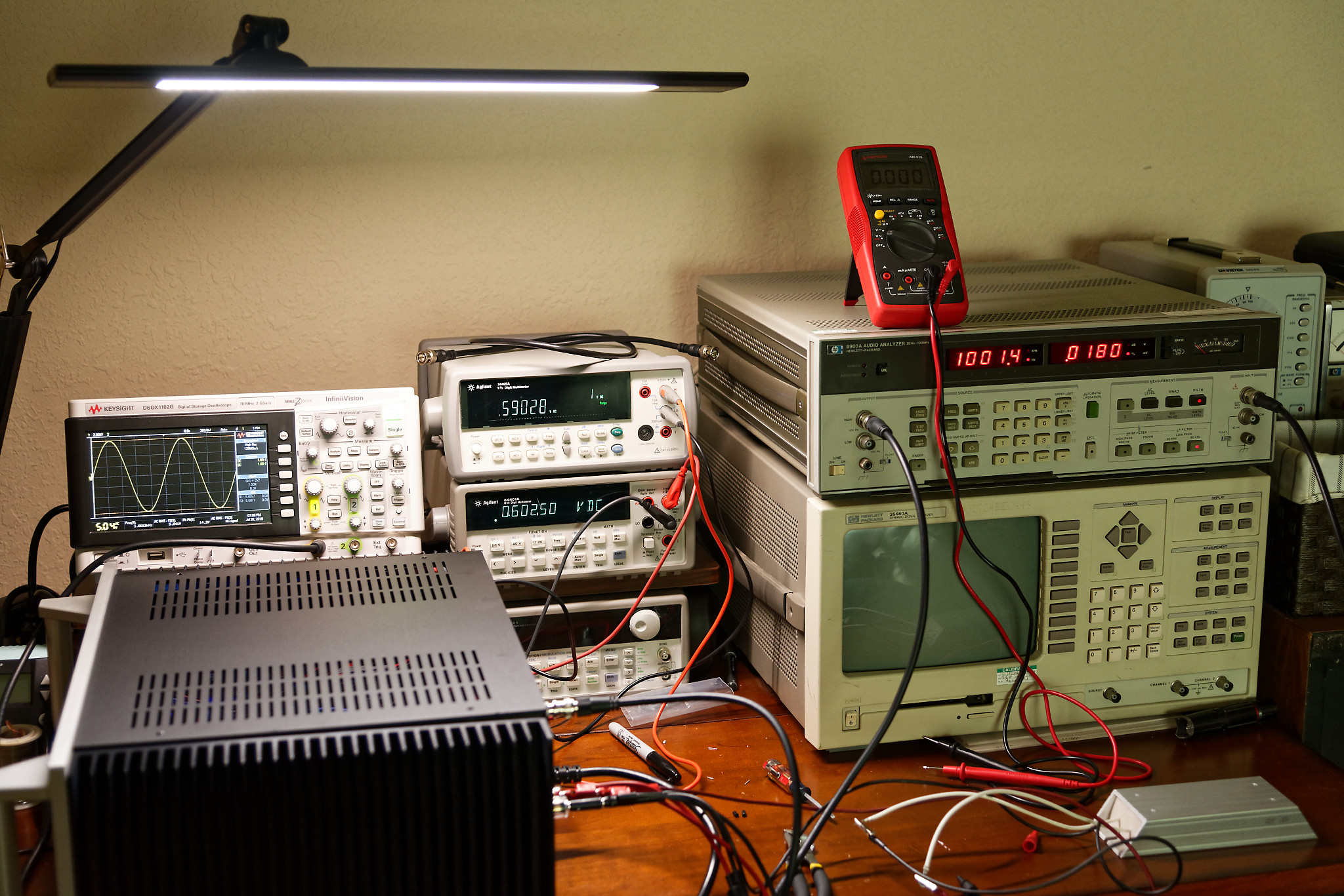

While running the amp in on the bench I did do some testing to make sure I wasn't missing anything. Gain came out to 16dB and matched on both channels. THD+N 1watt/8ohms measured around 0.0089% and S/N for that same condition 85dB in one channel and 86dB in the other. That actually probably represents my test setup more than the amp since redressing and moving cables around could change the result by 2 to 4 dB. BW was a surprise with a -3dB point around 520KHz with no ringing on square waves and stable operation so far.
I think it's a credit to the design that so many people in so many ways can build something that performs that well that easily over and over again. You can see from the photos there is nothing exotic about it at all.

Great looking amp and a nice bench as well! Congrats on your new amp!

It is nice, I like it .Wow - that's a packed chassis! Nicely executed! How do you like the sound?
